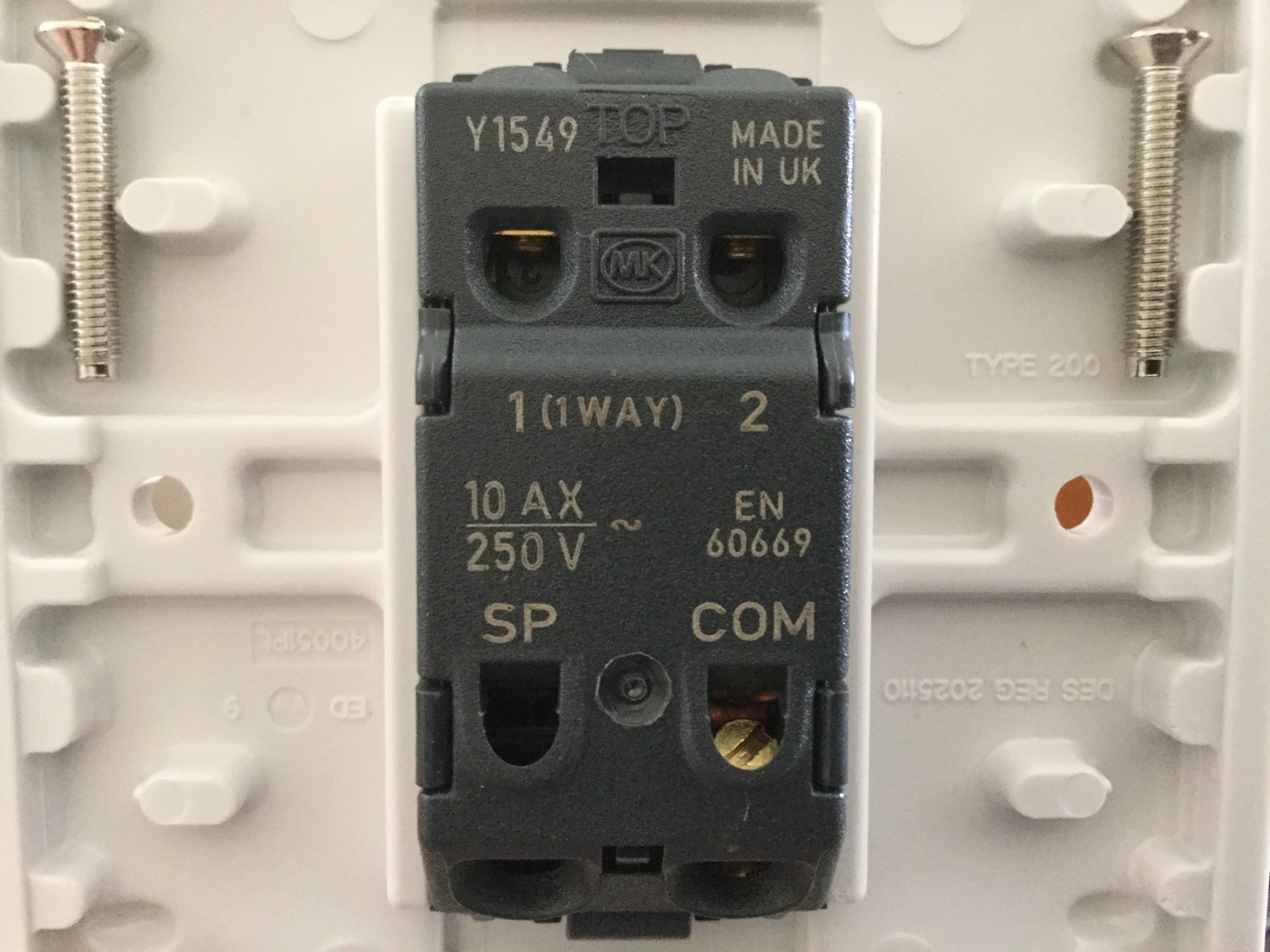

So I'm wondering where the earth goes, SP stands for, and the 1 and 2. Basically I only know for certain that the common is the permanent live in.
The wiring i looked up on the internet is totally different. They have L1 and L2. I simply was instructed to wire the neutral (switched live) to L1.
What is the switched live on this plate? Is it SP or 1? I'm guessing tha thye don't think the earth is necessary of that it should be wired in the dry ling box...
Either to a terminal in a metal back box or a separate piece of connector block to keep it isolated.
SP stands for,
SPare ?
There is no terminal (brass connector) in it.
and the 1 and 2.
Can you see a similarity?
It is in your case, but not always.
Common means it connects to 1 or 2.
There is no terminal in SP.
The switched live may be connected to either 1 or 2 - depending on which position you want the switch rocker to be when on or off.
You cannot earth plastic.
