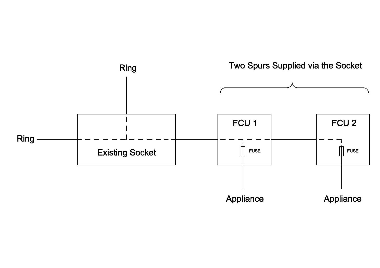

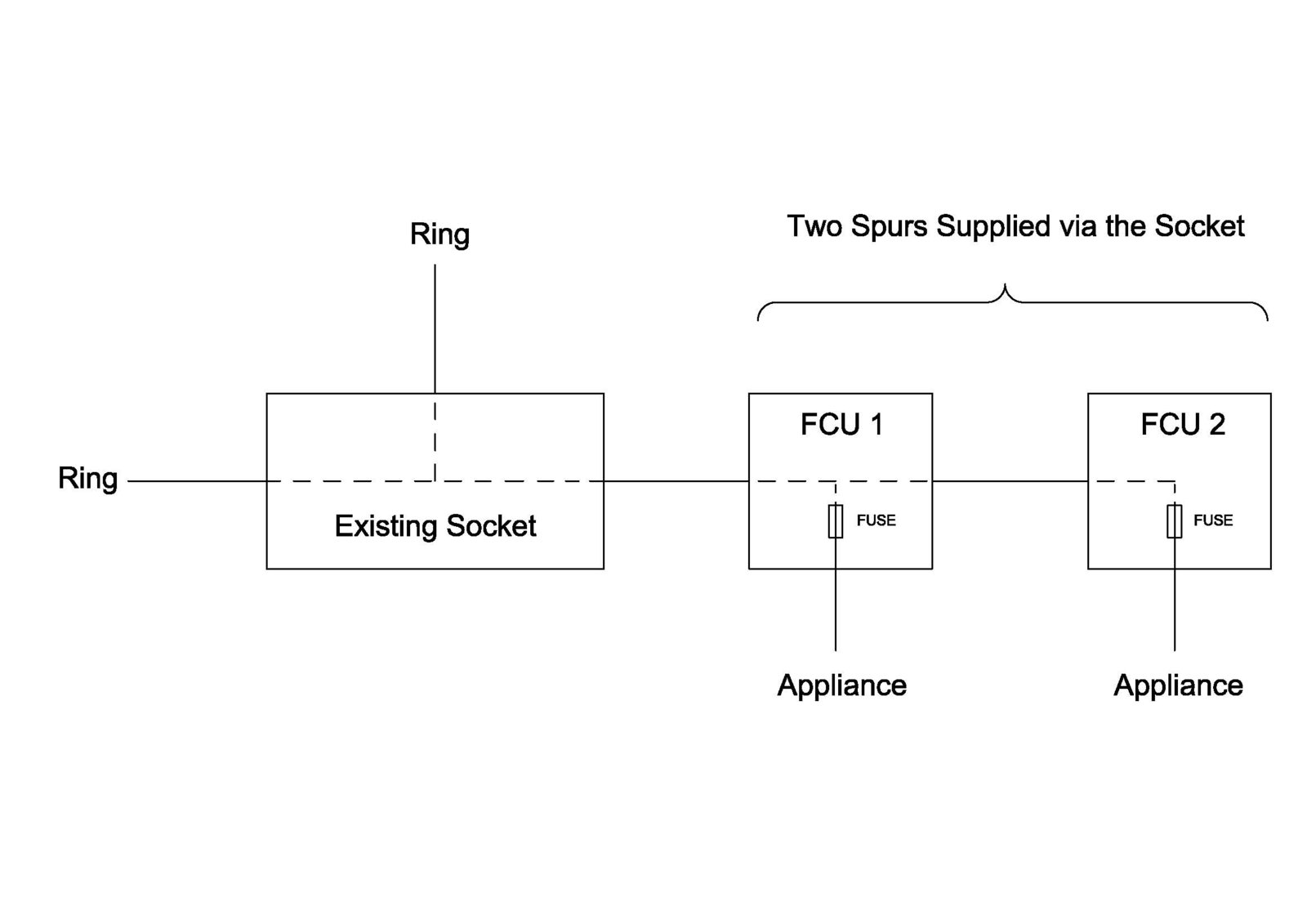

No - you clearly said that you can't have 2 spurs from one socket:
Indeed I did. You can't have 2 spurs that originate from the same socket like this.
If the post is read in context it is clarified by:

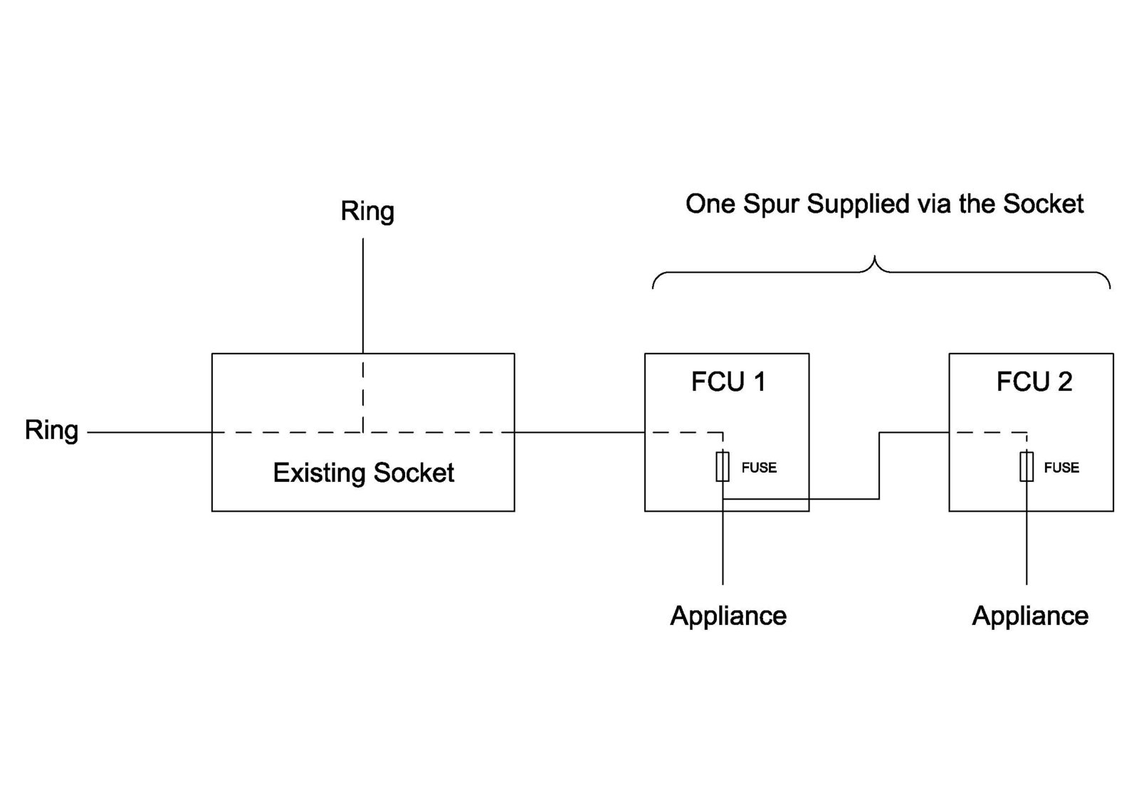

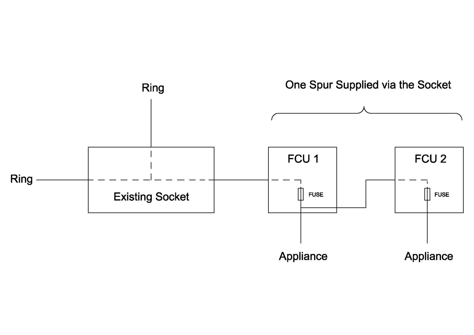

if you want to add it to the outgoing (fused) side of the existing fused spur, then you can as then both will still count as one spur.
Like this
Trust all is clear now.
It is clear, but there is a difference. In my diagram both FCU's are supplied via the same single cable originating from the socket. In your diagram each spur has its own cable directly from the ring.
