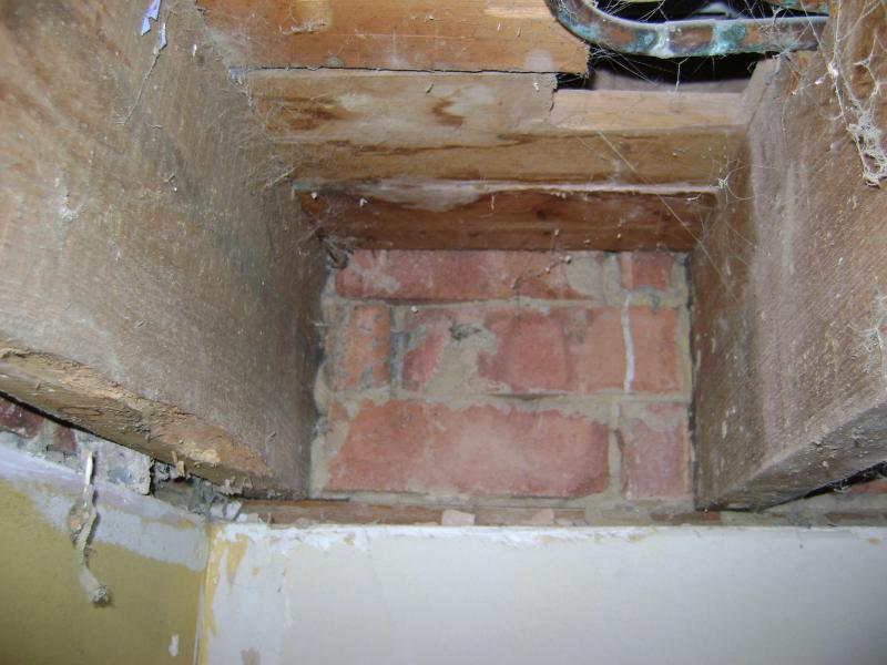

I've attached a really bad photo below the joist to the left is the problem one, although problem only really visible at end of joist.
View media item 65050

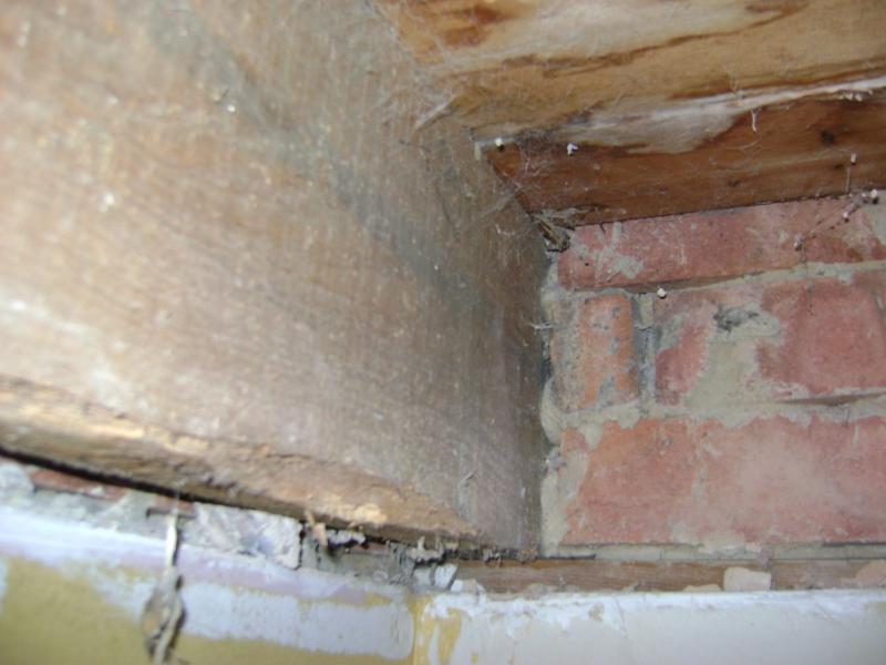

OK here's a couple of better photo's. The main bathroom is directly above above this section. When the ceiling was taken down there was some evidence of water damage and the floor boards seem to have some water marks, but seem pretty solid.
The joist on the left is the joist that had a soft end when viewed from outside, via hole knocked in outer skin.
None of the joists seem in bad condition, the left one seems to have a few beetle holes, but doesn't seem active since there was no obvious frass on the plasterboard ceiling that was taken down.
Probe the joist tails as they enter the brickwork pockets - use a thin screwdriver.
Probe the wood plate that the joists are sitting on.
Come further back, say, 300mm - 400mm and probe again.
If both tails are rotted then research cutting joists, propping and bolting-on.
The plate both tails are sitting on could be a built-in wall plate ( if its built-in its suspect), or the top plate of studwork? Either way, it req's further examination. Go along that wall probing everything wood, as above.

The whole joist is pretty solid, the only exception is the bit about 100mm from the end, which some has broken away and there is some evidence of wood worm, this is a little soft about 5mm pentration witch small screw driver.
The plate is built-in and there is a DPM (and slate in a couple of places) between the wooden plate and the joist.
All the web like stuff seems to be normal spiders web, no fungal growths that I can see.
Wonder if the issue on end of joists is due to lack of air since the cavity has been filled after the house was built.
I was thinking adding a new joist next to it just in case would be a good idea while there was no ceiling, but I'm tempted to leave it for now and then simply replace the whole joist (and some of the damaged floor boards) when we do the bathroom upstairs next year.
