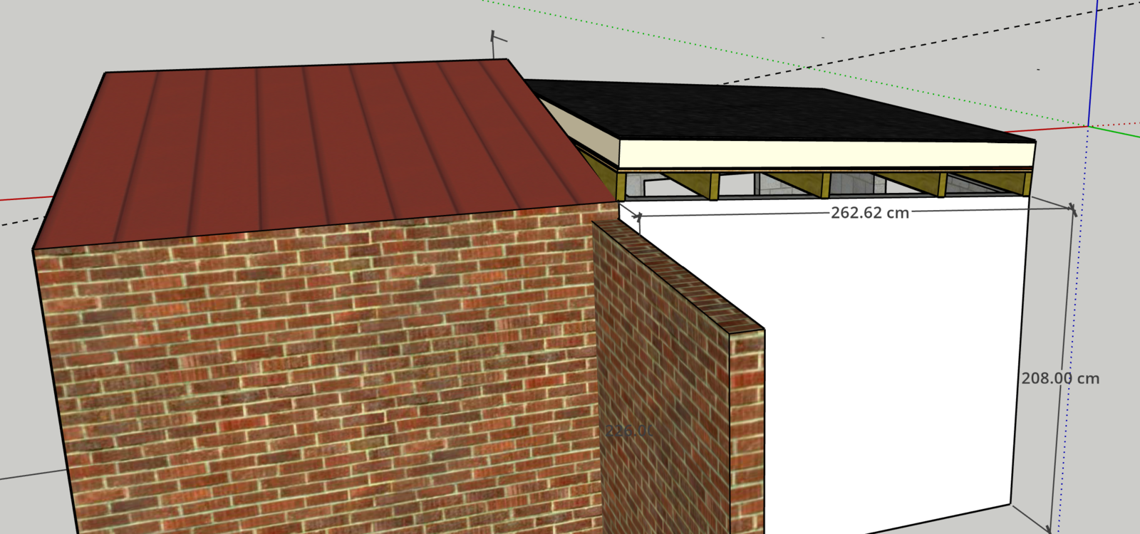

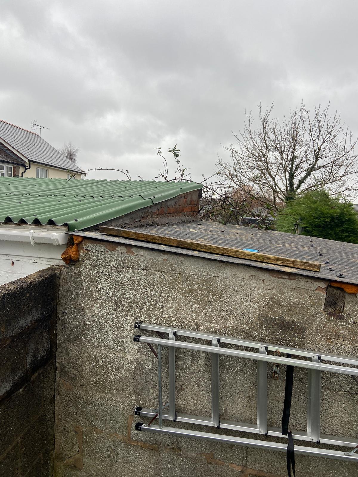

Hi, first time poster but regular 'searcher'!
I am looking to turn an old single block (small) building into an office. The current roof is corrugated cement (containing chrysotile asbestos) and the back wall is also the garage wall of my neighbour (rear joist rests on the walls and is not fixed to the garage). I want to remove the current roof and add a 'flat' warm-roof; however, this will be next to my neighbour's (sloping corrugated bitumen) garage roof. I'm unsure if this is 'do-able' in order to maintain 'warm' and dry. We've just moved into the property so want to stay on our neighbour's 'good side'! I've attached a couple of pics of the current set up and a 'Sketchup' of my proposed idea. Any thoughts or advice (constructive!) are appreciated

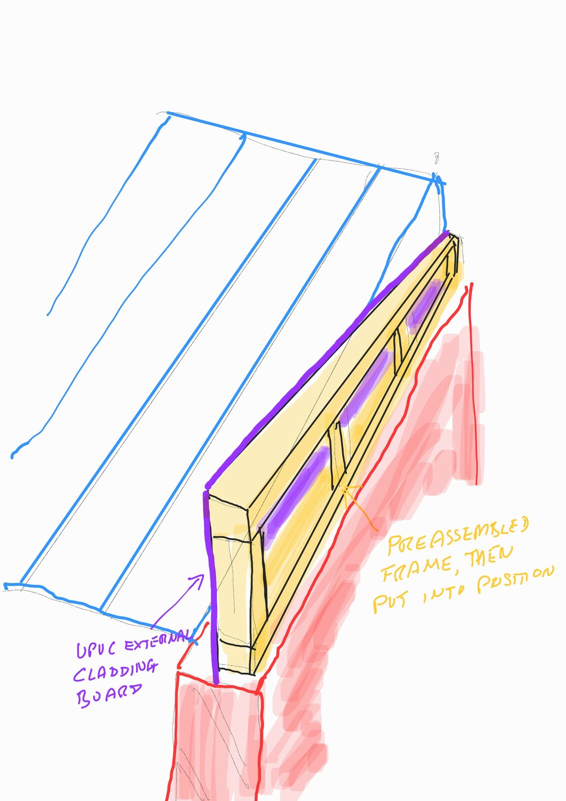

Make the party wall extention wall first on the ground, and then fit it in place. Make the frame and line the external face with a single piece of suitable deep uPVC board, fit this in place tight up to the pitched roof, and then flash the neighbours roof, and the bit of wall that will be above your new roof level.
Where the pitched roof intersects the flat roof will need careful detailing with flashing. Not difficult but needs care.
Don't forget the flat roof needs a fall, which does not appear to be on your sketch.
The rest of the roof is standard.

Firstly, thank you for taking the time to respond. Could you explain what you mean here (I'm easily confused!) "Make the party wall extention wall first on the ground, and then fit it in place"?
There is a slope already in place which is at right angles to the neighbour's garage.

Build the new wall first on the ground then fit it in position, as that is easier. It may need to be on a beam spanned front to back, or fixed to the party wall face, if it can't physically fit on top of the party wall. No need to adapt the neighbour's roof.
This is the principle, not the detail....

Daaamn sir you're good!
The garage roof (neighbour) is also corrugated which slightly overhangs where my roof will go so I might be able to 'utilise' that to aid the rainproofing. Hugely appreciate the time you took to send that Woody, many thanks; it's given me a lot more confidence.
