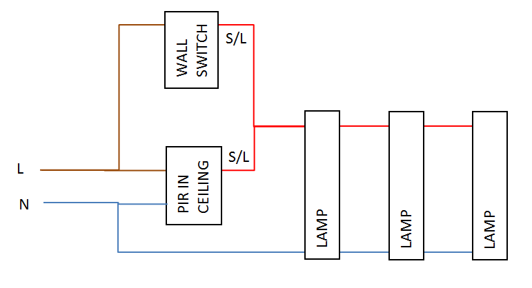

Did a search around but everyone asks a slightly different question so apologies if this has been answered before...
Wanting to add a ceiling PIR to a room in the house but keep existing wall switch to override the PIR if needed.
Will this diagram work to have either the PIR or switch (or both of course) turn on the lights?
Great thanks.
The PIR is above the switch, it is a single switch, so if the switch is on, light will be on, if the switch is off, it will be the PIR.
Reason I want the switch is it is a coat/shoes room so planning on having quite a short timeout on the PIR, but if for some reason someone was spending more than a few seconds in the room then they could flick the switch rather than remembering to move every few seconds!
Yes, that would work. But I'll bet you'll get annoyed not knowing if its the PIR or the switch that has control.
Does this room (or is it really a 'cupboard'?) have a door which is usually shut? If so, a door-operated switch might be less potentially annoying.

It is a room with a window and there is always some light outside. Door probably shut, but as you walk in the room, door shuts again = fire door.
PIR will be set to 30 seconds or more of no activity before switching off anyway.
Also, adding in a ceiling pir was easy as i have access to joist right now, running cables to door is more making good.

Fair enough. It would probably be just as easy for you to install a pull switch in the ceiling, but there would then be a risk of the light being left on (unless you had a 'repeater'light outside the door, such as I have just described).
Anyway, you probably didn't want us to be 'arguing' about what you're doing. As you have been told, your proposed wiring of the PIR would be fine!
