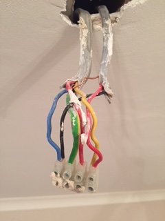

Hi,
I have a single ceiling rose in my dining room but would like to add 2 more so I have 3 pendant lights hanging down over a dining room table.
Can this be done?
At present I have;
1 cable = 3 core T&E. ( RED/BLUE/YELLOW/EARTH )
1 cable = 2 core T&E ( RED/BLACK/EARTH )
The blue from the 3 core and the black from the 2 core are in same terminal.
The yellow from 3 core and red from 2 core are in same terminal.
The red from the 3 core is in a terminal on its own
The earth's from both are in a terminal.
If this makes sense could you advise on what cable i'd need and to which terminal the new cable would need to be joined to.
Thanks in advance.

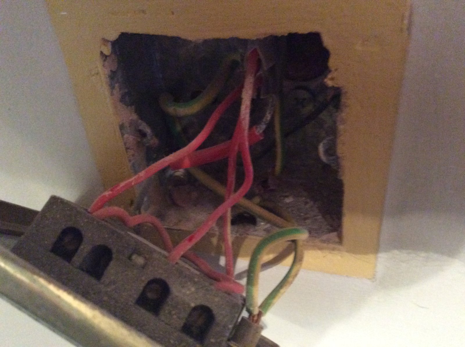

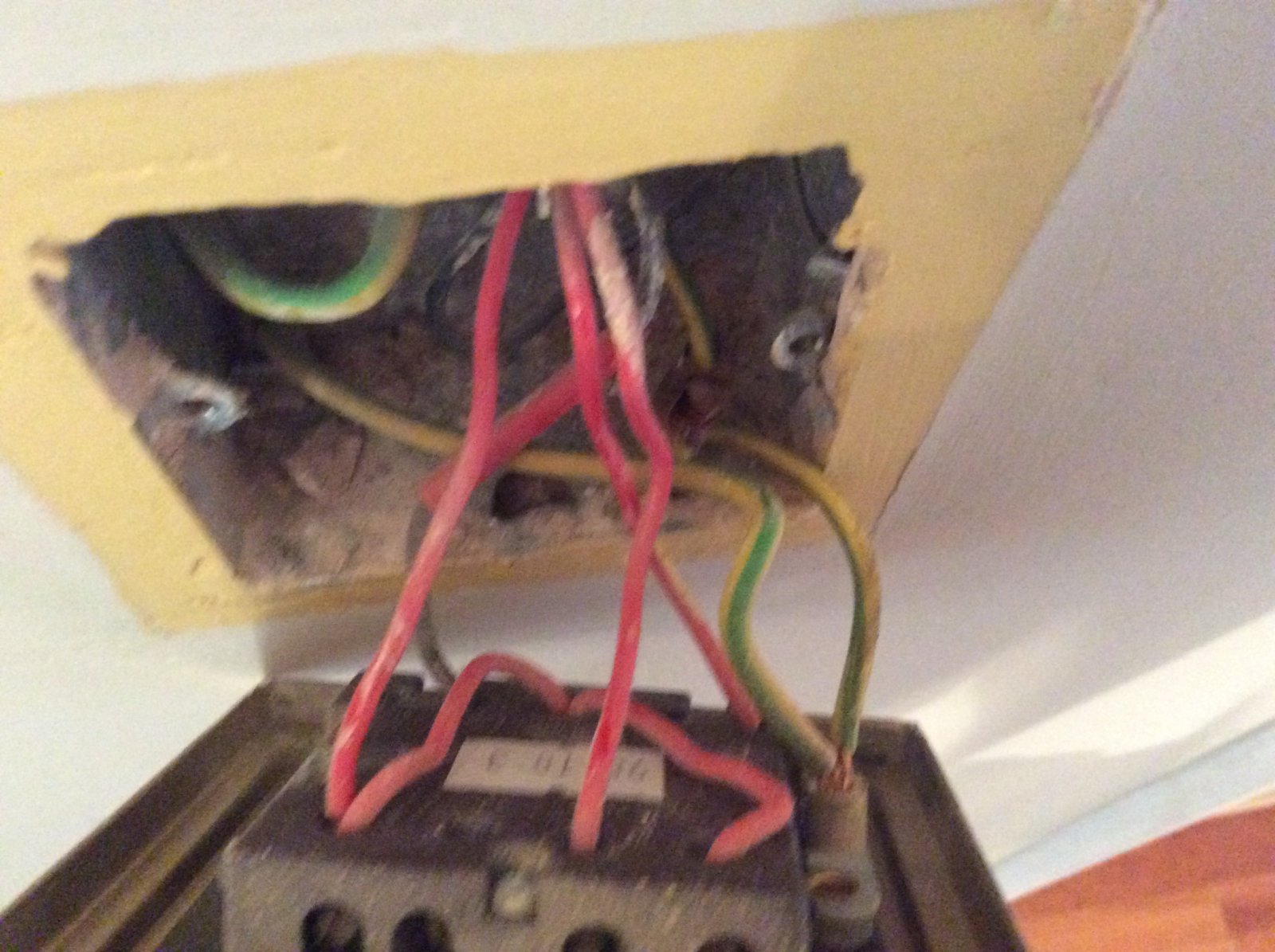

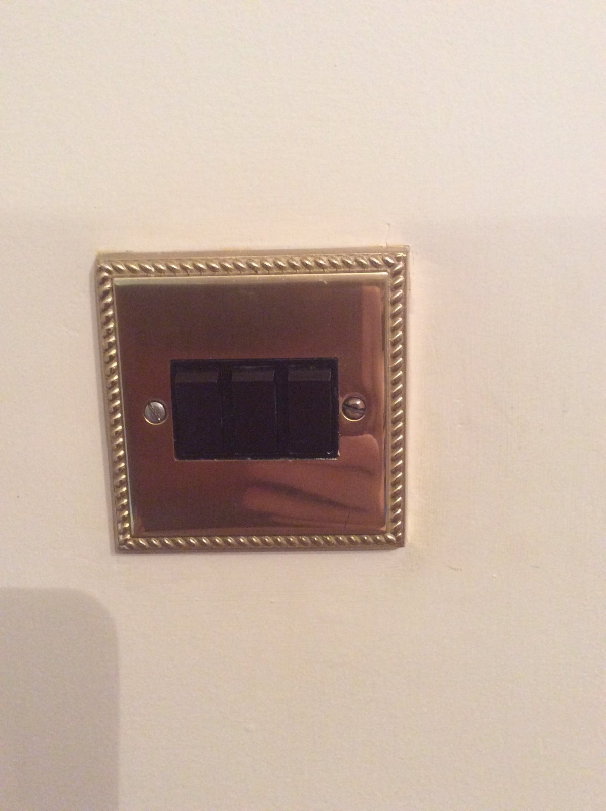

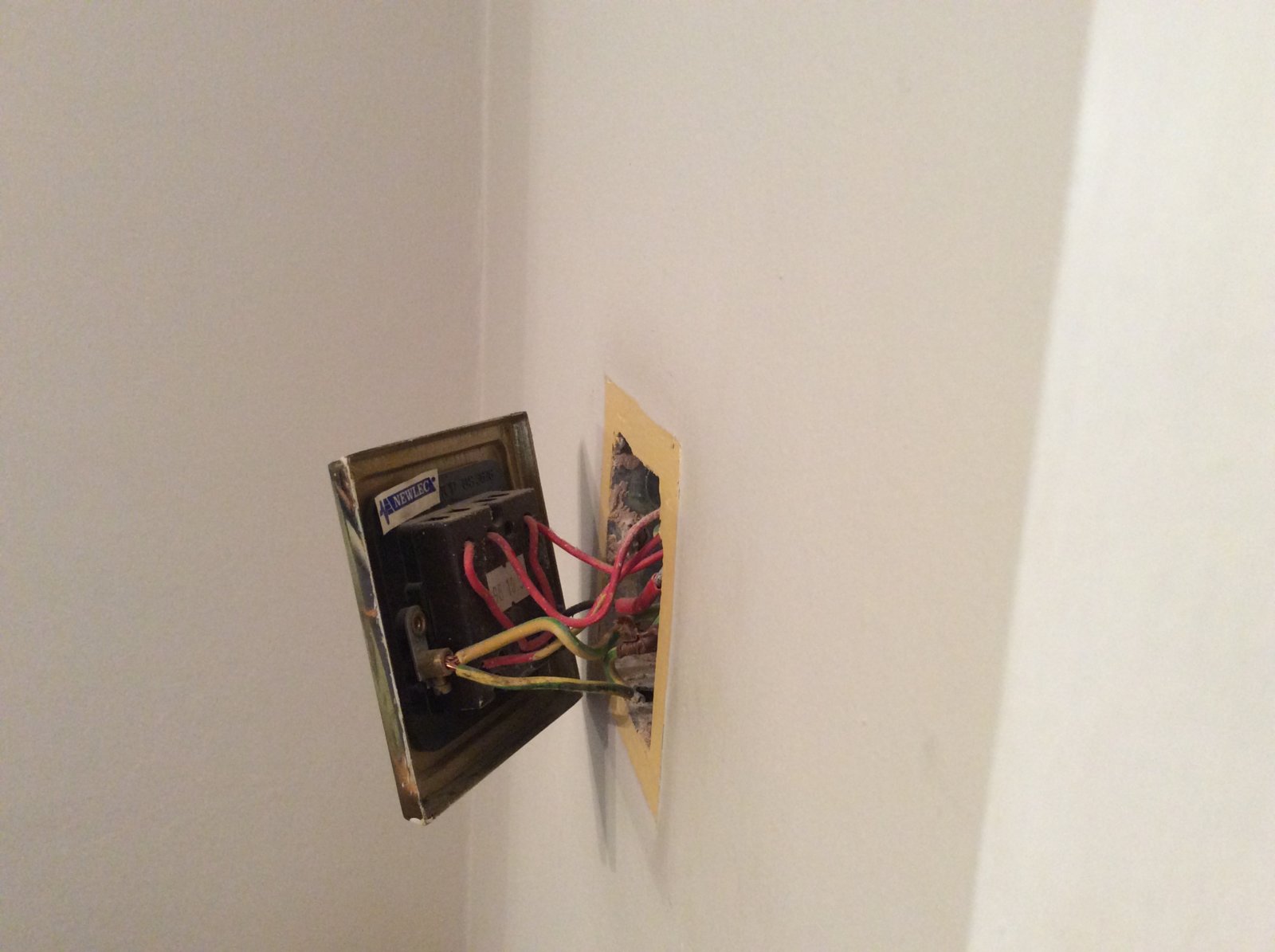

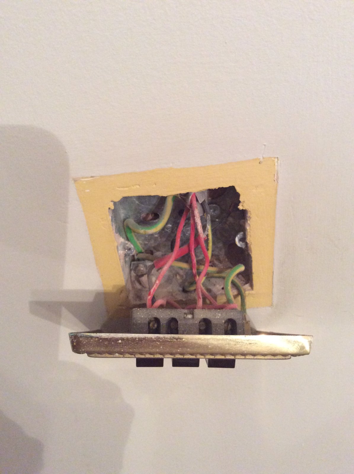

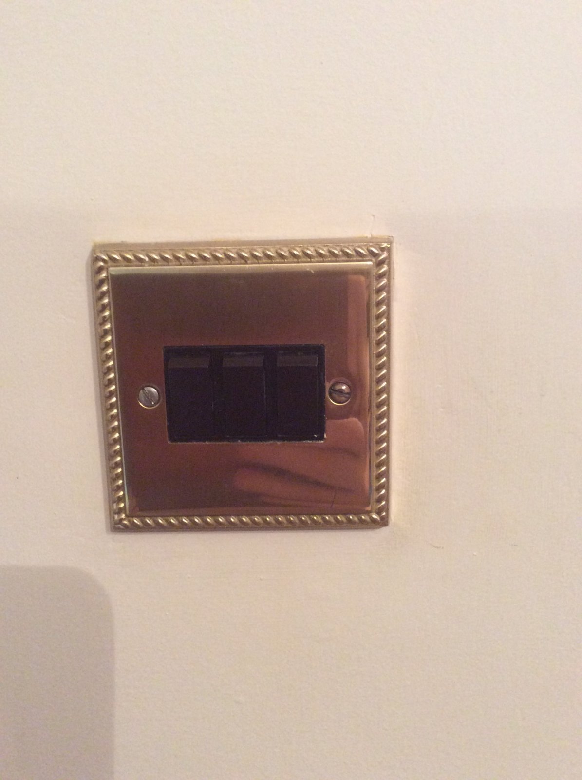

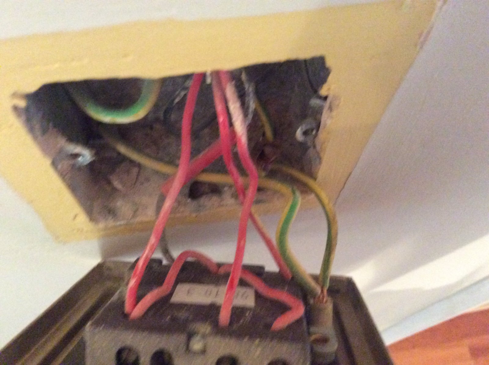

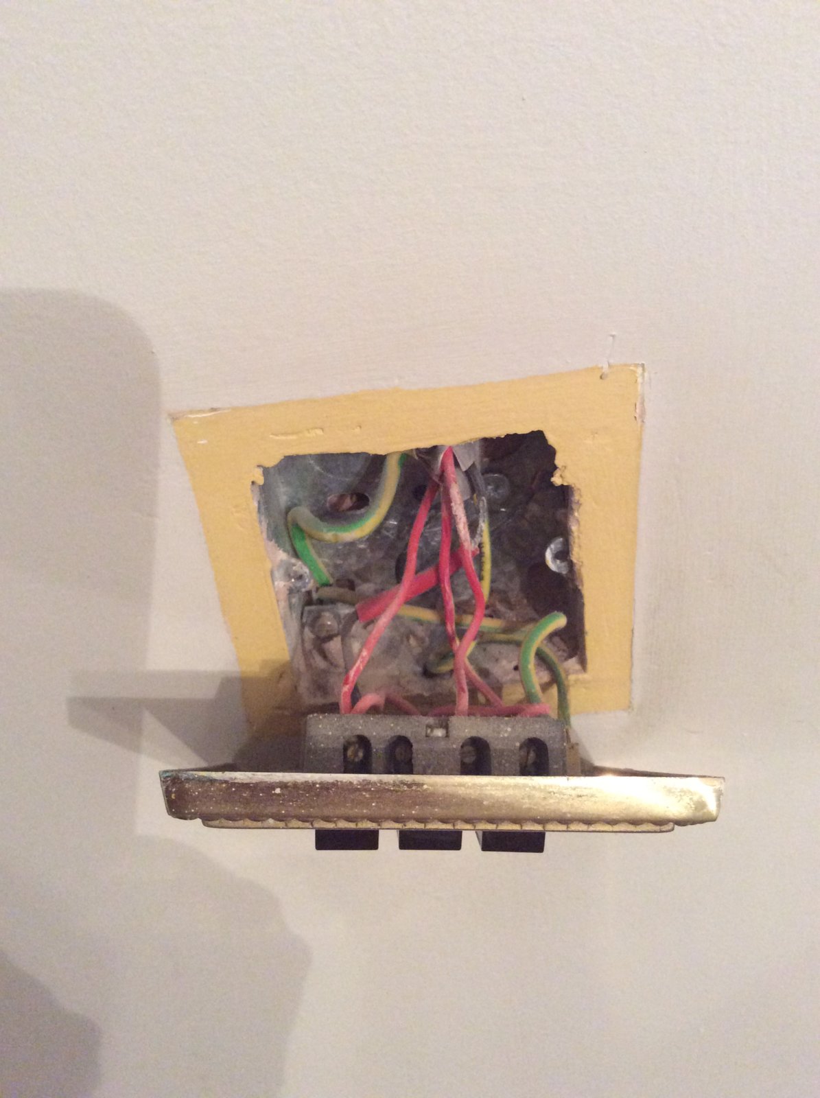

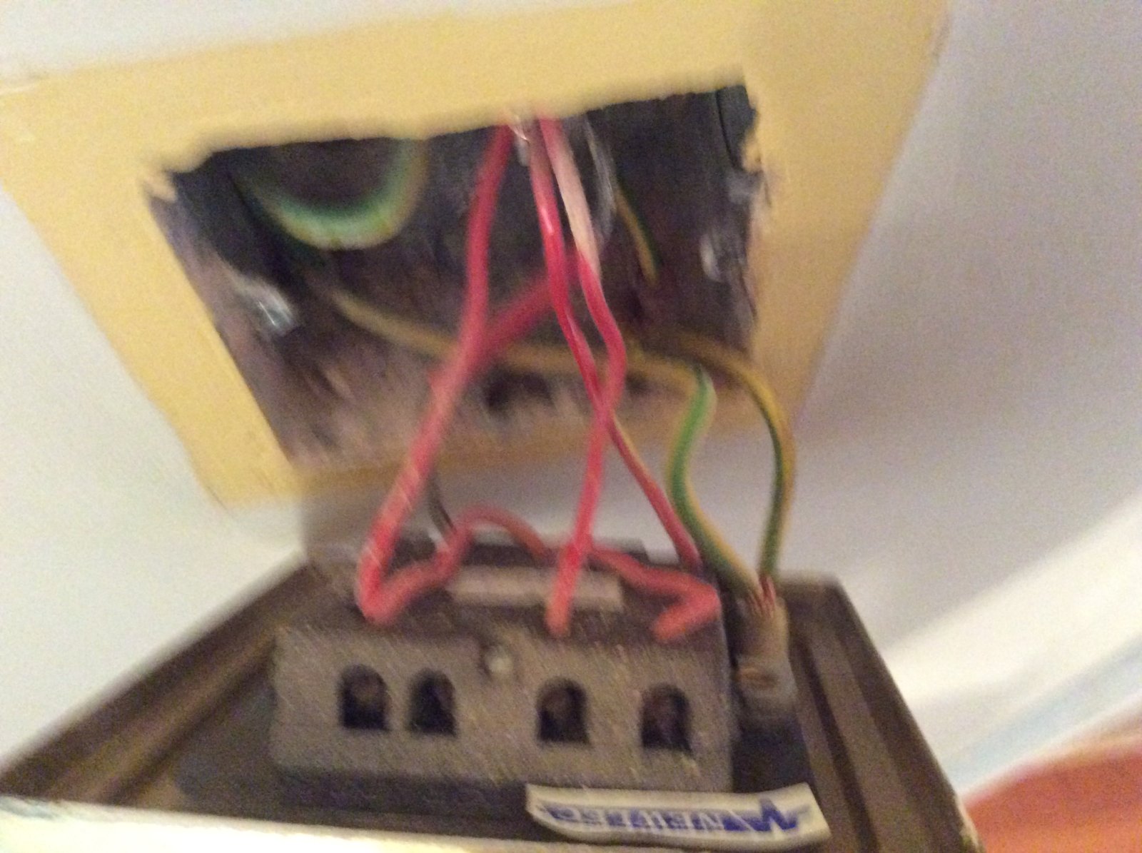

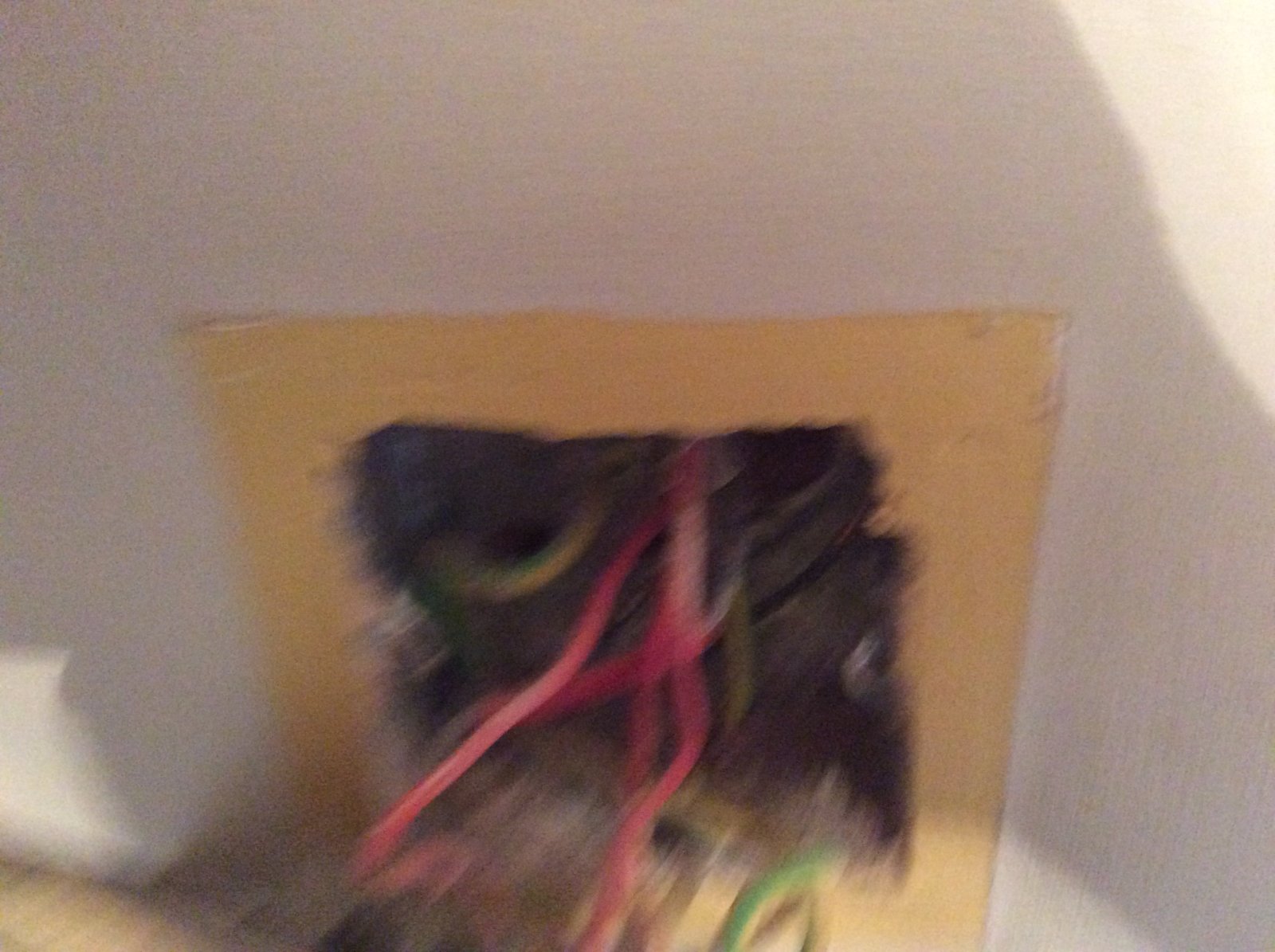

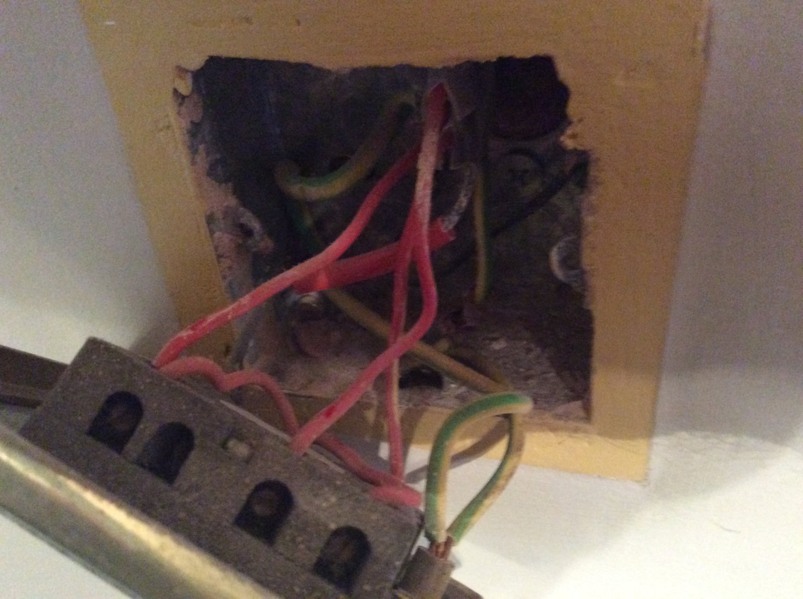

Ah yes, you are correct. Apologies I didn’t make myself very clear.
There is a 3plate switch, 1for the light I want to add to, 1 for a light the other end of the dining room and 1 that operates 2wall lights.
I tried to send picture last night but will have another go later.
Hope this is makes it clearer?
AE64F724-01BB-4B38-AE6E-56091572A35A.jpeg DCCB0325-1B34-4FAD-950C-7D0AEA79FB48.jpeg F3DF5014-4646-4849-99DD-667038AA58F5.jpeg

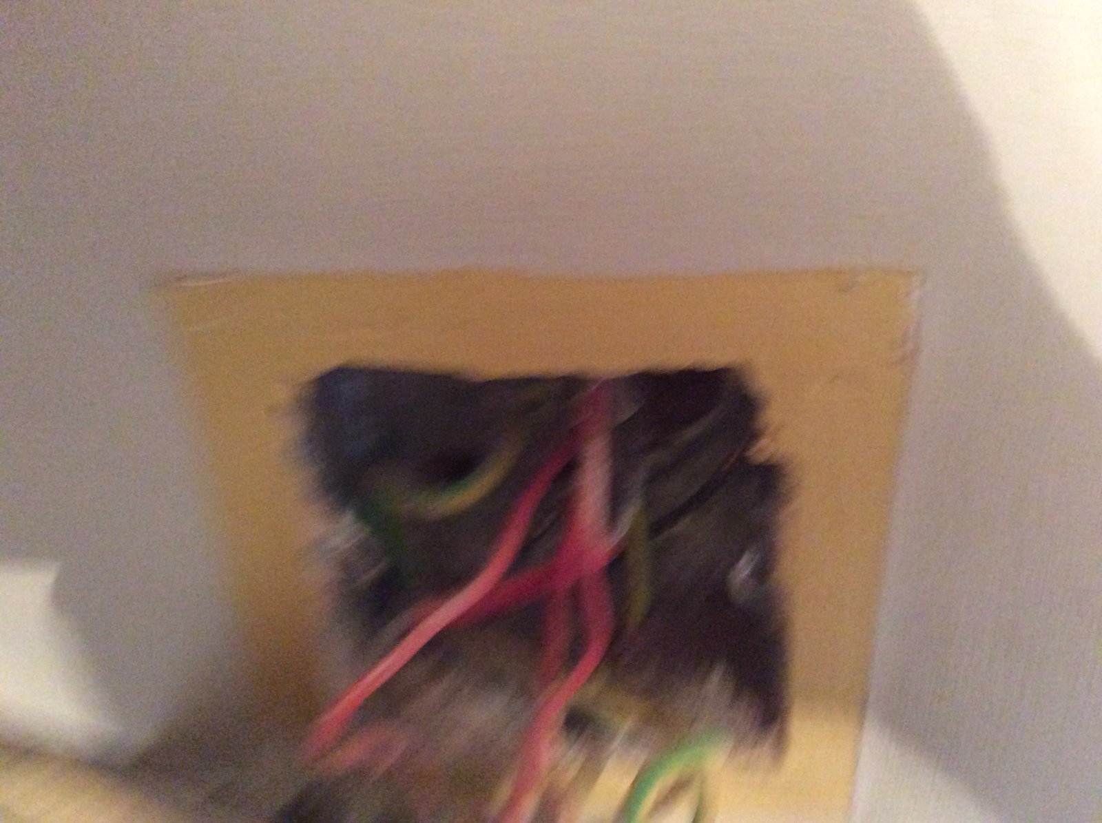

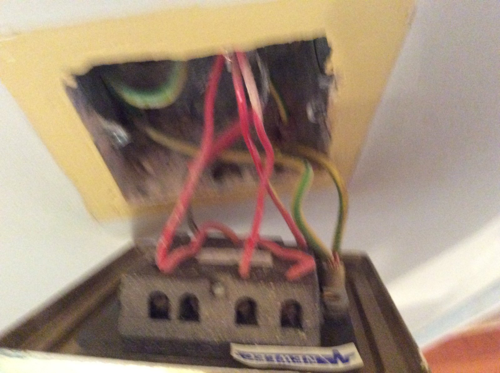

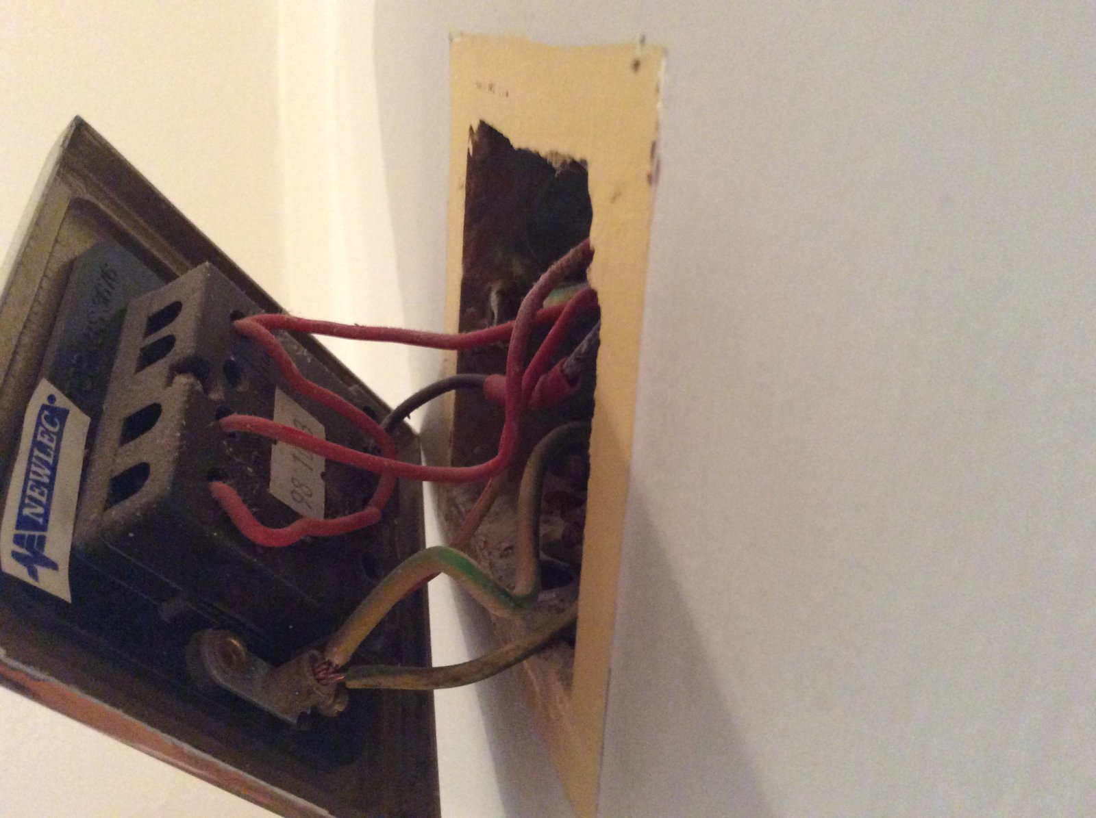

This is about as much of a picture I can get if that helps.. sorry I can’t be more precise but as you can tell electrics are not my strongest subject.
74F10C39-CE4B-4789-83E0-CD515390DF04.jpeg 74F10C39-CE4B-4789-83E0-CD515390DF04.jpeg DC4BCF9A-C0AE-49B6-921E-42764894F413.jpeg 26CB495D-B7DB-4069-8D08-2ACD80DA739C.jpeg A74941C2-3DB1-40B8-A642-A7C33138CCC4.jpeg A6240E5B-37F9-45D7-92E1-B36AE28225FB.jpeg EF3A3164-79C2-4507-AF61-A9A6C062CAC3.jpeg

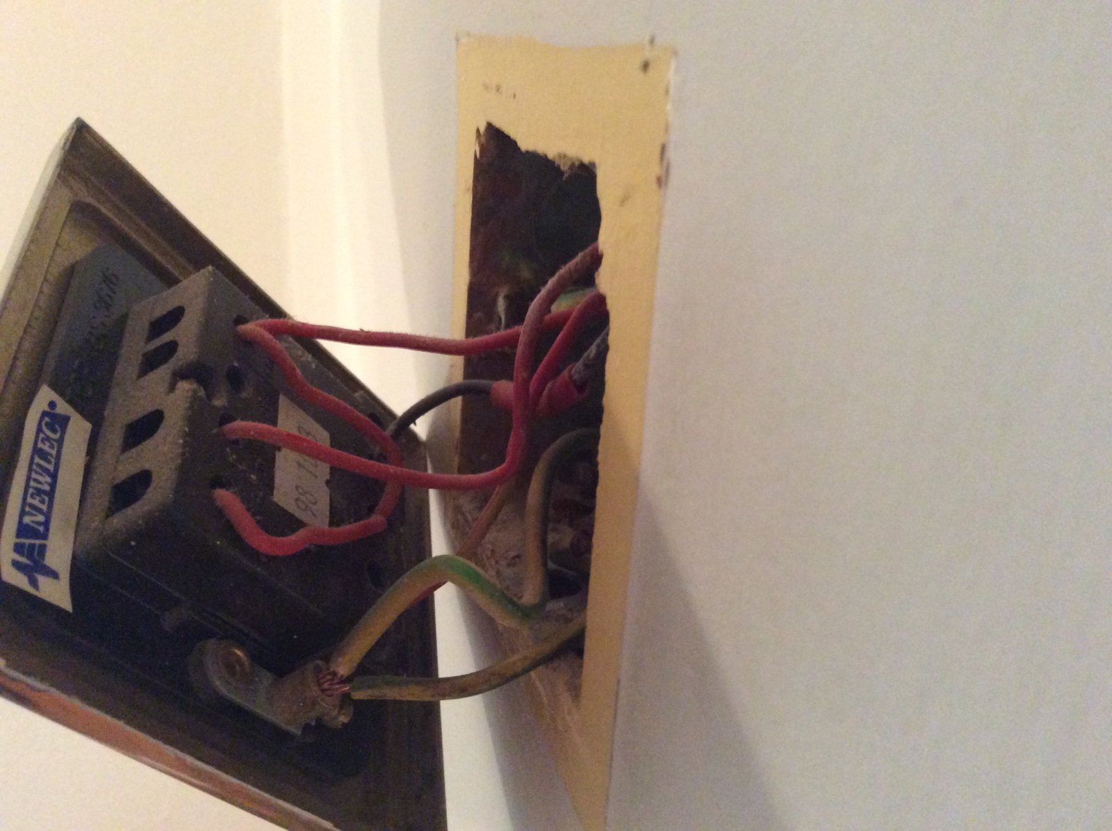

I can't see the switch wiring clearly enough.
does the yellow wire go to more than one switch?
Does the red of the 3c&e go to an unused switch?
Does the blue wire go to another black at the switch?
So the 3c&e doesn't go to the switch?
I see another dark wire in the back? where does that go?
Is one of these switches currently unused? Which one?
Once again, thank you for trying to help..
It would appear that the 3c &e doesn't go to the switch as your rightly pointed out. There is no blue or yellow in the switch so not sure why that is?
Also - you are right, there is another black cable in the switch box and it's connected to nothing which is a tad concerning? it's a black wire with copper end exposed?
