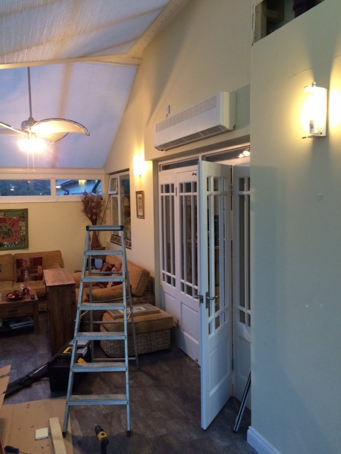

We've just fitted a fan assisted 4Kw radiator last week
separated from the main home using Evohome controls, in a customer's existing 'orangery'. You might call it a conservatory.
Runs via an existing Vaillant ecoTEC+ 630 boiler installed by us around 7 yrs back, formerly with the incomprehensible Vaillant System Solution Controls. Now heating zones and uniSTOR unvented all controlled via touch panel and iPhones (and Windows Phone)..., Vaillant controls in the bin.
Now very warm when they want it to be. Not wasting energy when not needed.
