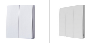

The big problem to my mind is to have something which looks normal. The kinetic switches 1720771144187.pnglook like normal switches, they use the energy of your finger, so do not require batteries, but you are looking at £40 for the pair, switch and relay, so at that cost may as well have internet access as well.

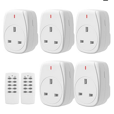

These seem
a good idea. I, many years ago, got a set from Lidi, remote control with two on/off remotes, and two dimming remotes, the latter useless today, as LED's do not draw enough current.
My problem was how do you mount the remote control.
I tried using an old phone holder, but since then we have had the magnetic push button already shown. There were three Energenie units,
one only monitored, one only switched, and one did both, but the one that did both, would not work with a remote control.

These seem
I have a couple of sets of those, but now, due to replacement with wifi, only one single switch is still in use. That one, is the one the main router is plugged into, and as a convenient means to reboot the main router, which is at the top of the house. Obviously, I could not use the wifi to turn that on/off - once off, I would not be able to turn it back on :)
