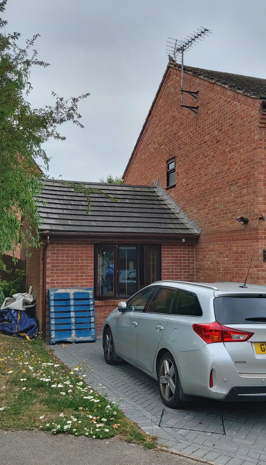

I am looking at what options I have for adding a second storey to an existing ground floor extension (see picture below) that used to be a single detached garage built in 1989.
The first thought I had initially was that the roof would come off and anything else that would enable the brickwork to continue upwards. I plan to get a trial dig done so that a structural engineer can take a look at the foundations and get calculations done. I have read that it can be quite expensive when things need doing to foundations with needing to provide additional support depending on the soil condition etc if foundations are not adequate.
If it turns out that the foundations are not suitable then one other option I have read about is that a steel frame structure is constructed to take the weight of the second storey and a timeframe is used as the inner wall and brick is used for the outer wall so nothing looks different from the outside. Is this option viable and do I need to mention that to the structural engineer and architect as one of my options?
The approximate dimensions are roughly 5.4m x 4m (21.6m²) and I have a budget of around £45 to 50k (inc VAT) and live in the south east.
Thanks in advance!

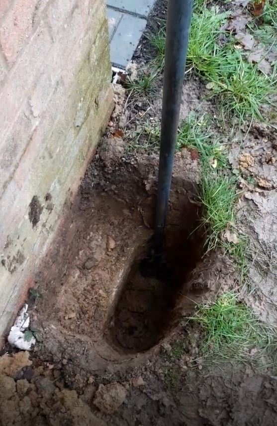

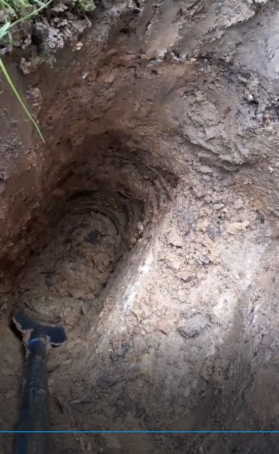

Hi @KatieDUK, we got someone to do a dig down the side of the garage and the foundation goes a little over a metre and the footings are assumed to be 600mm wide (picture attached) so they will be likely fine to have the timber structure built on top. The structural engineer has recommended for steels to be installed front, middle and rear across the room to support the first floor and spread the loading using the garage and house foundations.
Building control have said they will need to inspect the foundations themselves before the build starts but this is standard practice.
