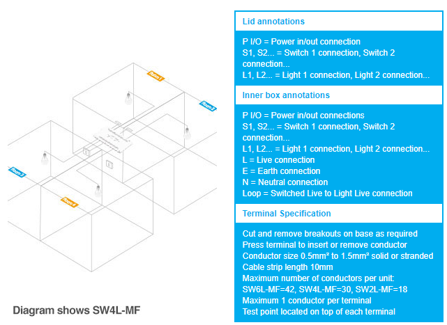

https://www.screwfix.com/p/surewire-sw4l-mf-16a-4-way-pre-wired-junction-box-white/2742j
The product above then has 4 switch connections and 4 corresponding light connections. This is the SW4L-MF and the wiring schematic is explained here: https://www.surewire.co.uk/products/light-and-switch-junction-boxes/products-and-benefits/
The one I previously linked to had one switch to operate all lights and I suppose is more suited to multiple downlights in one room.
There is a 6 light one in the picture.
Thanks, I think that's where I went wrong when linking the original Screwfix item. I was looking for someone who supplied the SW6L-MF (1 in , 6 switches, 6 lights) and ended up linking to the SW6S-MF (1 in, 6 lights).
