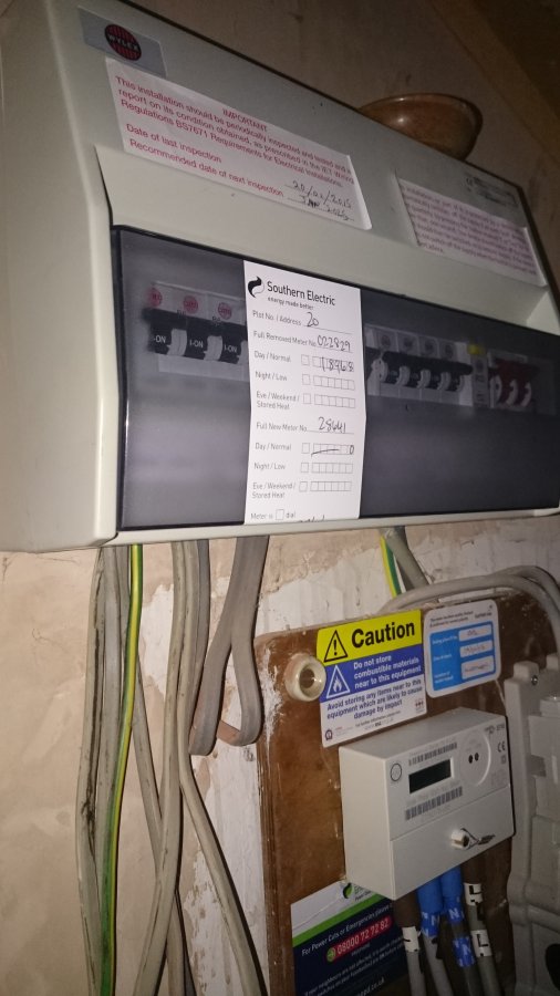

Hi,
I'm running all my Ethernet cables to a network switch under the stairs (which is also the location of the consumer unit). There's no power under the stairs so I'd like to add a double socket to power the network switch and also a Network Attached Storage (NAS) enclosure

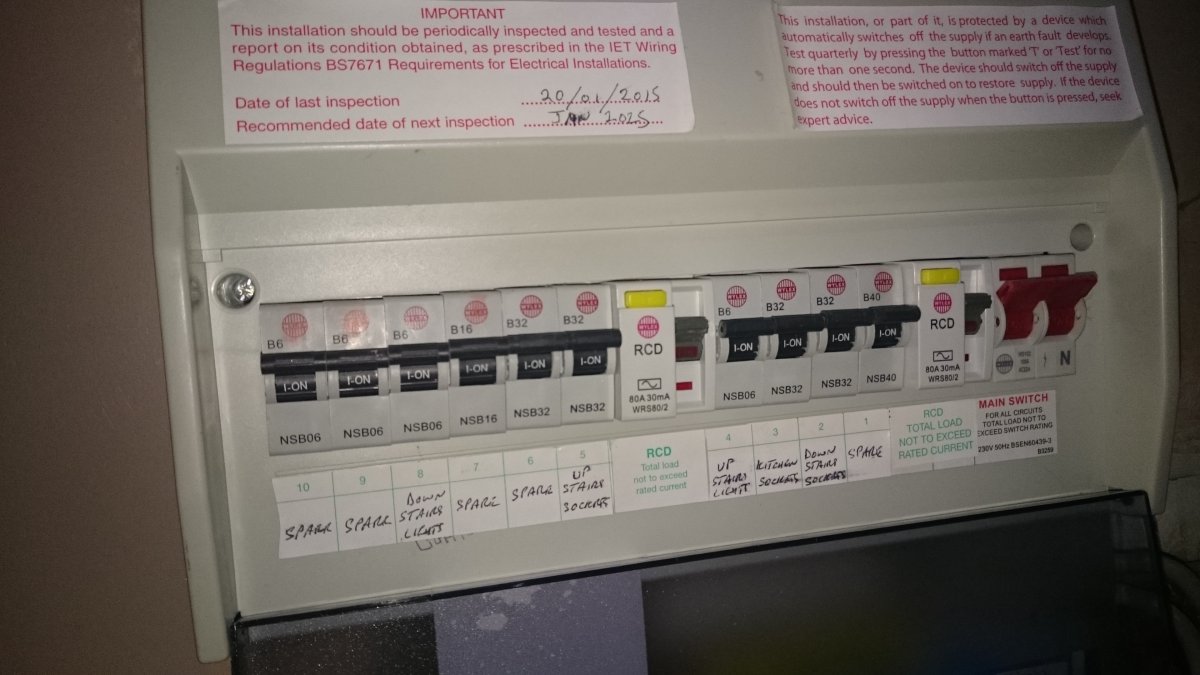

As I understand it I can break into the downstairs socket ring (right where it enters the CU) and add my new socket and this would not be notifiable. However, since my CU has a load of spare circuit breakers (both 6A and 32A) I'd prefer to have this socket separate from the main ring (A NAS is particularly sensitive to sudden power outages). However, I think this would count as a new circuit and I'd have to get it signed off. Is that right?
Thanks,

Thanks Phatboy, Looks like I'll be trying to find an electrician who's inclined to small jobs.
Three points:
1. If you just fit your new MCB and circuit without notifying the local authority, who cares, since they won't know about it? Nothing bad is going to happen.
2. If doing that really bothers you that much, you could wire it as a spur from the existing 32A ring MCB, then it wouldn't be a new circuit and so would not be notifiable anyway. (Daft, isn't it?)
3. Remember that you could have an outage due to numerous other causes anyway. If anything you're running from this new socket is that sensitive to the possibility, shouldn't you be considering a UPS for it?
P.S. Or you might have some other circuit to which you could add your socket, e.g. a 20A radial feeding a few sockets elsewhere in the house. Or you could fit a BS546 5A socket for the equipment and wire it into a lighting circuit at the latter's MCB - Again, not a new circuit so not notifiable.

Connect a new socket using 2.5mm upto a existing 32A MCB and that is within the regulations.
Connect a new socket using 2.5mm upto a existing 16A MCB and that is against the regulations.
Come on, be moral and upstanding and decent.
Let's see: Hand over a couple of hundred pounds to get a piece of worthless paper from the local authority (or more likely to argue about whether they would issue it), or keep the money and actually have enough to pay the food and heating bills at the end of the month. I'm quite happy that when in England my choice was quite moral and decent, thank you.
I assume you meant to say new 16A MCB. It just doesn't make any sense, does it?
Well there are already some spare MCB's fitted! including a B16
Don't even have to touch the bus bar !
