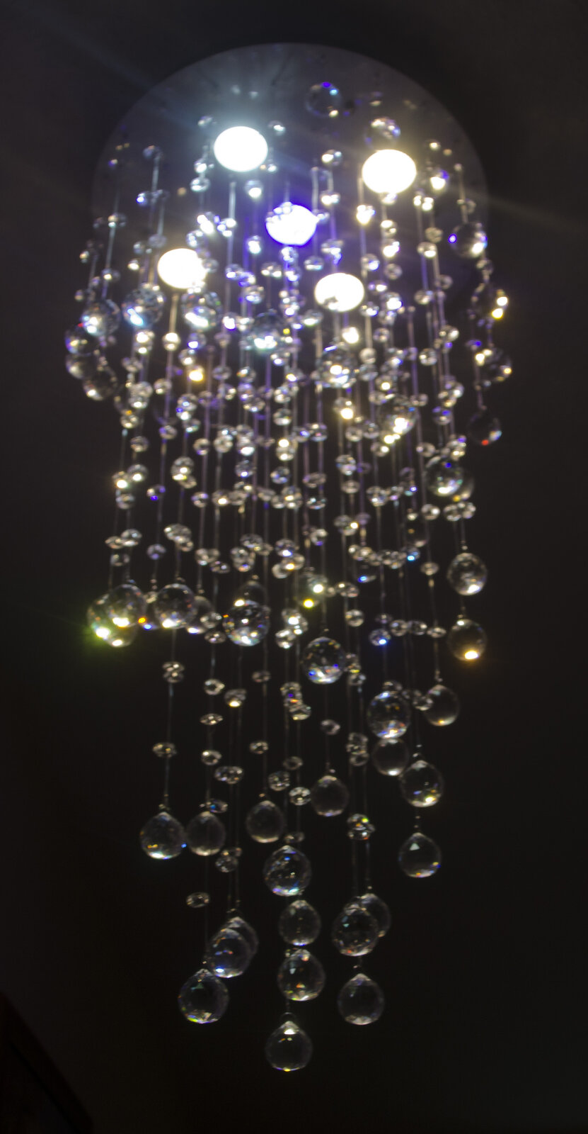

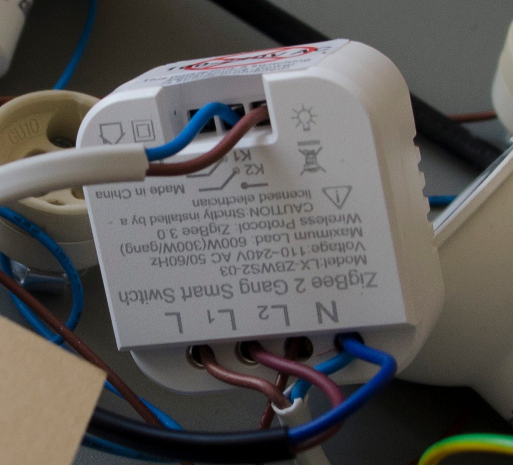

I hate the question "Can I" I have no idea of your ability, then I see "I will use an electrician, just want to check that there is a sensible solution." so I assume your asking how lamps can be controlled? specially with the "I know that I will need a switched live too, to turn the panels off and on." well I suppose that is no longer true, this lamp DSC_6799.jpg fitted for me by my son does not have a switched line as such, it has a pair of extra low voltage wires which go to a pair of two way switches so I can switch the centre lamp on/off at the wall, but the outer 4 lamps in the main are switched on/off with voice control using zigbee and Nest Mini's.
I have a relay DSC_6061.jpg inside the lamp in this case, but could also use smart bulbs, or even kinetic switches, the latter uses the energy of you clicking the switch to send a signal to the lamp.

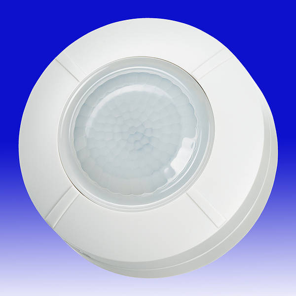

There is also the PIR many firms fitted these 1655792721269.png to save on power, so lights only one when room in use, at least it gave the occupants some exercise as they waved their hands in the air to turn light back on. I have thought about them for our living room when the smart switch failed, the number of times I have dozed off and woke in a dark room, I have set the display cabinet lights on a timer so I can at least see floor clear to light switch.
