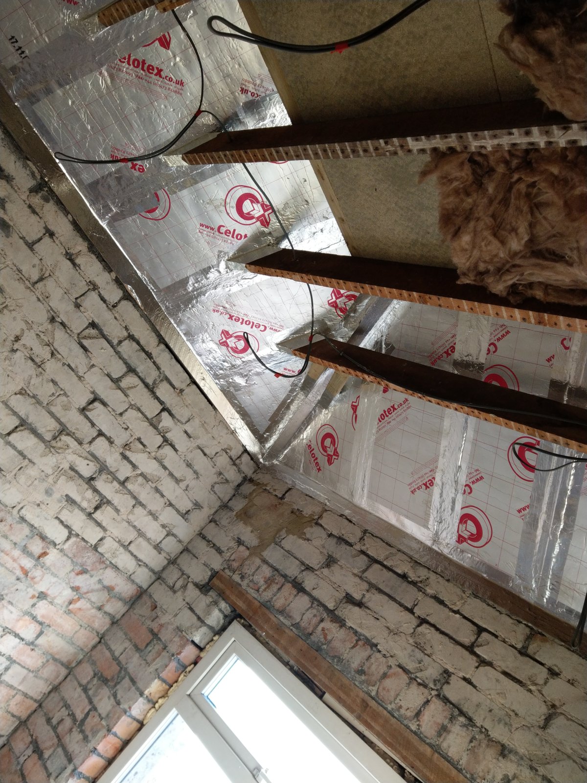

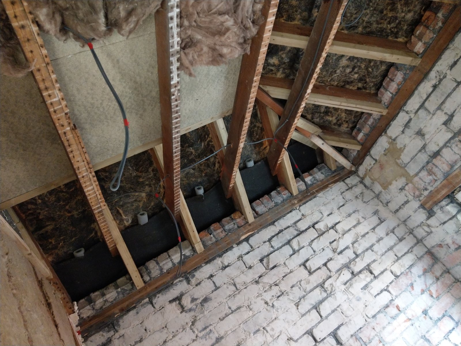

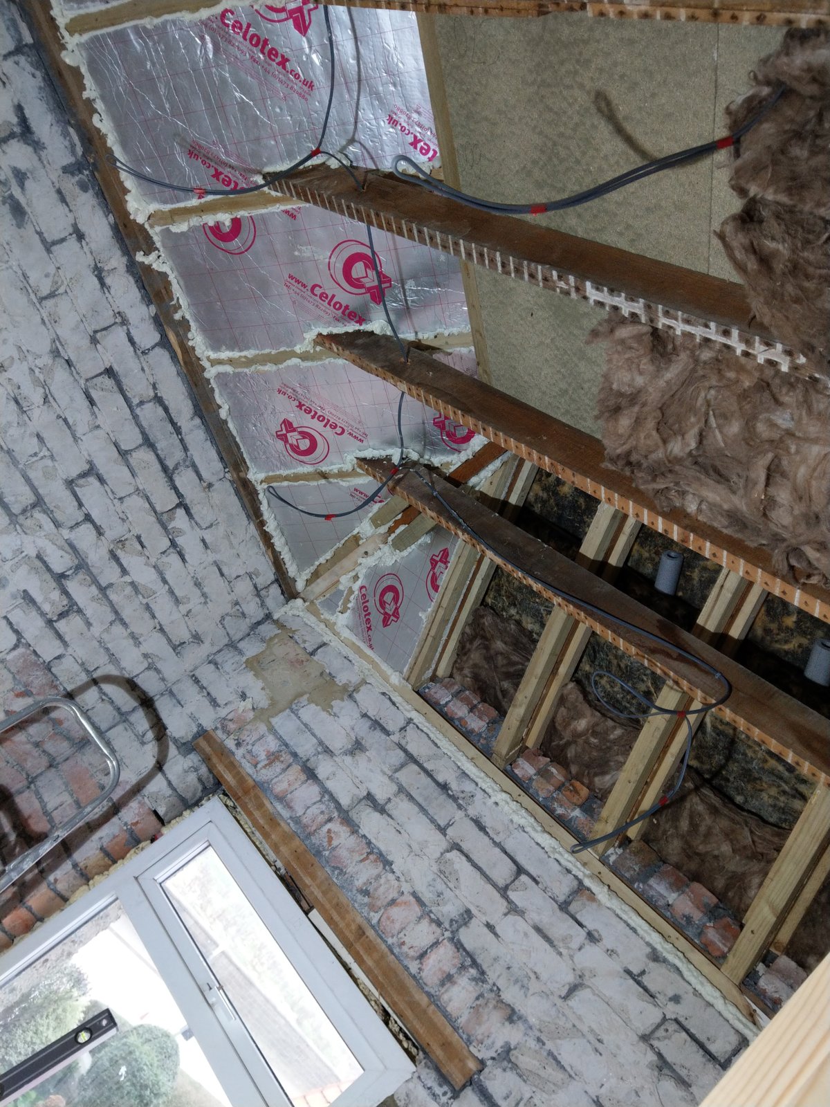

Heres a couple of wip photos I took before installing celotex inbetween the rafters...
