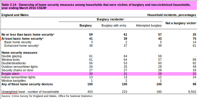

We've had a visonic powermax alarm fitted to our house (4 bed semi) with an external alarm box on the front of the house (alarm panel in hallway also sounds when triggered). Our main bedroom is at the back of the house so we'd like an additional sounder, but can't decide over an internal one on the landing near our bedroom door, or another bell box on back of the house. What would be better?
Been told the high volume of an internal sounder would make someone leave the house sharpish, but I think an external bell box on rear of the house would be better?
Opinions people?
Personally I would put it on the back of the house where it would provide a visual deterrent should anyone decide to break in that way particularly if it has an led to show that it is a working sounder. If you decide to put it on your landing near your bedroom door and it goes off in the early hours I would sincerely hope that you and your family have strong constitutions.
Never go for an internal sounder in preference to an external one. You want to deter the intruder the moment the perimeter is penetrated. That means making as much noise as possible at that very moment, rather than waiting for them to get into the bedroom where your goldfish are. Only add an internal sounder if you have external sounders and (daylight viewable) strobes on both sides of your house.
I don't wish to scare you but (there's always a but), 40% of domestic burglaries occur during daylight hours (Source: Crime Survey for England and Wales, Office for National Statistics, 2016). That means those girls' LEDs on most bell boxes are totally useless and can't be seen. In fact you can rarely see them on an overcast moonless night with all the street lights out. If at all possible and your installers are any good, try to get them to add something like:-
to the front of the bell box. They're called industrial pilot lights and operate from 12V. This one goes though a standard 22 mm hole. I have a couple and they're daylight viewable indicating that at least your burglar alarm is powered up and in working order.

Approximately 30% of all burglaries occur in properties with burglar alarms (Source: Crime Survey for England and Wales, Office for National Statistics, 2016). Since ostensibly the crime survey is a score card for how well you do your job and peddle your wares, I would have thought that you'd be more familiar with it ;)
And this comes from a person who can't even install some trunking ! ......really ....
Touché. Are you stalking me? You're not going to steal underwear from my clothes line are you? :eek: I admit that I have some minor issues with ****ing damn pieces of **** ******* plastic ***rt*** Screwf*** trunking that's ruined my sodd*** wall, but facts are facts. Makes sobering reading eh, knowing that your burglar alarm reduces the chance of being burgled by only a pitiful 55%? Isn't this borne out by the insurance companies' quotations? A self installed burglar alarm from B&Q carries no discount, and a professionally maintained one only carries a minimal (£10s) discount. They appreciate these statistics.
