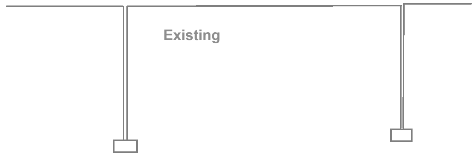

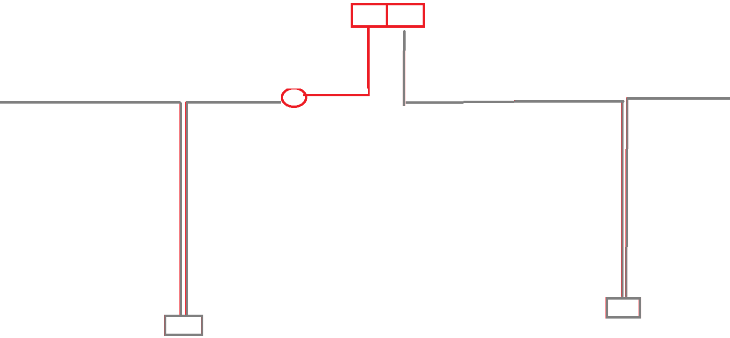

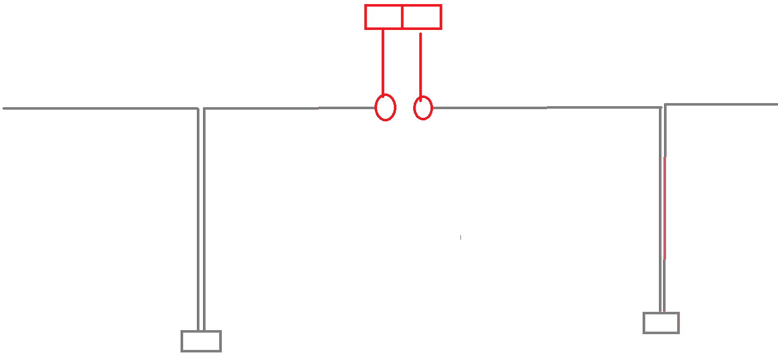

if it is a ring and your cables run in the loft;
If you are cutting and adding a junction box into a ring circuit, you could use 2 junction boxes and include the new sockets between them so they become part of the ring.
Thinking further, cut the cable and divert it into one of the new sockets then add a cable from the second socket to the junction box (where you made the cut)
