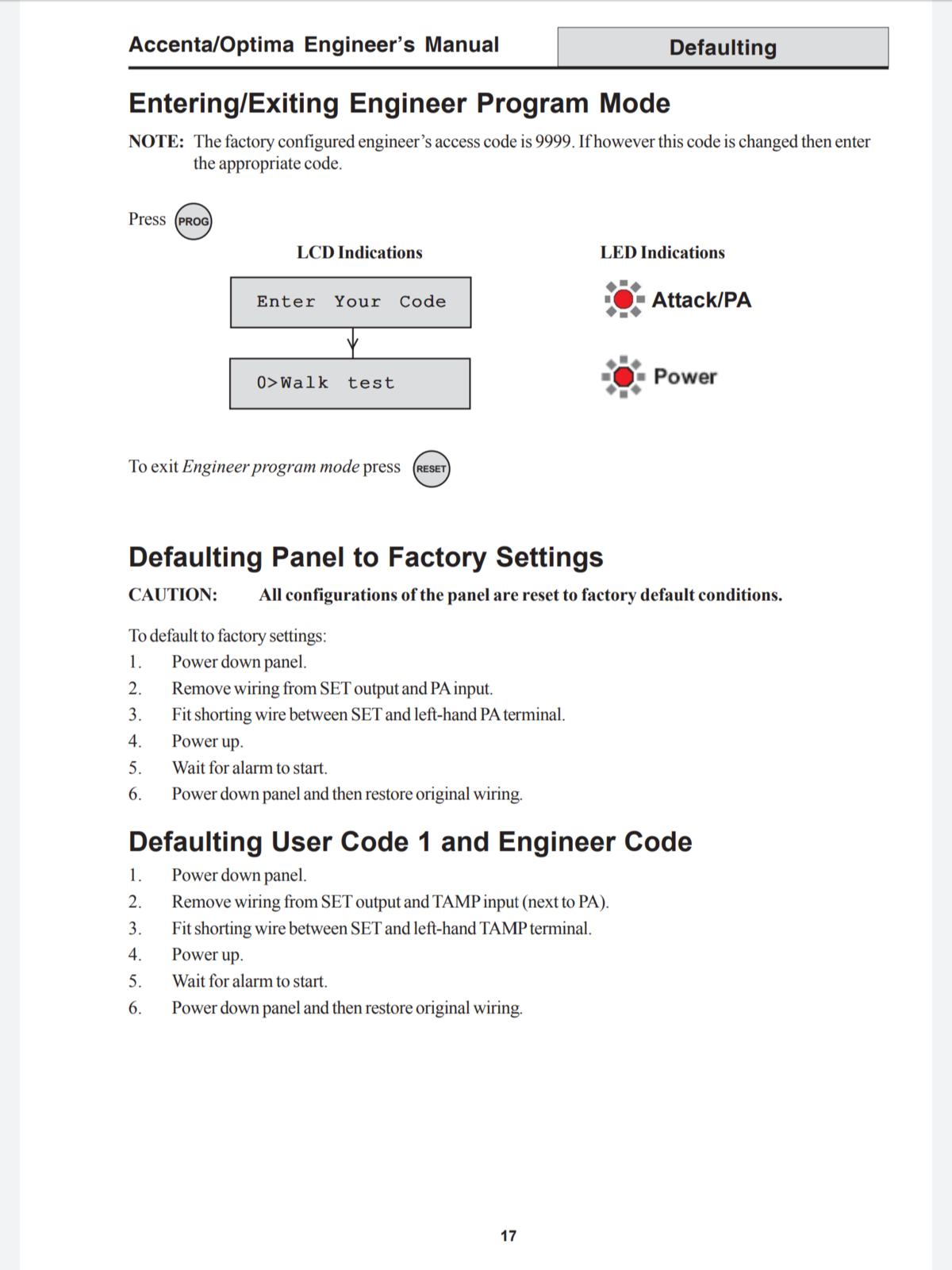

I recently replaced 4 PIRs on my system for Pet Friendly ones.
I put the system in to Engineer mode to prevent any tamper alarms.
When I removed the first PIR (Zone 4), I accidentally touched some of the wires together which triggered the alarm.
I stopped the alarm by entering User Code 1. Zone 1 LED flashed whilst the Power LED was solid.
I pressed RESET and the system went back in to Day mode.
However, when I went to go back in to Engineer mode, the system would not let me. I pressed PROG and 9999 (the Engineer Code has never been changed) and the system gave an invalid tone and remained in Day mode.
How do I get back in to Engineer mode? I have considered that I may have to follow the reset procedure for resetting User Code 1 and the Engineer Code but was hoping to avoid doing that.
Any advice much appreciated.
