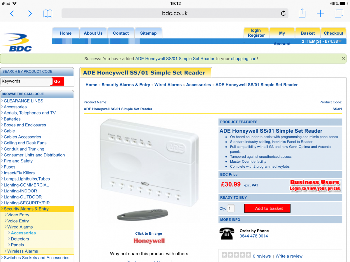

Hi all. I installed a Honeywell alarm around 5 years ago and included a simple set fob reader (rf id). This has recently ceased to function which is a real shame and it seems to be discontinued :( I have a limited knowledge of alarm systems but I would love ti know if there a similar compatible reader out there?

yeah searched high and low buddy, found that site but when you try and checkout it says they don't have any stock :(

In case anyone comes here with similar issues (there are a lot of these readers out there after all) my experience is that every so often the device 'locks up'. That is to say, it looks 'alive' as far as the LEDs go but it is both unresponsive to fobs or to status changes (i.e.day mode on/off).
As the alarm panel remains powered up all the time, I suppose one could expect this in time.
It is a bit inconvenient when you come home to disarm the panel and there is no response! All that is required is to remove the power to the reader for a few seconds. I fitted a small push-to-break switch underneath that does this. I 'reset' it this way every few weeks and have never had a problem since.
