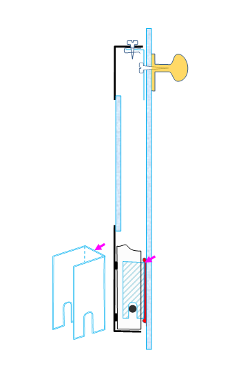

Adhesive for oven door glass-metal?
24 Jul 2003
24,294
1,420
London
U shaped stainless brackets slot over the hinge pin and are bonded to the outer front glass door - red. "Red" patch is about 3cm x 1cm. Original goo was some sort of silicone I think. Back of glass is a white enamel type paint I think, or maybe it's white-surfaced glass. I tried sanitary silicone, it didn't really stick, so tried 2 part epoxy, which also detached.
I did mount it so there was room in the slots for the glass to expand a bit on heating.
What's the right jizzm, Glass-bond??
