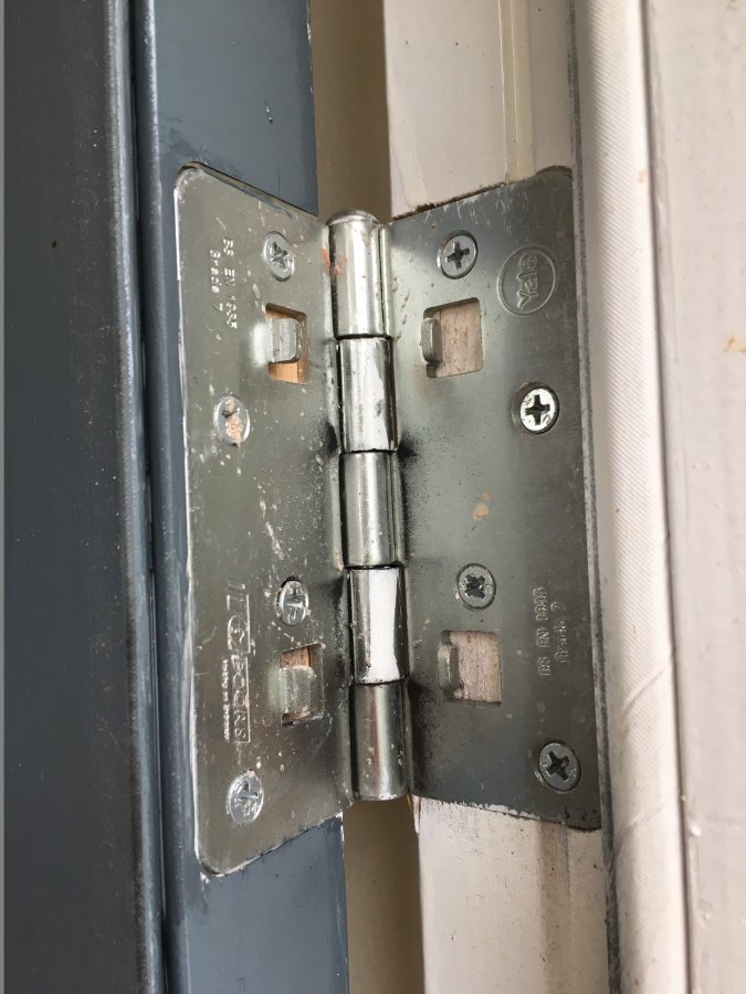

Hi all
Can anyone tell me if this butt hinge is adjustable?
There are three on the door and the door has dropped slightly and is catching on the bottom. It seems that it is not adjustable, there appears to just be a pin going down the middle. Just thought I'd check in case I'm missing anything obvious!
Many thanks
Stu
only by filling in the holes with wood splinters/matchsticks/cocktail sticks an moving the holes up a few mm
is it at the front bottom edge its rubbing ??
may be the top hinge is loose??
Yep, front bottom edge. Looks like I'll have to try taking the door off and moving the hinges up a few mm!
