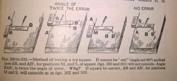

For anyone reading this who doesn't know how to check for squareness, read this:
From a carpentry and joinery text first published in 1939. Note that you need to check using the same edge of the ruler because rulers don't always have truly parallel edges (especially on cheap stuff)

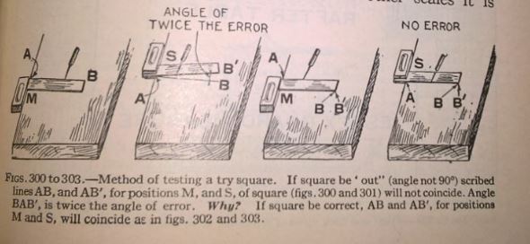

If a try square proves to be inaccurate, then I should have thought that the above method - the first section, using the 'flipping over' method - would suffice. Just bisect the angle and use that as the true square!
Yes, a little additional work, but better than shelling out £200!
So how exactly will that help me when I'm planing the edge of an 8ft door and want to check that the planed edge is at exactly right angles to the face from end to end (a real world problem, BTW)?
