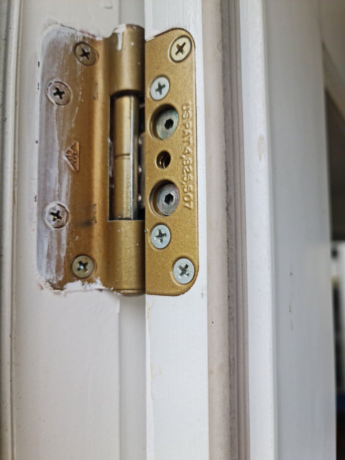

I need to repaint some patio doors which are timber.
First I need to lift the door as it is rubbing against the bottom of the frame/step. Anyone know how to adjust these hinges?
3d hinge, normally you just slacken off the two hex bolts and lift the door up to the desired position, hard to tell if they are at their max. The central one is to pull the door into the frame Adjustment is around 2.5mm

... And just checking, the door is on the right of your image?
I'm sure it is, as it appears to be at its lowest adjustment.
It may also be worth checking the other adjustments that are available.

Cheers. The alan key in the underside of the hinges worked a treat.
