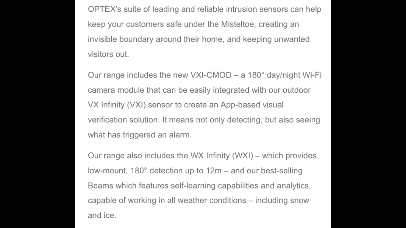

Are any of these beam systems cable of sending push notification?
Optex do external units with camera/ ( add on WiFi that do push notifications been looking at these for a job
