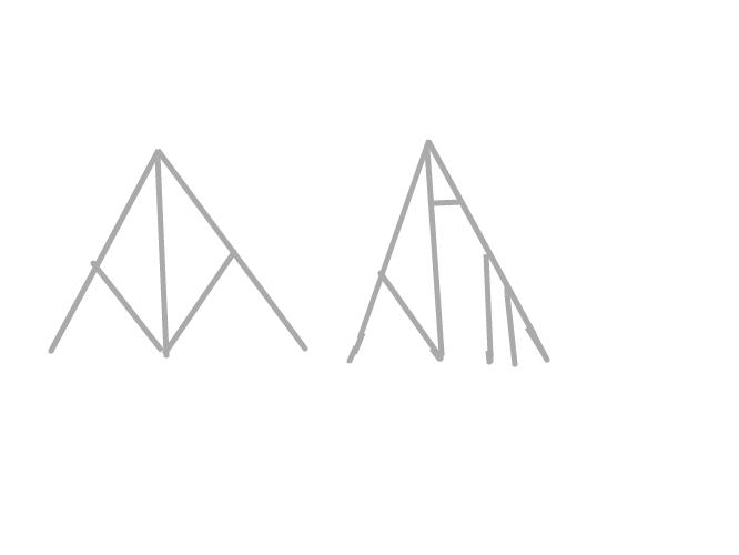

Hi, we have decided to do some work on our loft and just thought before we go ahead any further with work we would lift the boards that have been laid by a previous owner to see what size the joist are, we have discovered that the original joints are 4 x 2 and have had a piece of 2 x 2 added to them making the total thickness of the joist 6 x 2. Is this what is meant to be done or has it just been a botch job and there should have been 6 x 2 joist run along side the oringinals. Also the roof struts look like they have been altered. Is is safe or not. I will try up upload a drawing to help explain. Drawing is in my album if you can view it I cannot seem to download it onto this post. //www.diynot.com/network/sandram9898/albums/

Thanks Ajrobb for uploading pictures, first picture is of original roof strutt and second is how it is now, I think it has been done to make it earier to gain access, it now look like a doorway.

Thanks for advise on storage now can I just ask if anyone has any answers for the roof strutt (I think that is what you call them, ) 1st picture is how they originally were second picture is how they are now, looks like it has been done to make access easier, sort of makes a doorway. Just want to know is this safe, otherwise we want to put it back to the original way.
Thanks you
How many trusses have been altered like this?
If only a couple then they should be ok, but if all, you need to check whether the two upright supports that have been put in to replace the diagonal braces are supported by a wall/s beneath.
If so they should be fine, but if they are only supported by the ceiling joists then part of the weight of the roof will be being carried by the joists. In this case I would suggest that you should not put any further weight onto the ceiling joists before replacing the diagonal braces.
However, if they were already like this when you bought the house, I would like to think the surveyor would have picked up on any weaknesses there may be.
Hi, there are only 2 in the whole loft and one has been altered like this, There is a joist underneath them which is much larger that the rest. The rest of loft has 6 x 2 joist and under these 2 are 8 x 4. which the large centre piece lies on. Obviously all the weigt from the centre piece is taken by this piece of 8 x 4.
