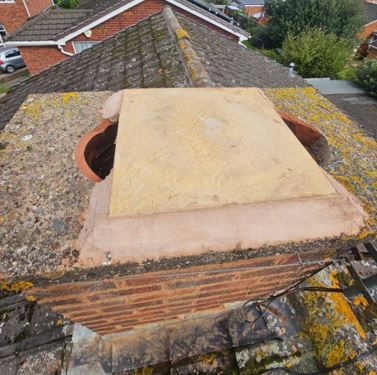

My mother-in-law (in her mid-80s) lives in a semi-detached house, with a shared chimney. Now, I think the neighbour (not elderly, in her 30's) was having some leaks on her side, so she arranged for some workmen to carry out remediation.
Now, according to other neighbours and the mother-in-law, they were not the most professional bunch (running around on the roof, did some minor damage to the edging of the roof somehow), so she was concerned about what they'd done. She contacted a local builder who she knows and they went up on the roof to check for additional damage.
He took the attached photo of what they did and basically said that they had done was not correct and potentially dangerous (I think that they removed the pot(s) that were already there). Coincidentally, a couple of days later the gas supply company were in to fit a new smart meter and when he went to test the gas fire, the M-in-Law showed him the photo. He promptly slapped a warning notice on the gas fire as shown in the other attached photos saying that it should not be used.
TBH, I'm not sure what they were trying to achieve but the neighbour does not have a fire (I think it is blocked in). If they were going to block it off, would they not have done the whole thing, rather than left it exposed each side. But, I think it is obvious that they haven't considered the M-in-Law at all in this.
She has raised it with the neighbour but I don't think that the neighbour thinks that they have done anything wrong - I'm not sure that she has seen the warning notices plastered over the fire yet!
My wife and I think that the neighbour should sort it out (unfortunately, I don't think that the original workmen will be coming back any time soon) but we just need some advice about how things should look and some idea about what they were trying to accomplish, so that we can go back and put it to her.
