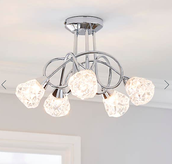

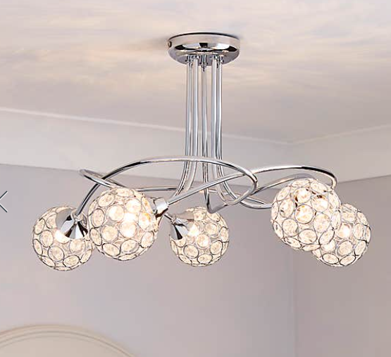

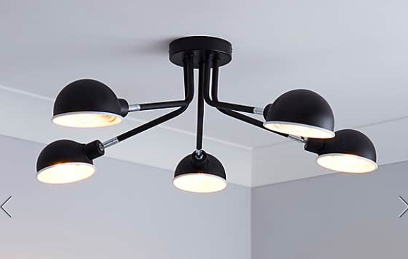

My lounge ceiling height is only 2.33m so can't have something hanging lower than the current light bulb (at 30cm). Are the pics below the sort of lighting I should be looking at?
I would be very careful with buying these online. The shades / lights may be smaller than they appear.
I do have an 8 ? shade one in my living room. 12v halogen and it does give good light.
I did buy a 3 shade one online (similar to the last picture) that I fitted with leds. And am disappointed with the light output.
I guess this doesn’t help you very much!
some quantity in the middle maybe ok!

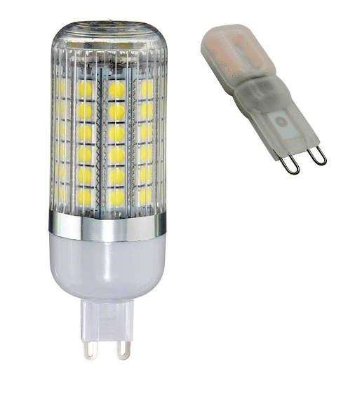

Regarding new lights be wary of what lampholders they have fitted, due to a lot of Halogen lamps being phased out, you could be lumbered with a fitting that may not look right or even not work (due to transformer incompatibility) with the so called Led equivalent lamps, mainly G4 and G9 lamps
You have made a very good point, wife's bedroom uses G9 both these G9-comp.jpg are G9, the small one would not switch off it flashed, and had a shimmer when turned on, but the covers did fit, the larger one worked great but covers would not fit, and can only buy on line.
