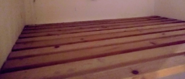

I have some a built in wardrobe but unfortunately there is no shelf (e.g. to put folded clothing on).
However someone fixed some timber battens to the walls, so I assume that there was a shelf at one point
And i would like advice on how to build the shelf to go on the battens
Does one use ply, mdf or individual pieces of wood (similar to the pic)
Also what would be the best/simplest way of fixing the material to the battens?
You could use individual battens, as in the picture, and space them evenly. These could be secured by a countersunk screw at each end.
Plywood is better than mdf for supports as it is structurally stronger. Measure front to back on both sides to ensure they are the same and measure side to side at the back, middle and front as there may be a slight variation along the side walls. Transfer these measurements to your plywood but subtract 3 mm and cut with a sharp panel saw. I usually score the lines with a sharp knife to help prevent splintering. The reason for subtracting 3mm is to allow for run out of the wall and expansion of the wood. You could cut it exactly to the measurements for a tight fit if you prefer. Again, fix this at intervals to the battens with countersunk screws.
I find mdf gives a dusty finish unless you paint it. And to be honest, I've never got as good a finish, despite doing all the sealer/primer/undercoat/top coat business, as I can on ply or real wood.

Thanks for the comments guys. If i went with mdf will i have to allow for expansion 3mm as well?
You don't have to but it's good practice. Any gap due to run out can be filled with a thin bead of mastic or you can make it a snug fit as MDF doesn't shrink, but it may swell if it gets damp.
