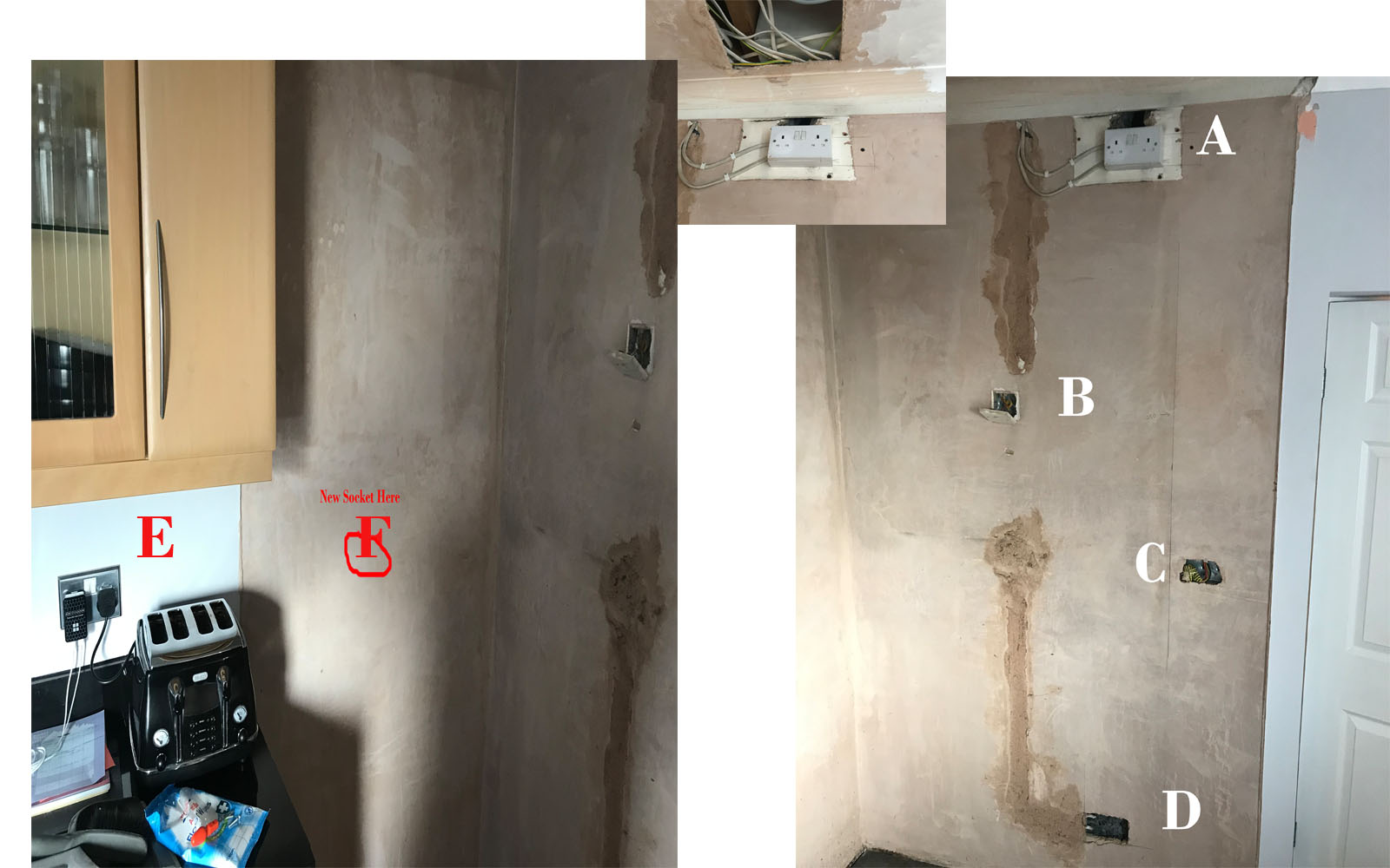

I've just removed a corner unit and some cupboards in order to put a fridge there. On doing so Ive found a right old mess. Hopefully the photos are big enough to explain.
I basically need a double socket where ive marked in red.
On the other wall around a corner I have a double socket marked A. a light switch that does nothing marked B. A double socket (not sure if it was a light or a socket, wires still there) marked C. Then a double socket with 2 cutoff cables which I assume were cut and used for socket A. I have a hole in the ceiling above socket A which you can see.
SO I want to lose everything there at the moment and put a double where ive marked. What are my options? for the new socket I assume I could
1. have a spur run From E to F?
2. Run a spur from C to F but that is an internal bend round the corner. is that allowed?
3. Pull back A cables into ceiling, joint new cables and run down the wall then round the corner to F? I dont want to make another hole in ceiling and coving above F.
Then re losing holes/cables
4. I assume I can fill the D hole as the cables are cut.
5. I there a way to tell if C was a switch or a socket? Worse case I would have a double socket there but would rather lose it.
6. B Switch - I take it I cant just fill this? I assume I can't pull cable in ceiling to identify and cut? Can you put a tone on it to identify like you can with phone cables? I can then have cut and fill hole.
7. A Socket I assume this can just be pulled back and joined in ceiling if not required and not using for new socket?
Hope this makes sense. I have close ups of wiring if needed.

For the new socket add cable(s) from E to F. Whether it's a spur or not depends on whether the circuit is a ring, and if the existing socket E is on the ring or is already a spur.
As for the rest - ideally identity all cables and confirm dead, or if not dead already disconnect them in the ceiling and if joints required make those in a maintenance free box. Then repair/replacter wall and ceiling.
If not possible to locate/disconnect, ensure all wires are terminated / jointed as required and fit blanking plates over the holes.
Myself, I would not take what I could see at face value. I would take out all the existing cables and boxes which you don't need (ABCD).
Then you will be able to see the wood.
Is B actually a light switch, or is it a switched fused connection unit?
I might also be tempted to dig out some of the bonding in that hole and see if there are any connections buried there.
There are a lot of cables in that ceiling void...could there be a pair for each of those accessories?
Are all the cables in the boxes A B C and D white?
B is a single switch that doesn’t do anything. Has 1 red yellow an blue wire.
The 2 going into A are white. I reckon they cut those in D and pulled back to become A. You can see where they gave channeled out most of the wall.
I would of thought to lose A I would need to pull the cables up into ceiling and join them there.
It’s the switch and C that I don’t know how to lose.
C is 1 white cable with red, black and earth. Ideally don’t want anything there but worse case would have a double socket. How do I tell if it was a socket or switch?
Was wondering if the switch was actually a light switch or an appliance switch connected to the socket circuit.
It looks as if that switch could have been an additional light switch but you say it does nothing?
