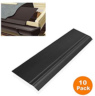

For me a far better solution would be support trays. Maybe these could even be slid into position without removing the tile at either edge? But is there some disadvantage of support trays that puts roofers off using them?

We had Gutter Trays fitted this year, this would have been a far better solution for your roof?.
Can't see why they wouldn't have fitted them if they had the tiles off anyway?.
Thanks, you are right, but maybe it's too late now anyway, it could be the original felt has been cut back too much? Does it have to reach near the front of the tray?
I'm not a roofer but hopefully they haven't cut back the original felt and just slid the new felt under the existing.
We had two rows of tiles removed when he fitted the trays. Don't think they can be slid under but could be wrong.
Is it worth asking who did your roof if they could fit the trays?. Can see it being FOC but may be worth paying for peace of mind.

No, proper roofers dont, but you have not had proper roofers by the looks of this, the upside down membrane (LOL, I mean they even put the writing on in big letters to prevent this) the lazy failure to remove all the tiles, and the lack of support trays.
I would suggest going back to the 'roofers' and express your concerns and quoting the comments people on here have made regarding the eaves felt support trays. (easier said than done of course :!:)
