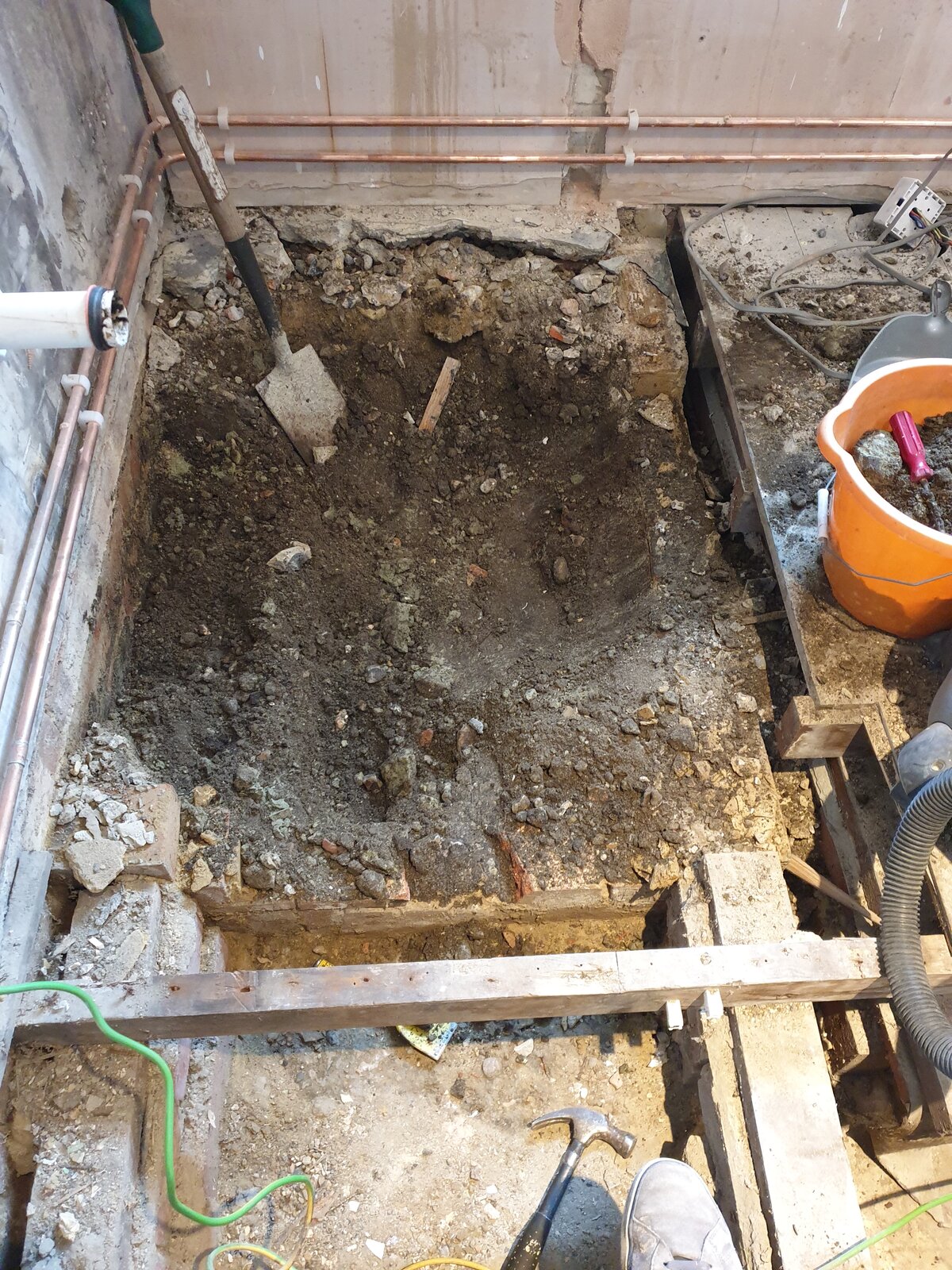

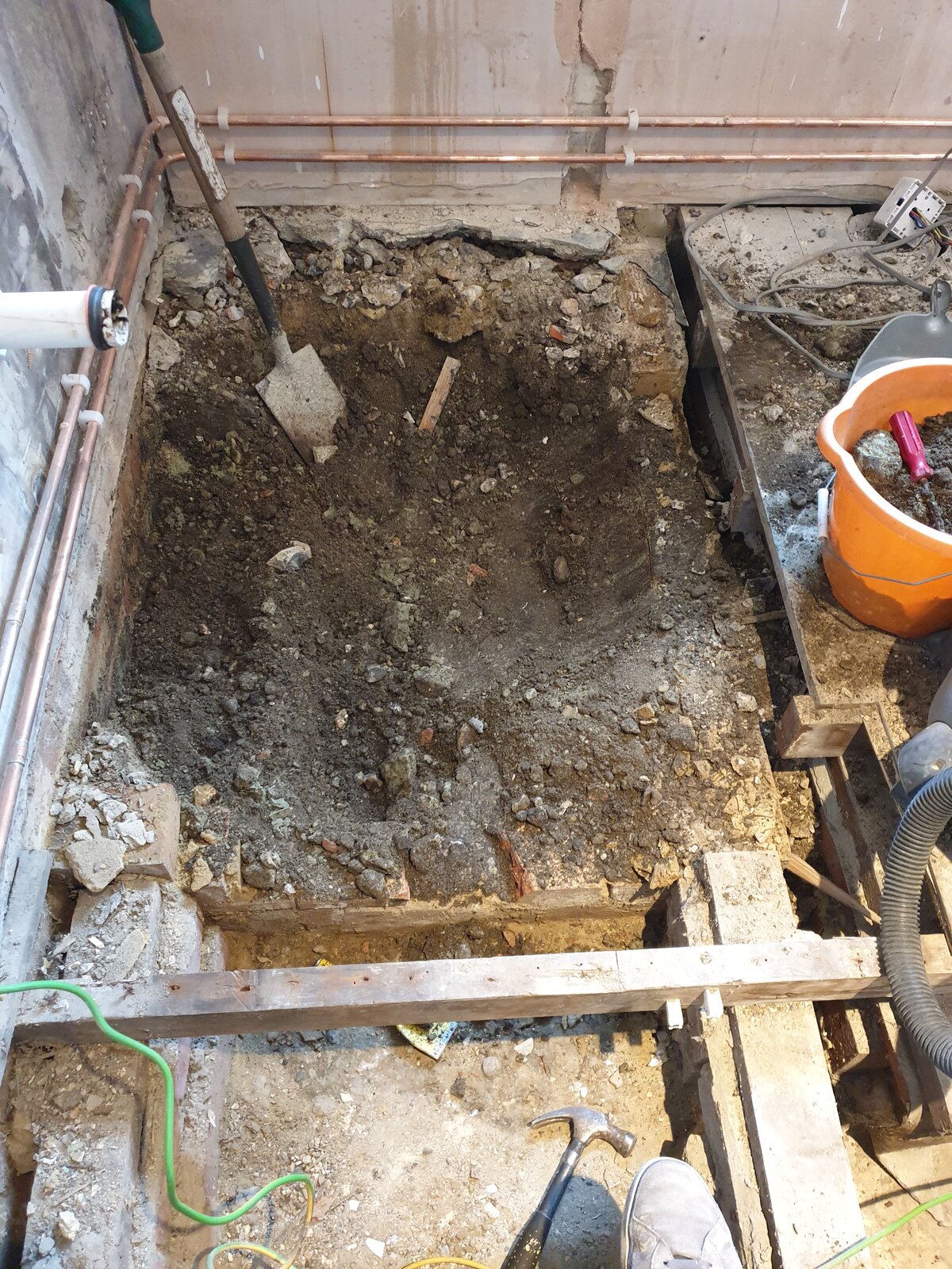

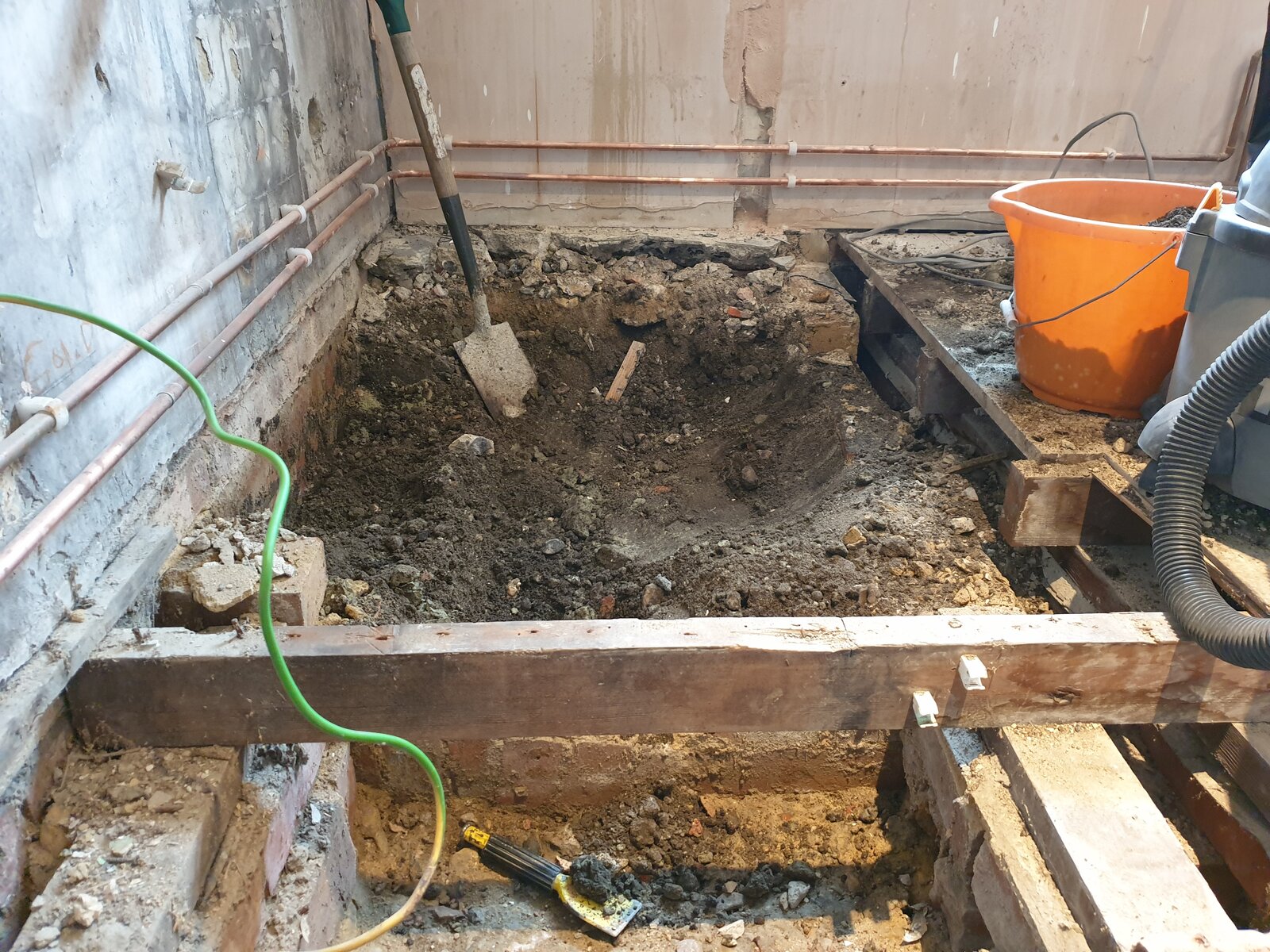

Hi all,
I'm replacing a lot of broken floorboards in my kitchen and in one corner of the room there is a concrete block measuring about 1m2 which is rasied above the floor level.
In my wisdom I removed the concrete only to find that its filled with soil. Theres no bottom to it, I hoped that it would have a concrete bottom layer like the rest of the void but it hasnt, its just soil
I am ok to leave the soil exposed or should i cover it somehow?
I am planning on running new joist to the wall to support the new floorboards above there the soil it
see pictures, hope you can help, cheers :)

OP,
you have a suspended floor, and your idea for continuing the suspended floor is a good idea. That way you will have the possibility of air flow under all the floor, and equal level floor boards.
No need for a new support wall - your new plastic wrapped joist tails can rest in pockets cut out of the brickwork.
Remove all the soil and concrete and brick remnants down to the surrounding soil level
and then lay a membrane on the soil (with a 50mm layer of concrete on top of the membrane for belt & braces if you think it necessary).
Do you have any air bricks - you need air bricks to provide ventilation under the suspended floor.
The left hand support wall is also blocking free ventilation as is the next (superfluous?) support wall.
Perhaps a lack of ventilation has caused the damp staining (condensation?) to be seen on the joists?
Pics showing outside the kitchen at ground level would show any air bricks?
Thanks Tel,

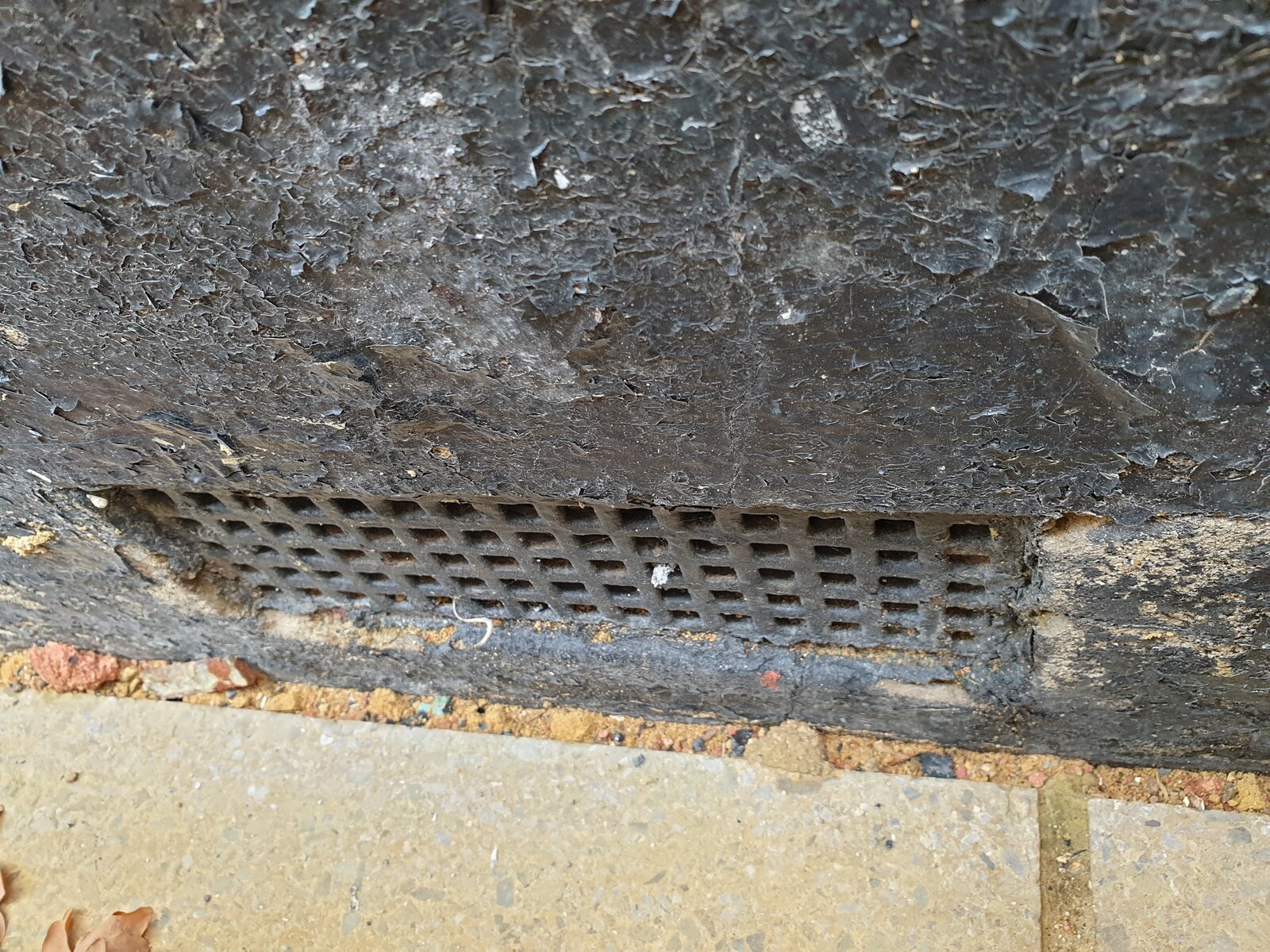

Ive had most of the floorboards up and have been clearing all the rubble and clearing the air bricks, I did find an air brick bottom left of the picture that was completely blocked, now cleared and can feel the air moving.
the gap between left hand wall support and the outside wall is blocked with rubble, which I have been clearing as i've gone along
Another question, how difficult is it to cut pockets in the brickwork, I presume you cut a hole, wrap the joist tail in plastic and fill with mortar?
Many thanks
Hi, why not post a pic of where you are now up to - & the external pics?
Its simple to cut pockets with a brick chisel and hammer ( gloves and glasses) or even a masonry disc in a small angle grinder will bite in 30mm or so - the pockets only have to be the rough joist section size say 75mm deep.
Only use semi-dry sand and cement - with, if available, bits of slate as packings.
Clearing the gap is good - no timber should be in contact with masonry or soil without DPC protection.
As you work probe joistings for soft possibly rotting areas.
Think ahead at this stage for any pipes or cables you want to run under the floorboards.
Dont hesitate to ask for any further advice.

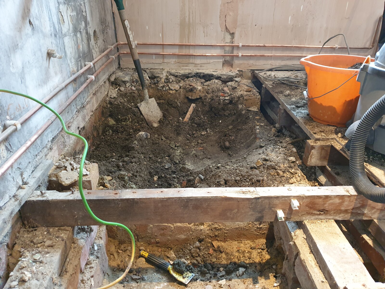

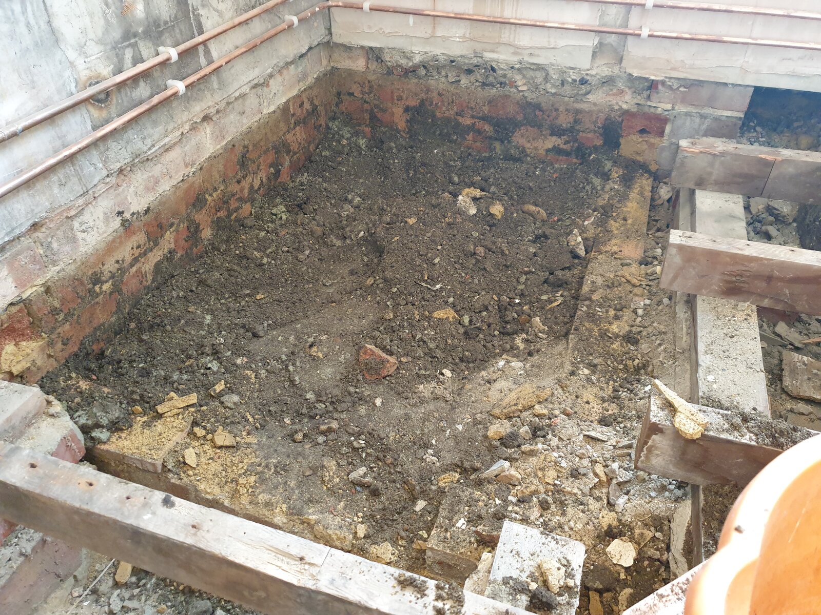

not much progress I'm afraid, have fmily commitments also.

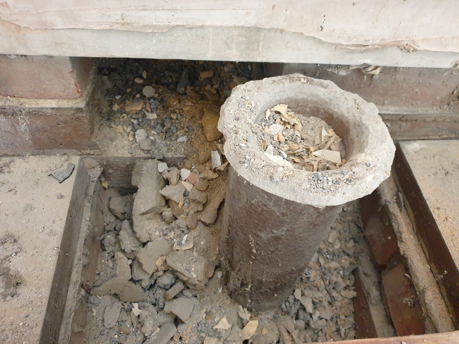

Heres some more pictures, I've got about 1 1/2 brick depth to dig out yet

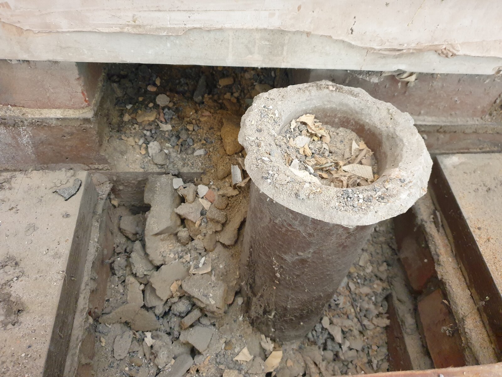

I've a soil pipe that i need to lower, whats the best way to approach this, cut it down and fill somehow?

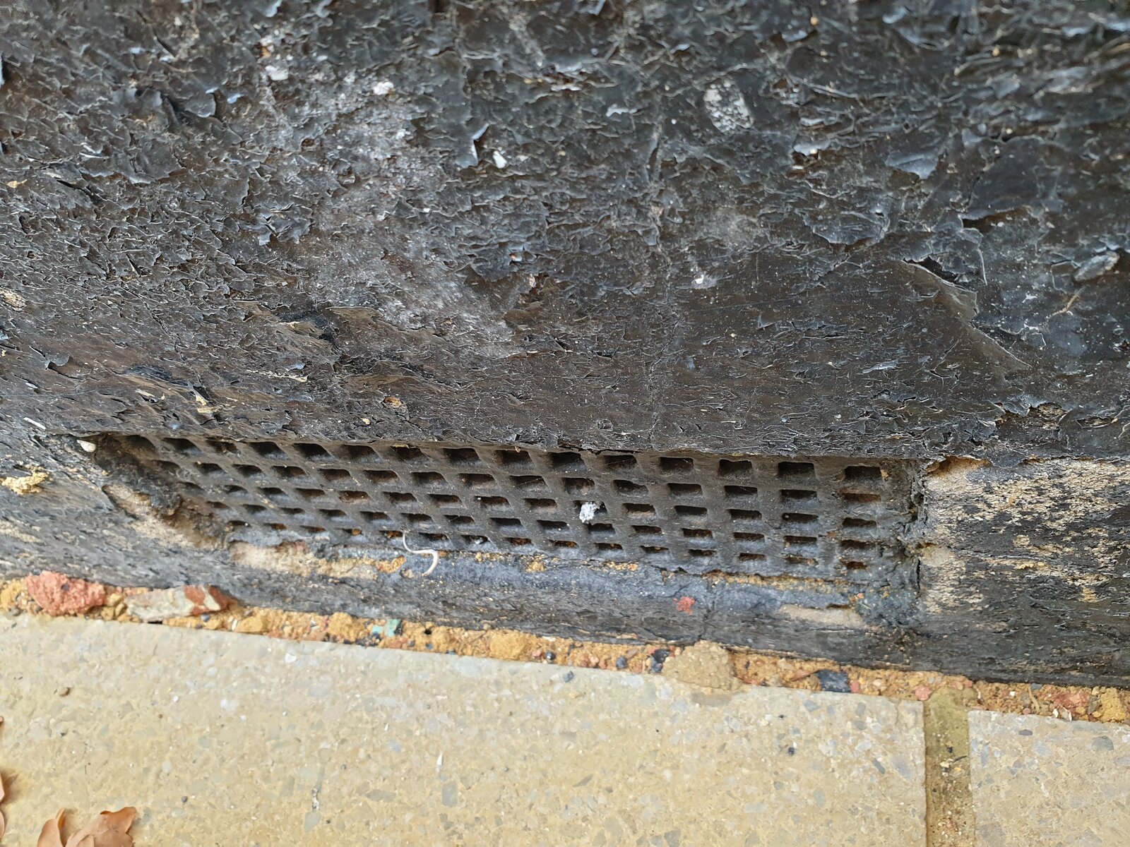

The photo of the airbrick is the one next to the soil pipe, its not quite at ground level due the the patio
Thanks for your help / advice so far !

Thanks for the last pics - one showing the whole room would also help?
Cutting the, what seems to be a clay pipe is straight forward enough if you have (or hire) an angle grinder and a stone disc?
You then measure the OD and get a pipe cap to seal off & prevent fumes or rodents.
Dont attempt to "fill it" - cap it.
Air bricks are not supposed to be at ground level - they should be at least one brick course off the ground - and set between joists opposite a joist bay.
Best practice has air bricks sat on the DPC.
