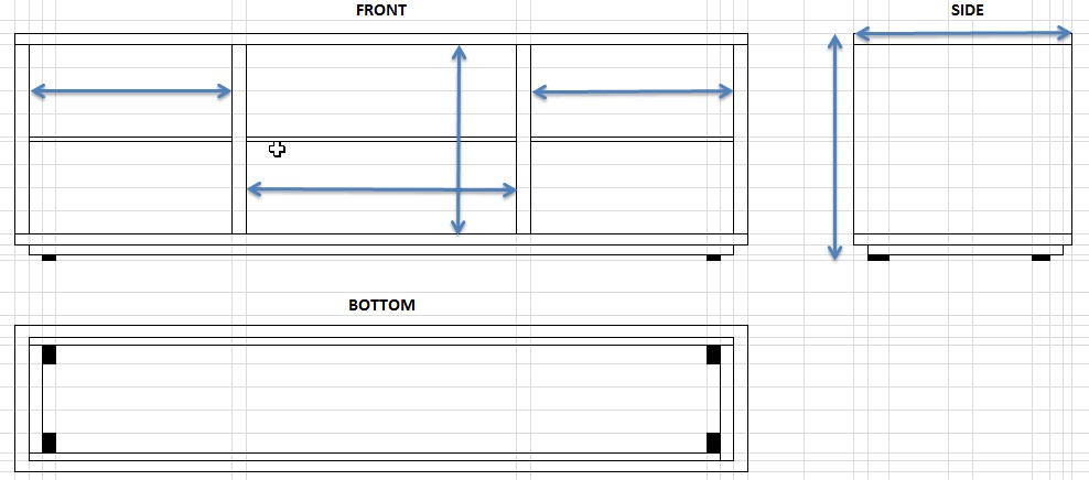

Hi all,
I am trying to make a TV stand out of Birch plywood since I simply can't find the size and design I am after.
I did a sketch (similar to one attached) quoted price was way more than I am prepared to pay. So I have decided to try building one myself since the worst that can happen is £150 of material wastage or TV falling off a wonky TV stand.
The plywood supplier will be cutting the main bits I need to exact sizes free which makes things easier. I should be able to get hold of a circular saw, biscuit joiner ..... for my experiment.
1) Should I use 18mm or 25mm ply?. just wondering if the extra thickness adds to the rigidity
2) Is the Biscuit join the easiest way of joining the wood together?.
3) what is the best wood glue to use?
4) Should the sanding of the ply be done before or after construction?
Cheers

I would use mdf for that design, ply will look awful if you can't get clean cuts. Is it to be painted? If it goes wrong it's only a sheet or so of mdf at less than £20 a sheet.

You haven't said what the dimensions are, but I will guess the vertical supports are less than 24 inches apart. That's close enough that 18mm material is plenty thick enough. Any extra would be for decorative purposes only.
Easiest joints are probably dowel rather than biscuit. No special tools necessary.
Any general purpose PVA wood glue will do.
I have used birch ply before and it looks nice when the edges are sanded good and smooth, and varnished. I've also veneered ply edges before, which is not difficult.
Length 1380 mm
Depth 4900mm
Height 5200mm
Internal vertical width are 3900 + 5000 + 3900
There is a jump in price between 18mm and 25mm ply so would prefer not to go higher if it is makes no structural difference for it intended use.
opp's
Length 1380 mm
Depth 490mm
Height 520mm
Internal vertical width are 390 + 500 + 390
