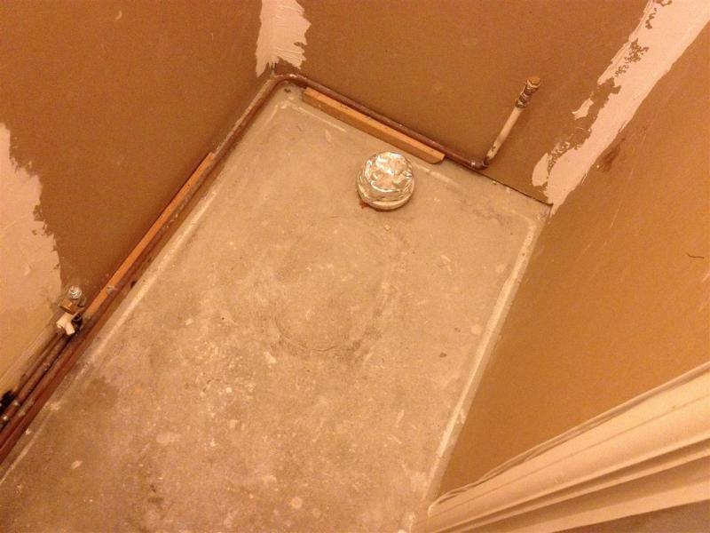

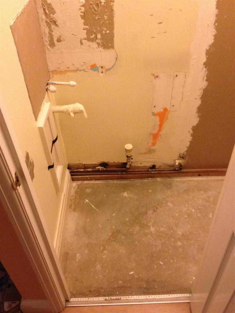

I have completely stripped my cloakroom and about to put in new wall & floor tiles, radiator wc, basin....
Unfortunately I have surface running water pipes, which cannot be buried within the plasterboard walls.... I probably would not even want to do that because that will be way outside my DIY skills to be cutting pipes and walls!
So I am trying to get consensus on what should be done with the pipes in relation to how I am going to lay the wall tiles. The existing pipe work runs almost at floor level on two walls to feed radiator and toilet cistern. My Original Cloakroom had the pipes boxed and there were no previous wall/floor tiles either ... just painted pasterboard walls
Please see attached pictures to have an idea what I am talking about.

So should I (if possible): -
(1) Tile all the way down from floor level behind the pipes shown in the picture.
Then Skirting to box the pipe in. I guess advantage to this method is I can tile quicker and worry about boxing later on...
ps. do I need to leave some gap between the floor and the wall tiles? I am going to be laying floor tiles as well
OR
(2) Box the pipes in again with skirting board size box (similar to previous) and the Start Tilling on top of the skirting board

I'm assuming you're putting in a new loo so my first thought is where is you loo going to finish in relation to the back wall? You don't want to have to build it out to support the cistern if you can help it. If it's going to want building out, best bet is to bring the whole wall forward and lose the pipe behind it.
If you're going to do that, then it's not a big job to drop the radiator wall (or at least the bottom half) and get those pipes moved back into it. That way you can do away with boxing in.

coo - consider cutting the copper pipes where they come out the wall and fit chrome inspection valves and chrome pipe collars. Tile the room as appropriate (remember you now have no pipes in the way) all the way to the floor. Then re-pipe all in chrome supported by chrome 'hospital brackets', also known as munsen brackets ... in other words make a FEATURE of the chrome pipes over the tiles. It'll look great! Oh, and use small white tiles.
Coo; to be blunt I would advise a complete rethink & get someone in who can re-plumb as necessary so it can be done properly. Believe me, it’s going to look total crap & be prone to early failure!
I'm with Gcol and would go as far as fitting a back to wall or wall hung pan, that will loose all pipework and the pan connector on the short wall
The other wall you say the pipes cannot be lost into the wall, why? if its plasterboard you can gain 12mm by just removing the bottom strip of plasterboard, if you then overboard the wall down to the pipes with another sheet of plasterboard thats another 12mm gain giving you a 25mm gap to run the pipe in then let the tiles run over the top of the pipes, just don't get adhesive onto the pipes.
I used these methods in this WC, the wall below the basin shelf is actually 20mm out from teh wall above but you don't notice it.

This is a job above my skill so I have called someone who has agreed to do the work for labour cost of £850. I don't know if thats too much considering the room is bare as in the pics.
He said he will bury the pipework in the wall. I asked him about a back to wall pan instead of close coupled and he said that will result in moving the pan forward to build a partition to enclose the cistern bits ......

Fitter came round on the weekend and did the plumbing, hiding pipework and even moved the waste pipe as at no extra cost. So expecting the tiler this week to do his bits ...
Some parts of the plasterboard walls have one or two layers of paint over the last couple of years and the replaced plasterboard sections are just bare as in the pics.
