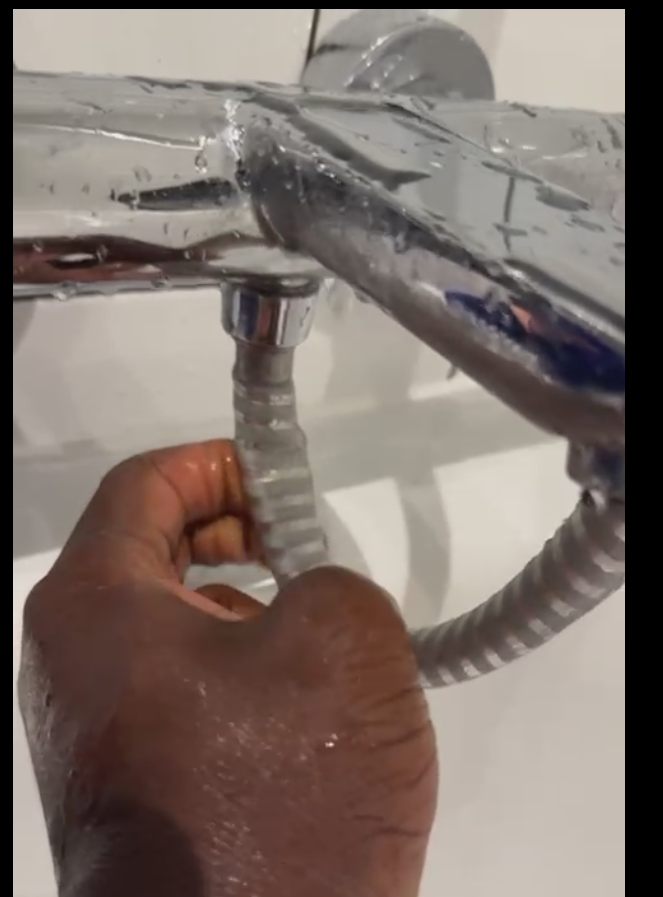

Advice needed on bathroom shower hose leak
5 Oct 2024
Check rubber is inside.
It's a thick black rubber.
I have had to fit two rubbers in the the past to pack out because of size fitting differences and it not tightening up enough and leaking like your video.
DIY stores sell the rubbers
