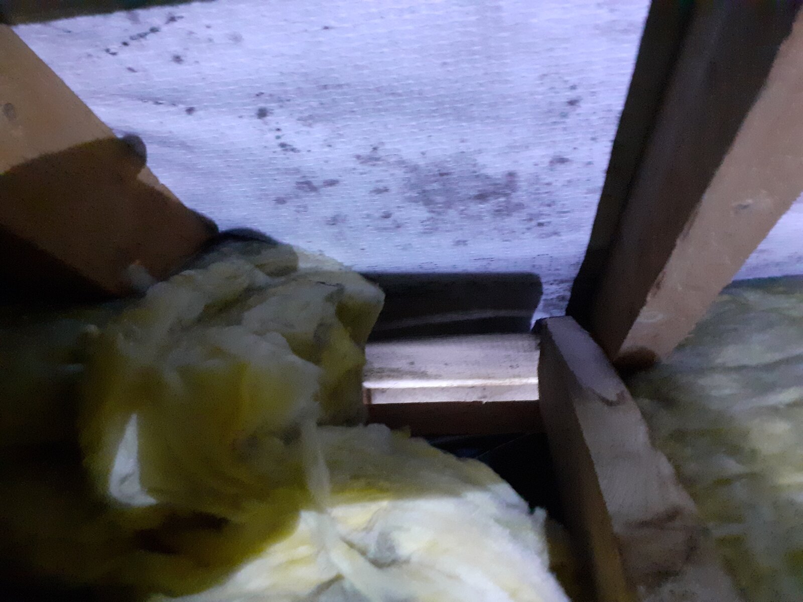

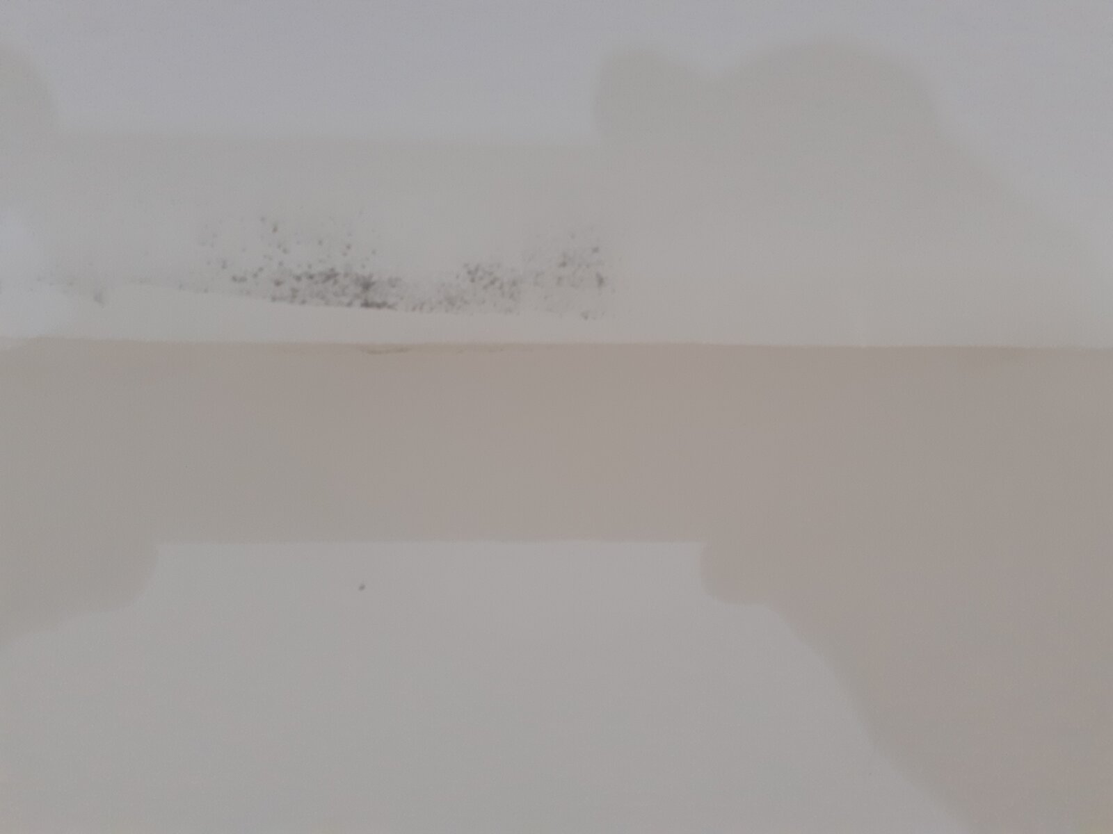

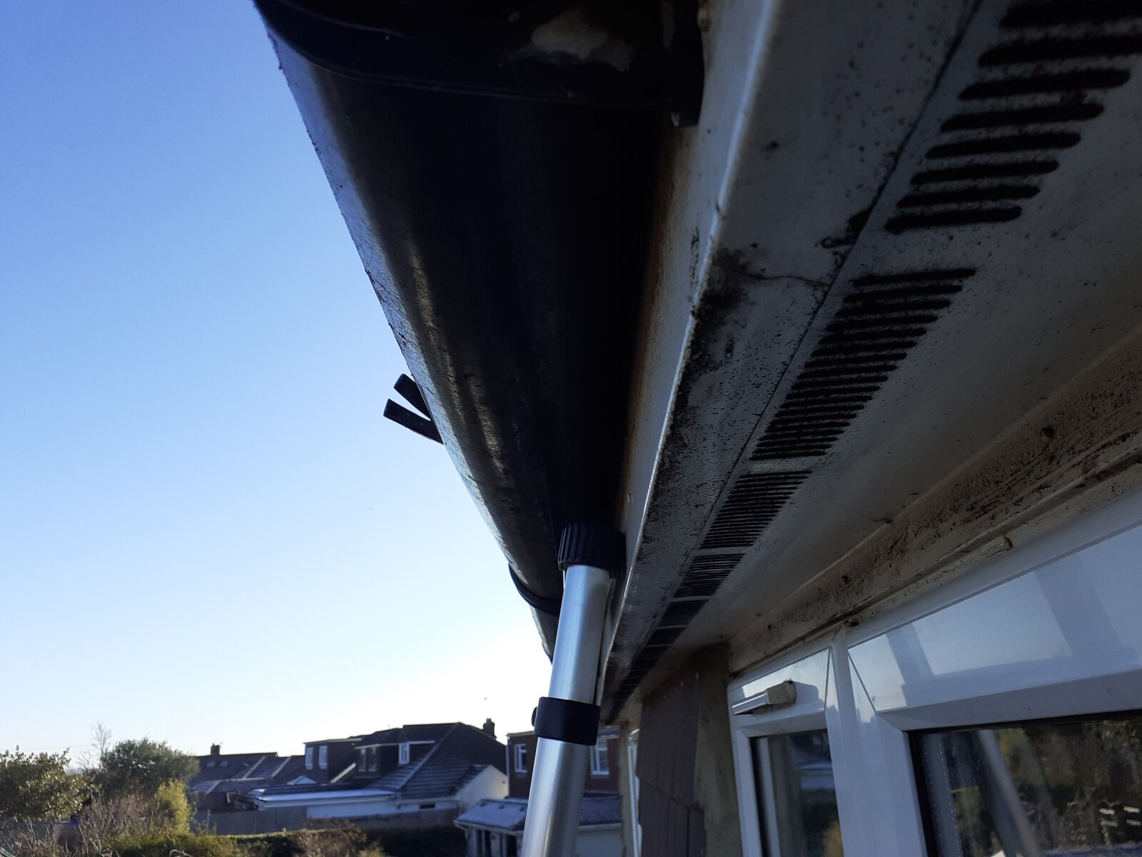

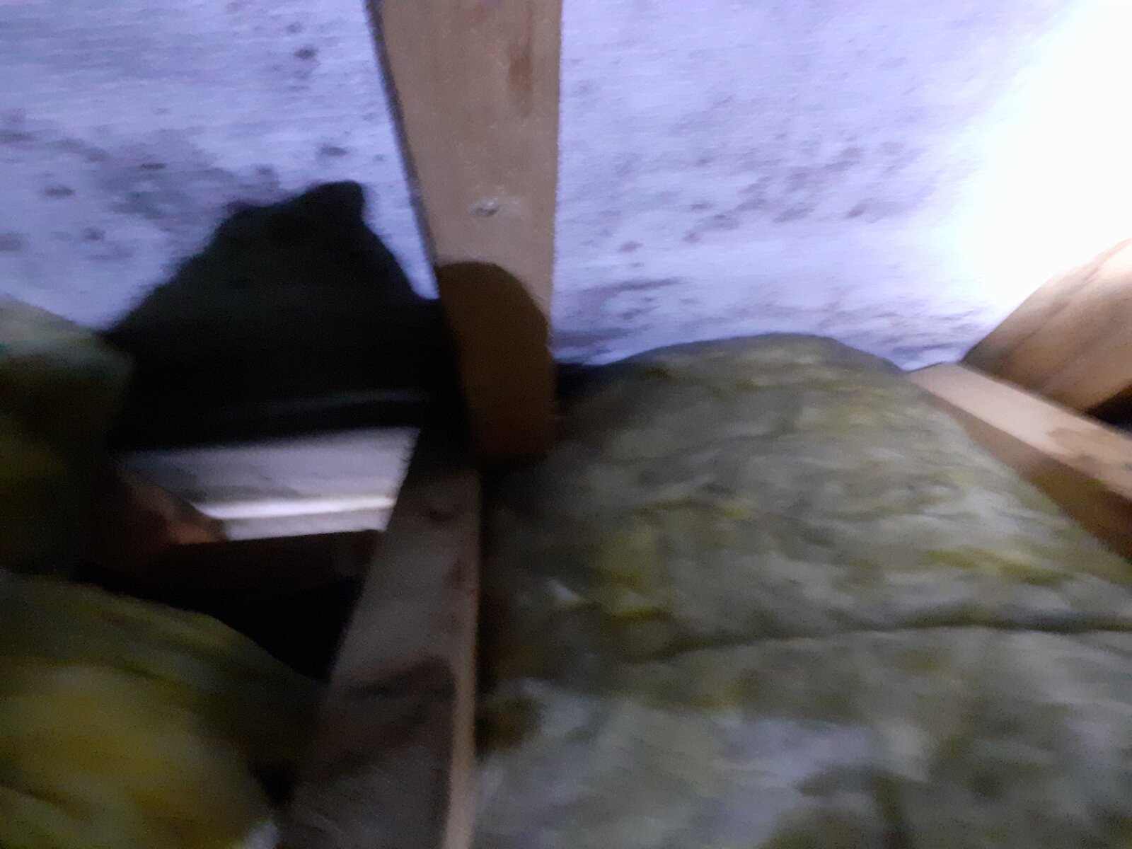

Hello,
We have a bungalow with a dormer roof which has vented soffits (image attached) in cold weather the soffits allow cold air into the roof so the edges of the ceiling are colder and moisture condenses on these cold areas which leads to mould (image attached). I have recently fitted a loft hatch to allow access to the roof space and have seen that there is a membrane on the top side of the plaster board ceiling which seals the moisture in. There is insulation in the roof which has been pushed out to the roof which I assume prevents ventilation which the soffits are intended to provide.
My question is what can I do to prevent moisture condensation at the ceiling edges? Do I actually need ventilated soffits can I cover most of them with insulation and use something like this in a few sections
Roll Panel Vents | Manthorpe
Keep the soffit vents uncovered.
Covering them up could lead to some bigger problems in your roof structure, than a bit of mould on the ceiling.
Personally, I have used these:
They are far easier to cut to size and push into the eaves than the roll.
And then I stuffed as much insulation as I could, underneath them.
Thanks for your advice I have ordered some of those roof vents (400mm) for 16 inch beams.
