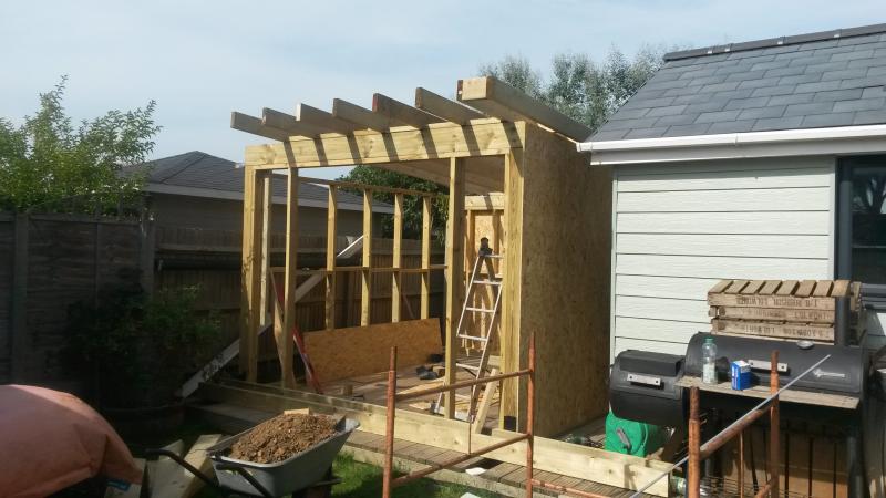

Ive built a garden office on top of a decking area I have behind my house and in order to get some head room ive made the front a bit higher than I guess I should of! The back of the building is
2m 20cm from the eaves to the decking
2m 35cm from the decking to the top of the roof
The front of the building is
2m 45cm from the decking to the eaves
2m 60 cm from the decking to the top of the roof
bare in mind the decking is 20cm from the grass
So the front of my roof is 2.8m total from ground level
My garden backs on to 2 other gardens, in one of them (neighbour 1) has a log cabin that is 1m away from my fence, the walls of the cabin are about 2.2m but the point of the roof is about 3m high. The second garden (neighbour 2) belongs to a man who is a pain in the arse and was the only person to object when i applied for planning on an extension I did 2 years ago
both the neighbours gardens are pretty big and there house are at the other end from mine,my house is tiny hence why i want to add the extra office room
it feels a bit like a game of chess as if the grumpy neighbour 2 complains then i can complain about the log cabin in neighbor 1s garden
What would other people do? apply for planning or just let it be and see what happens?
