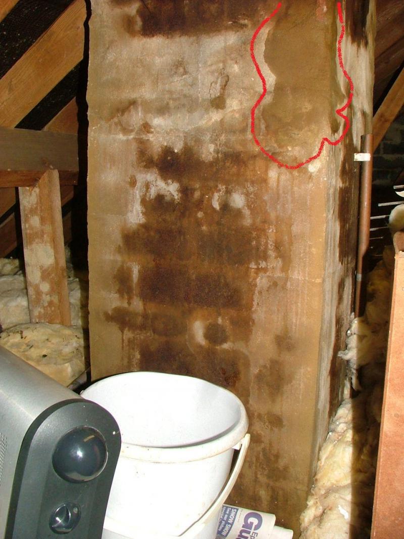

When it is raining I am seeing some dampness on the surface of the chimney in the loft. I've circled the problem areas in the picture below. These areas are damp to the touch and some moisture is visible (it seems to be running down the white marks).
The blue arrow shows where I can see a little bit of daylight through the roof. I can't see any rain coming through here though.
The other side of the chimney seems to be dry.

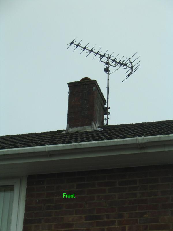

I have also taken some pictures from outside (from ground level - I don't have any ladders). These show the same side of the chimney from the back:
and front:

the staining to the chimney pargeting looks consistent with seepage staining.
i wouldn't be surprised if the flashings were intact but the brickwork maybe needs re-pointing.
there may no dpc either.

Well, as difficult as taking the chimney down to the required level, putting in a DPC then rebuilding the chimney, not so much difficult as expensive. As the chimney isn't that tall (being at the ridge line) it would prob be best as noseall says to repoint and maybe coat with a silicon based waterproofing paint.

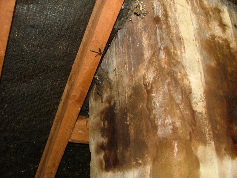

Hi, Phil, here's my story below - looks just like yours, same size stack, but much more staining and water ingress. I'd be interested to know what came of yours
About a year ago, I noticed streaks of moisture, wet to the touch, coming down from where my single flue chimney stack goes through the roof (about 2 tiles down from the apex). A reputable roofing company replaced the flashing (£350), but the problem persisted and got worse. Soot and tar contaminated water was running down the faces of the stack in the loft. The chimney was wrapped in a tarpaulin as an emergency measure and I contacted 4 builders. The consensus was that the damp proof course had failed.
Small damp patches had started to appear on the chimney breast in the bedroom near the ceiling. I decided to stop using the stove for the time being. I also waited for the bedroom stained areas to dry and redecorated after painting the whole chimney breast with Zinsser BIN.
The whole chimney was rebuilt above roof level (£1,700), this time with two damp proof courses and with council building control checking the work.

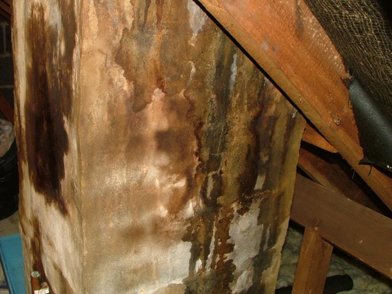

Needless to say, 7 months later, I am now faced with leaking flashing again and the builder has been called back under the guarantee. At least this time the water is clear. I have a few questions
a) I would like to keep my wood burner, but am loosing the will to persist. I have heard mentioned, that once a chimney starts to leak, its best to have the whole thing removed?
b) I have test drilled the stack where heavily stained and the brick under the rendering appears dry and uncontaminated. Can I assume the the staining is surface only?
c) During heavy rain (before the current leaks appeared) and when the moisture content of the air is high, I have noticed that the stained areas become damp to the touch. Is this normal?
d) I have been told that the stove and chimney would benefit from a chimney liner, back filled with vermiculite. Is this a good idea?
