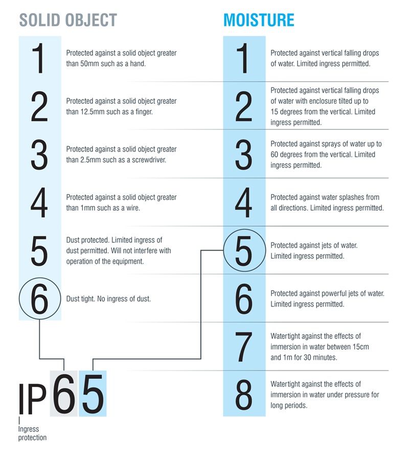

For underground use, any IP rating is mostly irrelevant. Water will get in due to pressure differences between the enclosure and the outside environment.
There are only two ways of long lasting outdoor installations.
1 - drain holes so that water doesn't build up inside the enclosure. This is why most outside lights are rated IP44.
2 - a totally filled enclosure, so that there is no air space for any water to enter. Raytech magic gel, epoxy resin or similar.
For anything buried underground, 2 is the only viable option.

Gel filled jointing boxes can fail (allowing moisture to reach the conductors ) at very low water pressure ( less than a metre depth ). Resin encapsulation is the only reliable way for underground jointing in damp or moist ground.
It depends on the amount and depth of the water and the time the water is fluid in the ground
IP67 is water tight when immersed in water upto 1 metre deep for short periods
IP68 is water tight when immersed in water under pressure for long periods
Even resin absorbs water over time.
Hopefully only after I no longer need a mains connection from the supply cable in the street.
The best option for 230 volts in the garden is to have all junctions above ground level ( or predicted flood level if higher ).
It is far safer to use ELV ( such as 12 volts ) unless one has the money to invest in highly reliable underground joint boxes.
