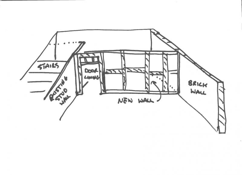

I am going to build an internal stud wall to divide my living room up into a living room and kitchen/diner and would appreciate a sense check on what I am doing!
I plan to build a partition fitted between a solid brick wall on one side and an existing stud wall (where the staircase runs) on the other. Here's what I plan to use:
1) 75 x 50mm timber for studs, with 600mm centres for noggins.
2) 12.5mm plasterboard
3) 108mm door lining
Does that sound sensible?
I was hoping to not plaster the wall (just cover gaps and paint), but that will leave the door frame standing about 8 mm proud, by my calculations. What would people do here? Plane down the door frame before fitting architrave?
Also - where the stud wall meets the existing stud wall, I was planning to fix it by screwing at the top and bottom (where the existing sole and header plates are) and then one screw about 3 foot up where I have found a noggin. Is that sufficient? I want to hang the new door on that side so am a bit worried that it will not not stable enough....
I've already lifted the floor boards upstairs and put in noggins for the new header plate, so that is all sorted.
I would appreciate any advice and a sense check before I commit to building!
I've scanned in a quick sketch of what I am planning for clarity.
Cheers!
Chris
