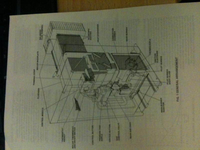

I'm not about to take the boiler apart, but suspect that this isn't normal. I assume that it's a problem with the heat exchanger, but could do with some advice before I get a heating engineer out to look at it or try and sell me a new boiler. It's an old boiler, but here's the schematic of it in case that helps anyone.
Boiler thermostat is set it 4 (close to max). I haven't sat in front of the boiler for a long time but I haven't seen the boiler flames go off full all evening (front of boiler is off at the moment).
It's a potterton kingfisher RS50. Thermostat settings are min 1 2 3 4 max
