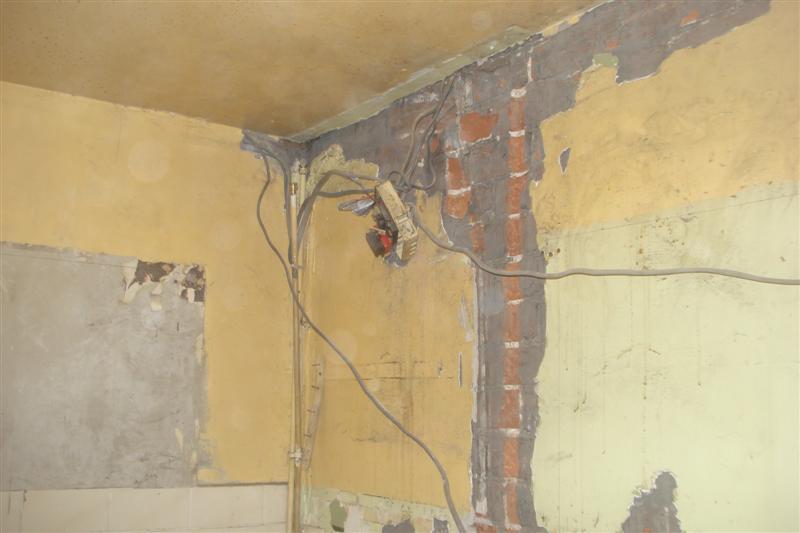

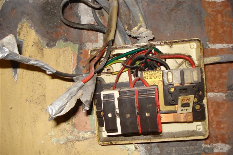

I have been removing a wall in my house and need advice on what to do with the existing consumer units and wiring.
hopefully from the pictures you can see the kitchen supply that is fed from another consumer unit upstairs (sorry no picture)
Would it be best to remove this extra kitchen breaker and rewire them up to the main board ( I will be buying a new consumer unit with MCB's) if so is it best to run brand new cables to the new unit or is it acceptable to crimp some of them? The assocaited wiring connects to a cooker, ring main and lights. I want the job done properly so whatever is best practice.
I am going to buy some supplies so when my qualified electrician friend comes round to help I have everything I need (I will be helping in labouring capacity)
Can someone point me in the right direction of type of consumer unit and cabling I was thinking a decent roll of 2.5m for ring mains, 6mm for the cooker and 2 and 3 core for any extra lights and switches I may fit?(I get staff discount at electrical supplies). Its a fairly large 3 bedroom Victorian detached house. I plan on adding to the existing circuits i.e outside lights and in the future power to double garage.
What do you reckon? Thanks

That is a sub cu and depending on how far that is to the location of the main cu might cause some headaches if you was to pull through all new cables from the kitchen to the main cu. If the distance is like 40m or so as I have seen in some large houses to the main cu a sub main will work out better and this way the kitchen will be on its own cu.
SWA should be used to feed this cu. I cannot give you any more information on size, as this depends on earthing requirements and this depends on the supply type. Can we have a photo of the main cu and cut out? (suppliers meter, cutout and cu all in one photo would be nice)
This sub cu I would use metal clad if possible and use RCBOs on each circuit. The only make cu I recommend are Hager for an all RCBO install. SWA from the main cu to the sub cu. You could get away from RCBOs (cables need to be > 50mm depth in the walls) by using galv ducting to protect the t+e.
I am not going to do the whole design for you and the maths as your spark has to do that as he has to sign he has done the design and testing and inspection.
And as you are going to be going down to brick there is no point extending cables. Do it correctly and replace the lot.

I have recently bought a fairly big victorian house that is detached and rural.
and judging by the other photos is in pretty poor decorative order even where you aren't doing structural work, and is going to be having plumbing mods done as well.
There will never be a better time to do a complete rewire - don't f*rt around fiddling with this sub-CU, replace the main one with all RCBOs, or 3 or 4 separate sections, one of which just has a switch incomer, have plenty of spare ways for future expansion, cables in conduit for ease of future changes (steel conduit if you want to avoid RCD'ing the lights), priority circuits through a changeover switch so you can use a generator if you want, mains powered smoke/heat/fire detectors.....
