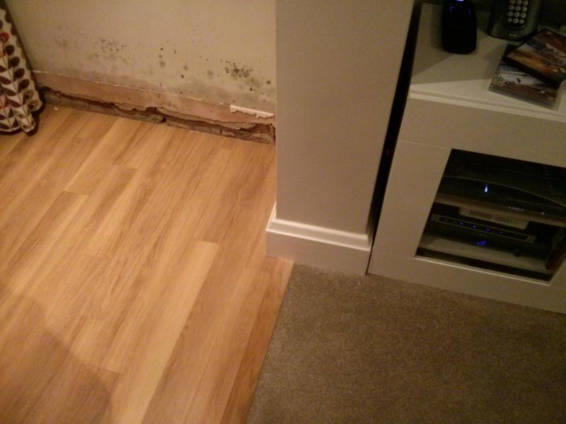

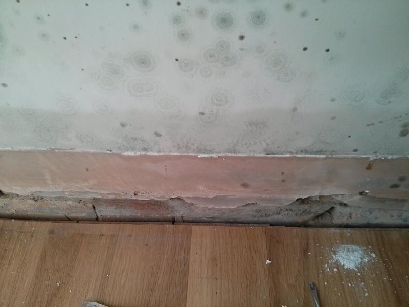

Hi all,
I'm looking for a bit of advice on a damp problem in my lounge.
I've posted some pictures below to show the issue. Basically over the past couple of months damp/mould has rapidly appeared in the corner of my lounge. This is under a large window and adjacent to patio doors. Earlier this year I did a lot of work in the lounge including the removal of a small radiator in this area. So initially I suspected it might be condensation on a cold wall causing this, but there just seems to be too much damp for it to be that.
Anyway I’ve taken the skirting board off and as you can see and the bricks themselves appear dry on the inside. However the plaster is wet. I suspect that water is coming into the brickwork from the outside, so I’ve also posted some pictures of the same wall outside. As you can see the mortar on some of damp course appears poor, and could probably do with re-doing. The seal around the window appears sound (this was also replaced earlier in the year). So I’m not really sure what’s going on. As you can also see there is a air brick which goes through to under the floor.
Thoughts welcome on what to do next. Thanks.
P.S. 1930's house with very little cavity between the bricks.

Thanks for the replies.
I’ve not seen the DPC but I’ll see if I can have a closer look.
The floor is Amtico so can’t come up now that it’s down. The problem area is in a small extended area of the lounge. The main lounge is carpeted. There is a hatch in the floor just in front of that TV cabinet where I can get into the floor cavity (see pic below). However there is a wall under the floor which prevents me getting proper access to the damp area, although I could possibly see it through a gap in the under floor wall.
I thought the same about the patio. It’s been extremely wet recently and it might be a case of water sitting against that outer wall has made it’s way in.
The wall is definitely two bricks thick with little gap. We’ve killed the mould once with the method suggested but it’s come back (as per the pictures) in a matter of only a couple of weeks.

By that definition I would describe it as a solid wall. Sorry I'm not hot on terminology. It is basically two bricks thick with at best a half inch gap between. The bricks are turned 90 degrees every so often to join the skins (presumably this is what you're calling headers). I've bricked/blocked a window up on the opposite side of the extension so I've seen it myself.
I'm not sure on an exact extension date. However there is no record of it being added, and it has the same roof tiles as the original roof. The original house was built in 1938 and planning records began in 1948. So I'd say somewhere in between those two dates. The street is full of these little extensions.

It is condensation occurring on the inside surface of a cold solid exterior wall. It is neither penetrating, nor rising damp, and is unlikely to affect the plaster seriously.
Your damp course of blue engineering bricks is (doing its job as a DPC, but also) preventing the moisture that has built up in the walls (from rain etc) from descending any further, and the evaporation occurring outside is chilling the bricks, creating a cold bridge on the lower wall. Being slightly recessed on the inside, that bit of the wall is not in a natural draught, so the air inside stagnates, cools and deposits moisture, encouraging mould growth. The same effect may be found in corners and behind furniture, or inside cupboards.
To remove the mould, the spores need to be sterilised. Diluted bleach will kill the mould, but will not sterilize the spores, which will regrow when conditions allow.
With a clean nylon paintbrush or mini-roller with disposable roller, use thick bleach undiluted, just lay the bleach on to a few inches above the current height of the mould, cover the area to the floor, and allow to dry. Do not use a natural bristle brush, or one that has any paint residue, and do not scrub the area you apply bleach to. The bleach will discolour then bleach the mould as it soaks in and dries.
Bleach is somewhat acid and should not affect most paints of vinyl, acrylic and polymer composition. (Bleach naturally gives up part of its chlorine as it dries, leaving behind sodium chloride - common salt - which will deter the establishment of moulds. The small amount of detergent in bleach will allow the bleach to penetrate where possible, at least to the extent that the mould penetrates.)
Treat the skirting with neat bleach in the same way and allow all to dry before re-fixing the skirting. Repeat the application of bleach, in situ, and again allow to dry.
Use a desktop fan (i.e. unheated) to increase ventilation in the area in cold and damp weather. Similar use of a fan will help prevent condensation on windows and frames, as will undiluted bleach to stop black mould in those areas, and on grout between tiling, etc.
The most effective preventative measure would be to provide some insulation and cladding to the full extent of the exterior wall, effectively providing cavity insulation, where none is provided by a solid brick construction. This will have long term positive effects regarding energy savings too.
