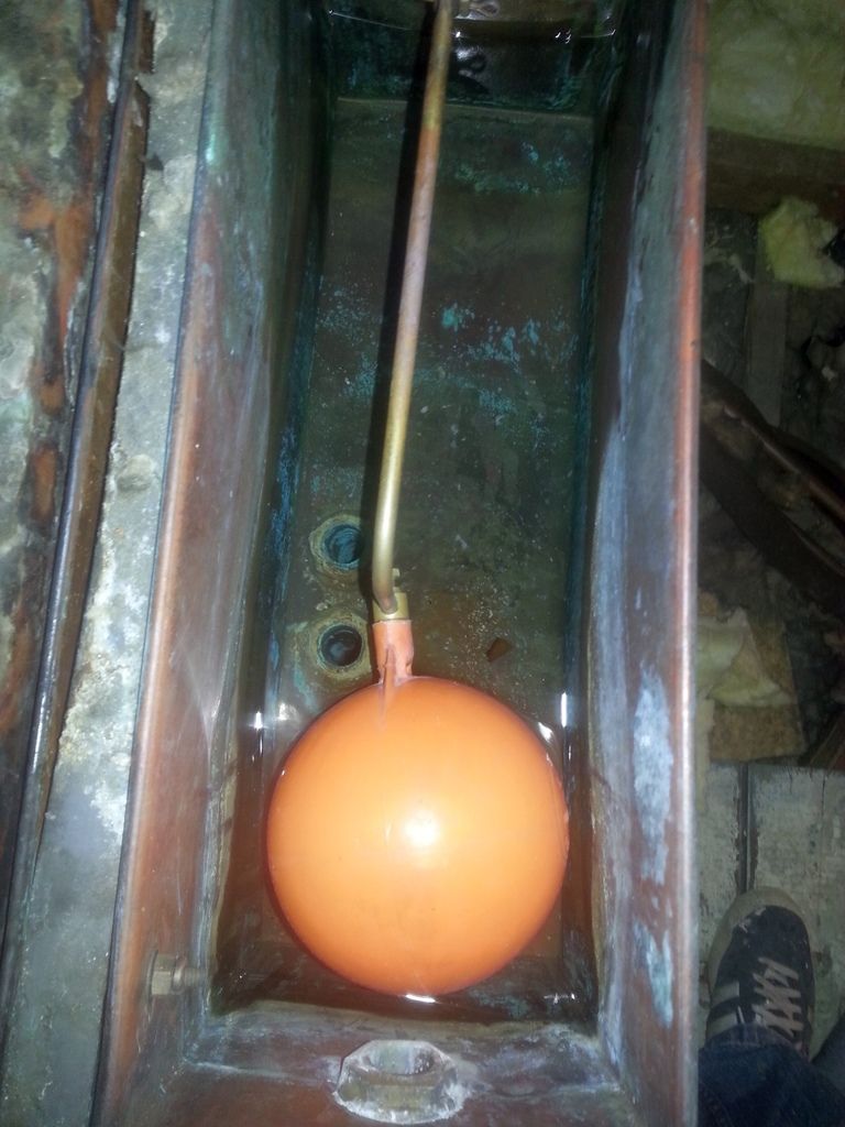

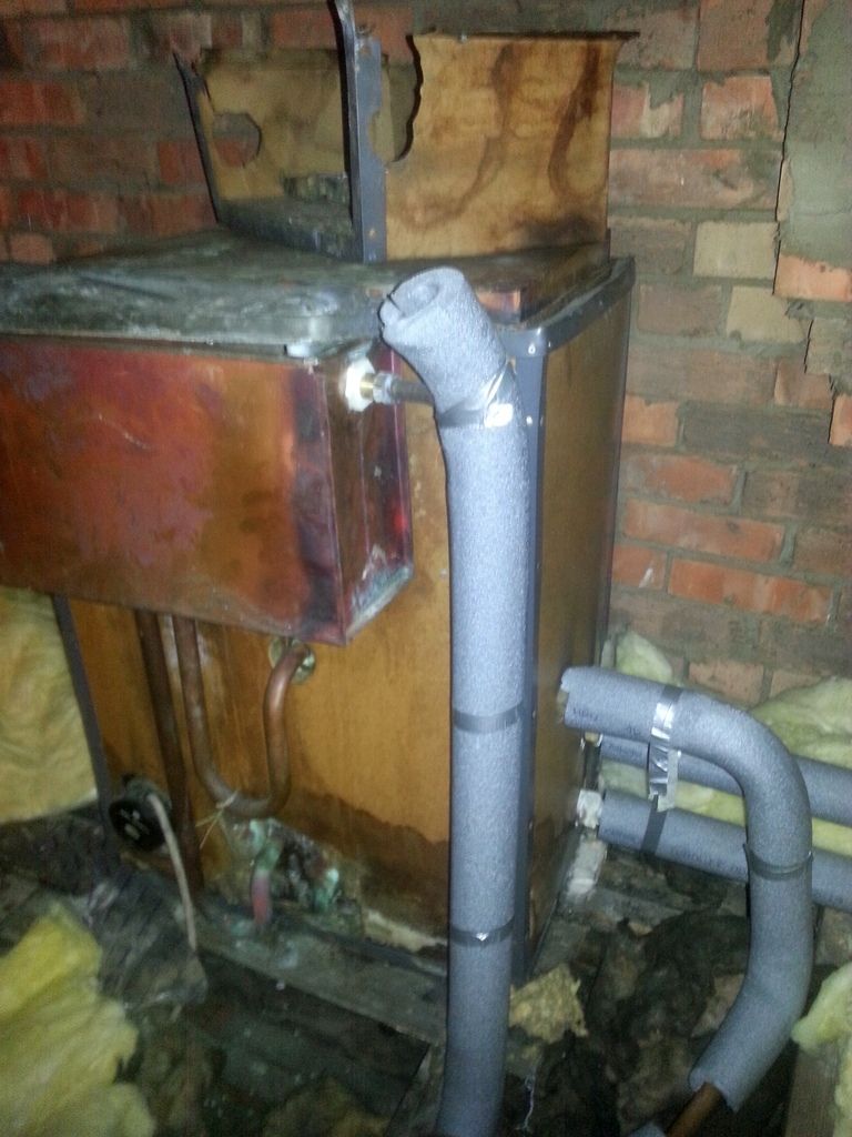

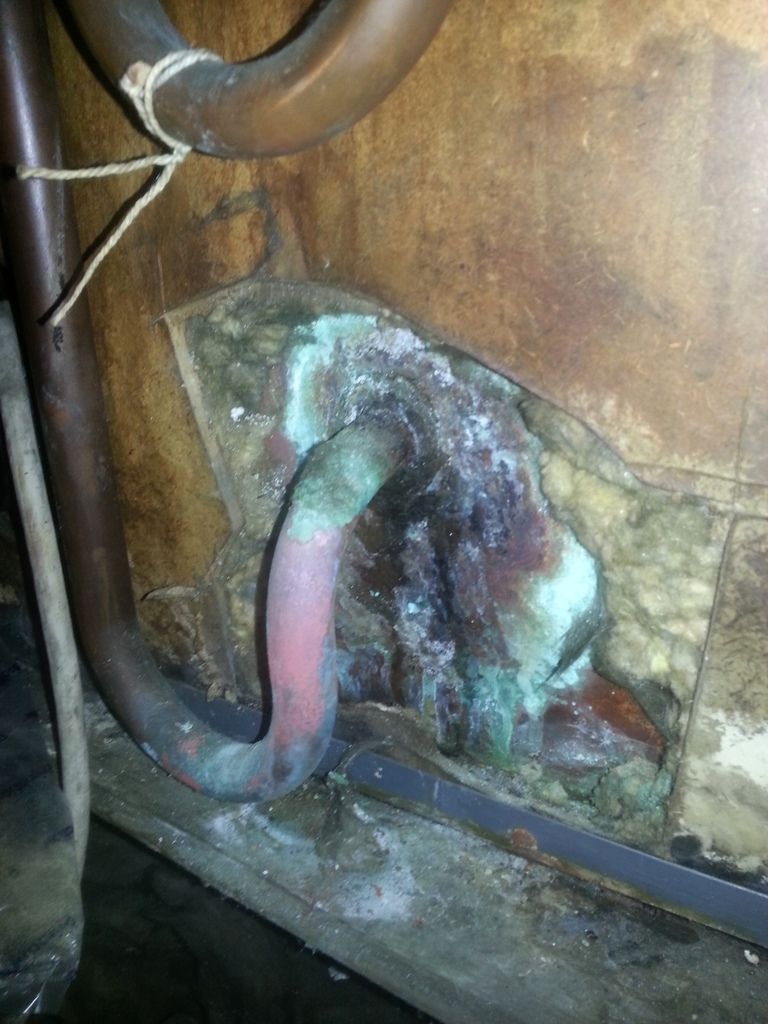

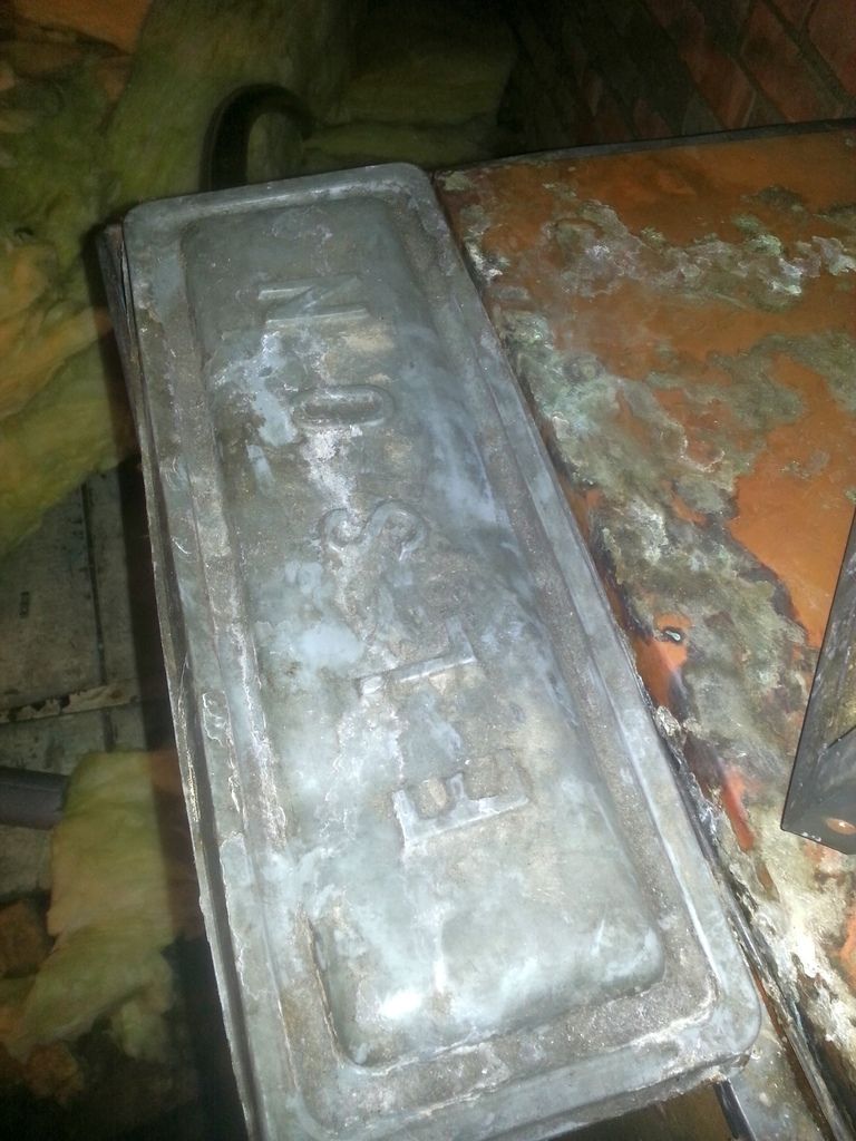

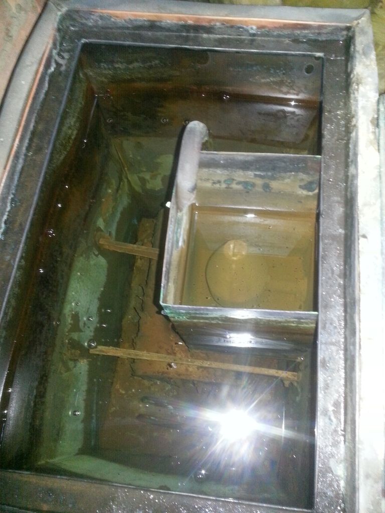

Hi all,
I have a very small leak from hot water tank in the loft, see below:
Tank:
The leak:
Elson Clue:
Hot side of tank:
Cold side of tank:
Possible putty/filler from inside around pipe connection:

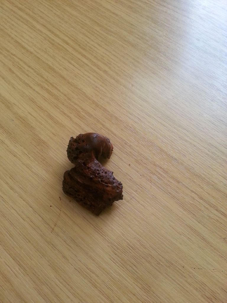

It look to me that the tank has leaked previously, the there was evidence on this when I was decorating the room below. It also appears that the previous owner used a putty/filler on the inside of the tank. The last photo shows what looks like filler to me, I pulled this out of the tank from around the pipe/tank wall joint.
Can anyone shed some light on the tank wall/pipe joint, as there doesnt feel like any kind of nut on the inside; outside reveals nothing.
I think the tank is likely on it last legs, however, what is my best leak stopping short term solution?
Regards,
G
That looks like a single feed indirect version - primatic for short. It's a store for both hot water and heating.
It won't be a particularly straightforward swap I'm afraid :(
The tank is life expired, and should have been replaced when it first started leaking.
The 'short term fix' is what the previous owner did - shove a load of sealant around the leaking part and hope it doesn't leak any more.
Like most temporary fixes, it was forgotten about and became permanent.
