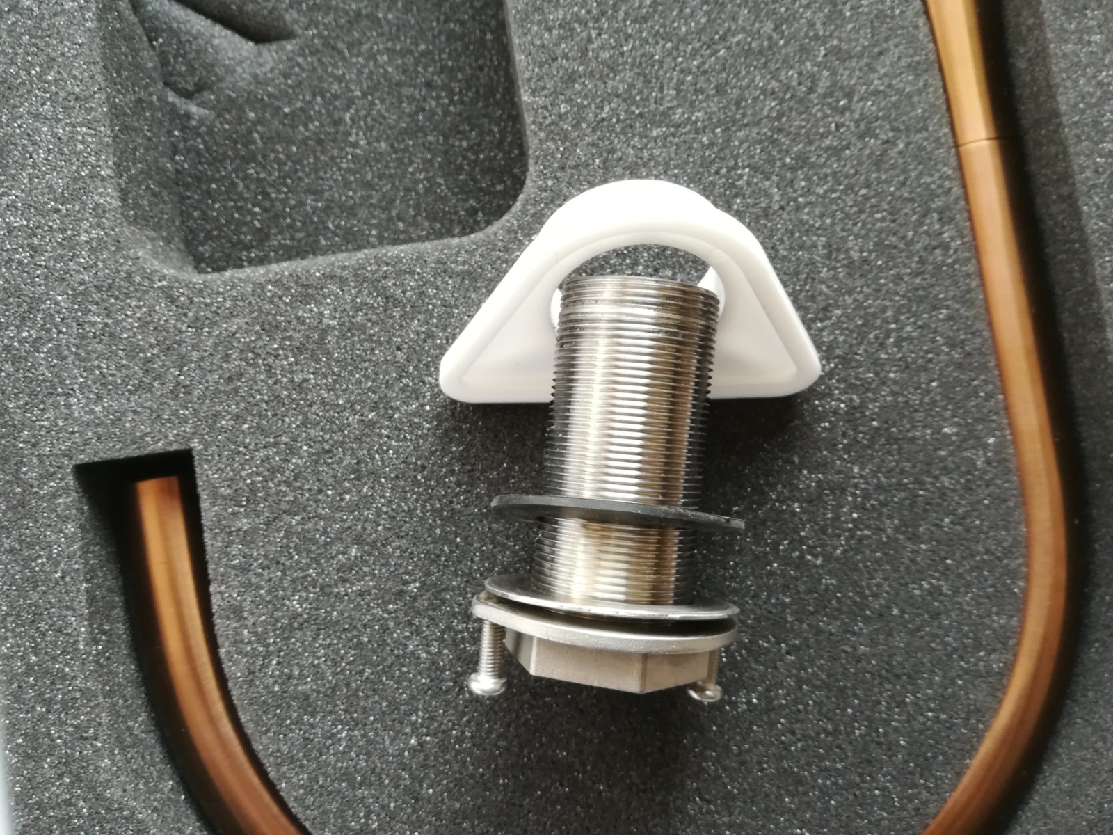

I'm currently trying to fit a new kitchen tap. I've never done this before. There is very little room to grip the back nut and get enough purchase to nip it up tight enough to make sure the tap doesn't swivel or move on the surface. I can't find a basin wrench or box spanner that would be big enough.
The instructions say to use all the fixings included, as set out in the picture below.
The worktop is quartz though, so do I really need the white tap support in the picture? I was thinking if I remove that I could tighten the nut to the surface of the worktop directly, and the two screws on it would grip the surface and hopefully stop the tap from moving. Given the hole is just big enough for the thread to go through and the worktop is solid, a support bracket might be overkill?

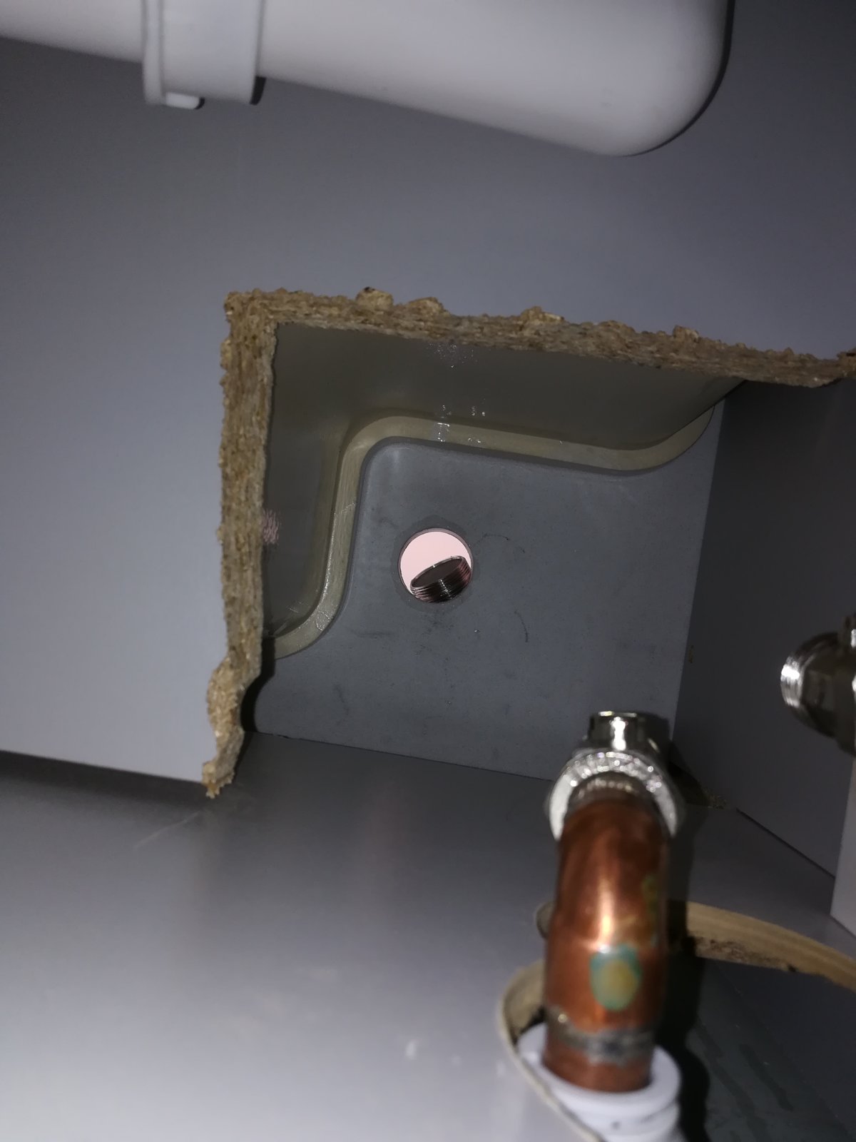

The sink was fitted first as it needed to be secured for the quartz worktop to templated/fitted. There is a hole cut out on the shelf the sink sits on for access to the tap area.
Here are some pics to get a better idea

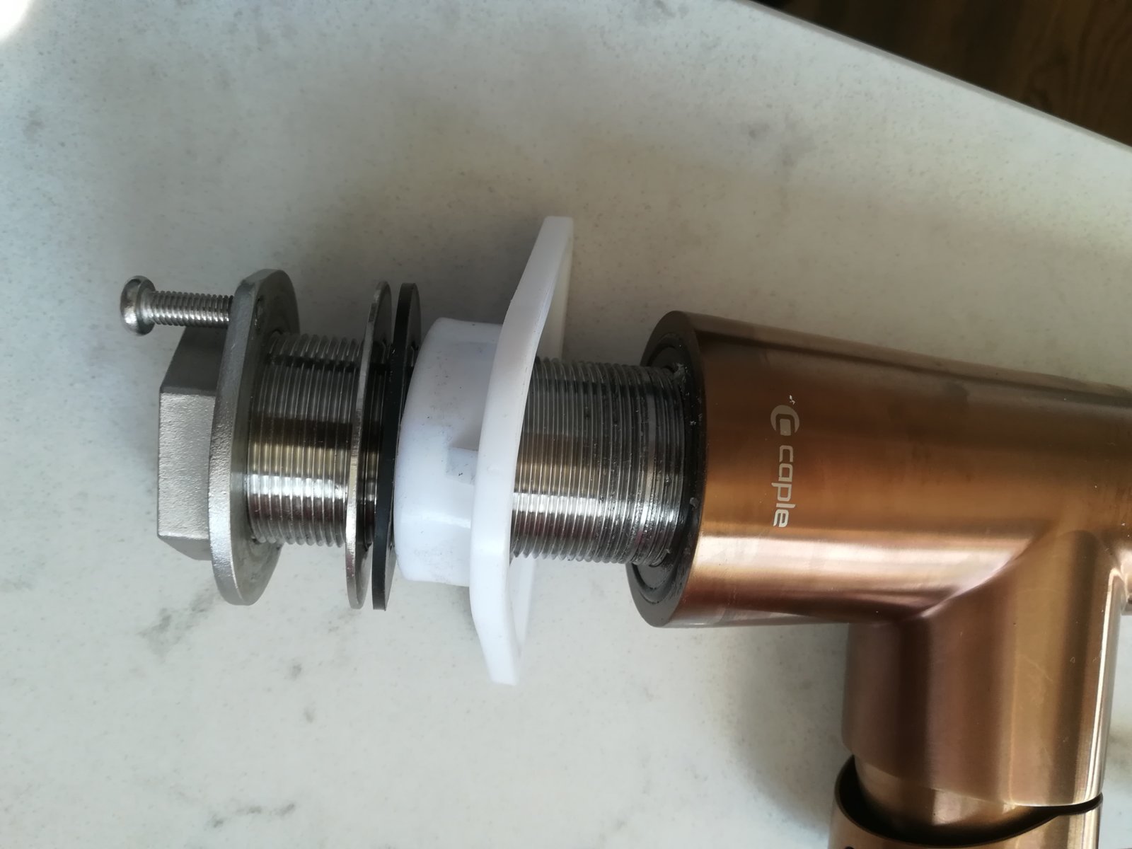

How the shank connects to the tap

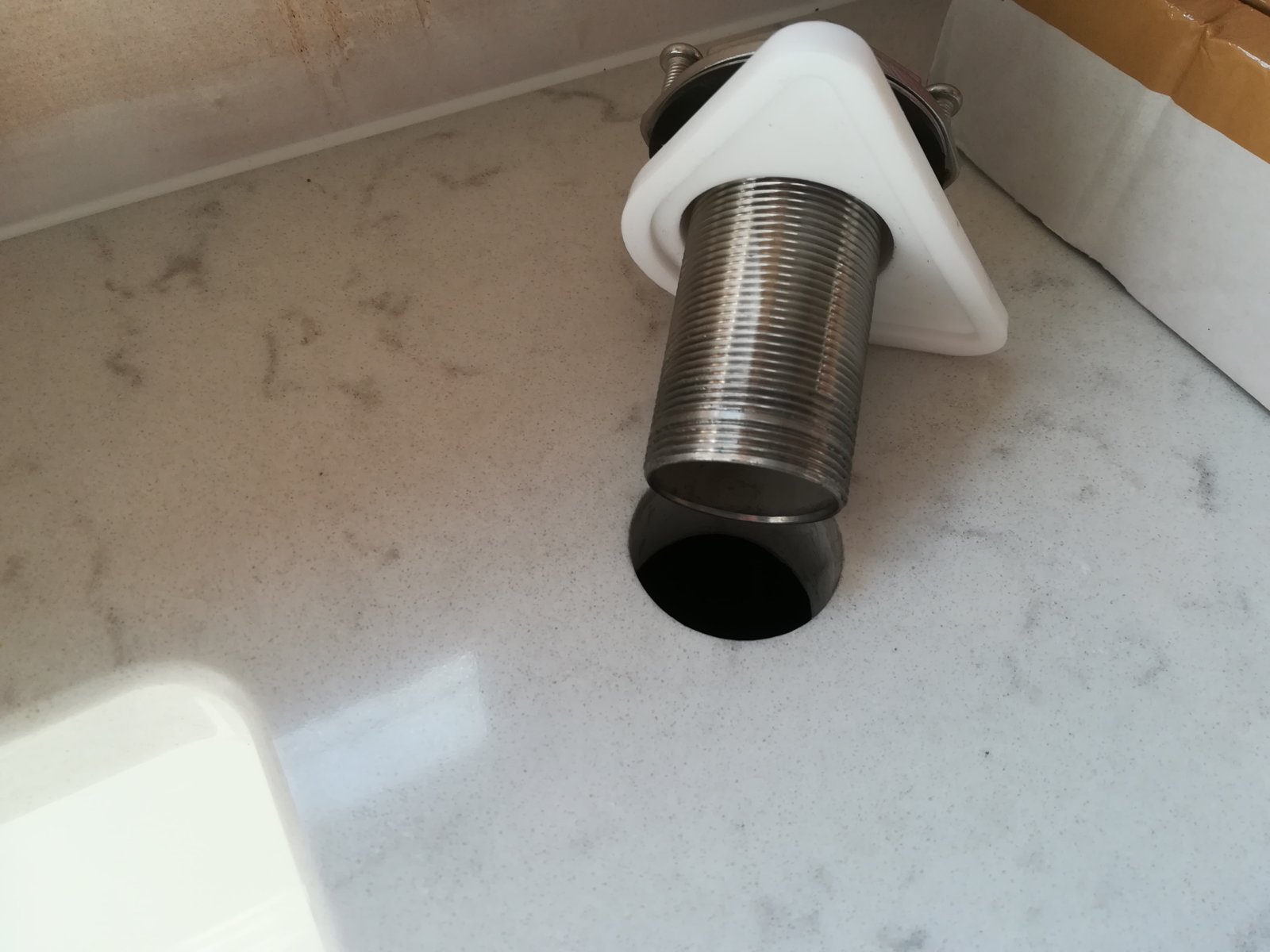

The thickness of the shank compared to the hole
Underneath the worktop, the access area

1. You don't need the white plastic triangle for a quartz work top. They are only really used to stop flexing on thin stainless steel sinks.
2. Thread the flex connectors through the threaded shank of the tap, and screw them into the body of the tap. Finger tight should be enough, but if accessible I like to give them an extra 1/4 turn with a spanner. If not already marked, wrap a piece of red tape round the hot connection.
3. Screw the top of the threaded shank into the base of the tap, remove the back nut with two screws in it together with the rubber and steel washers in your picture. Slacken the screws from the back nut flange but leave them in with 1 or 2 threads showing on the worktop side.
4. Make sure the O ring is fitted in the groove in the base of the tap.
5. Fit the tap in from above. Fit the rubber washer under the work top, then the steel washer, then screw on the back nut. If you have a suitable box spanner, tighten the back nut but don't force it. Otherwise finger tight.
6. Tighten the two screws. This tightening, together with the O ring under the tap body, should prevent the body from turning with the spout.
