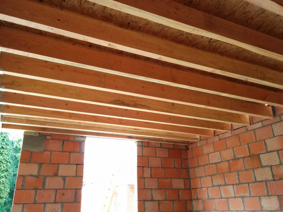

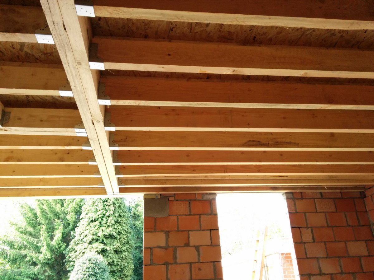

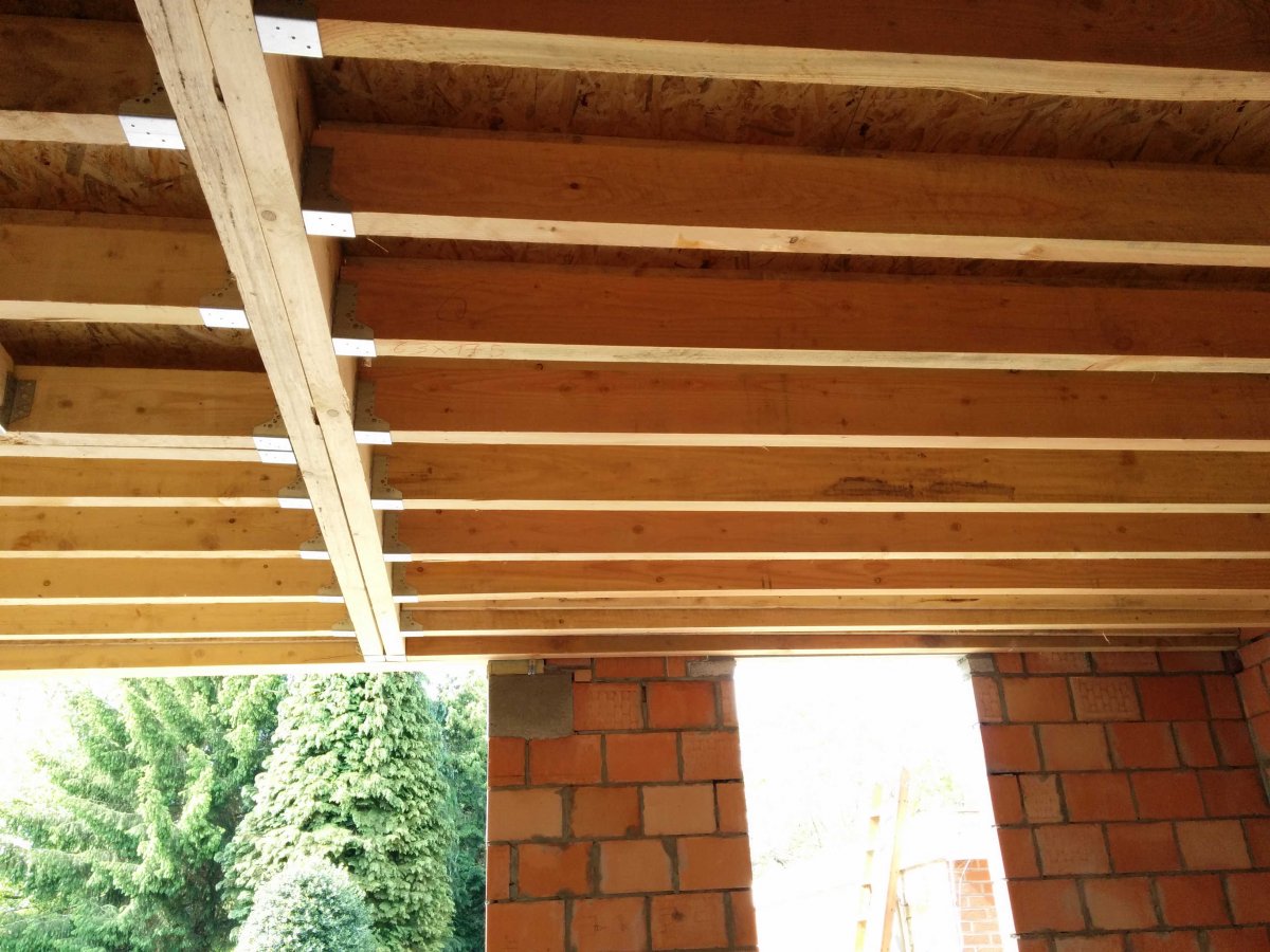

Hi,
I'm a Brit but living abroad (Belgium), and currently having a fairly major refit done on a house. Our Belgian builder has put up a new extension with a timber frame flat roof (about 5m deep by 7m wide). The frame has a large beam running front to back, off-centre, with about 4.5m on on side and about 2.5m on the other. There are spars going at right angles from the walls to this central beam (which is two beams side by side).
There are no noggins at all between the spars, and the builder claims they're not necessary. Also, the firrings (apologies if I get the words wrong) are planks nailed to one side of the spars, going across the roof, rather than wedges going front to back. I guess this would also make the placing of noggins difficult now that the firrings are in.
Is the lack of noggins and the style of firrings normal? Would this be a standard approach to make a flat roof in the UK? We're getting into a bit of a discussion with him about whether the noggins are needed, and would appreciate some disinterested expert opinion...
Thanks,
Tom.
Hi, sorry about forgetting the pics :-/ Voila, les magnifik photos!
Any comment appreciated, esp. from a noggin expert.
Looking at the photos I think I got the division of widths wrong - the vertical steel pole is in the middle of the span at 3.5m, so the wooden beam in the middle isn't far off that.
Also, there will be a roof terrace on top of the half where there isn't the light well - i.e. on top of the half with the longer spars to the middle beam.
Merci,
Tom.

My experience is that you normally don't put noggins into a roof unless there is the need to have extra rigidity and to support extra weight (such as you'd have with a roof top patio). In any case sheet material such as plywood or OSB fixed through the top of the firrings into the spars should add a degree of rigidity. Using a doubled-up trimmer to carry the rafters may be a way to reduce the cross section of the rafters due to the reduction in span. Can't say I like the idea of "firrings" done that way - I'd be suspicious that the roof may sag in places over time. The way to have avoided that would have been to orientate the spars at 90 degrees to their present orientation - but doing that would put a lot more loading onto the RSJ (which would have to be much larger as a consequence and may also have required extra depth/strength of masonry in the support piers). I think that you may have a compromise forced by the position and size of that RSJ. Any idea what the S/E said about this? Overall the carpentry work looks neat, but unless I'm mistaken the builder hasn't filled all the holes in the truss hangers with nails - it's pretty much the norm that ALL the holes need to be nailed with twist nails and that standard applies in The USA as well as the UK (and was also becoming the norm 30 years back when I had a house in the Netherlands)
