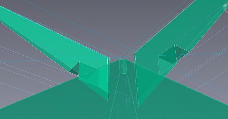

masona and ^woody^ have been very helpful in getting the roof to this point; its a very tricky one because the stone base is already built and the span of the gable over the porch is slightly different to that of the main house, so the two planes of the roof don't quite meet up.
The image below (looking from the end of the valley to the apex) shows what I mean:
However, I think I have the configuration of the rafters as good as it can get without knowing the specifics of the glazing so thats what im thinking about now.

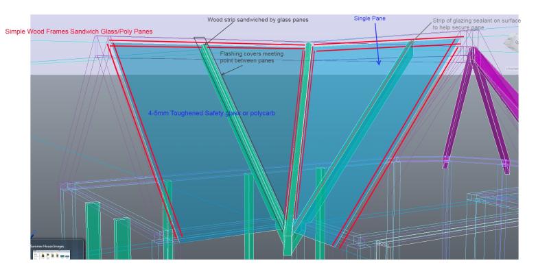

Instead I was thinking about installing the panes in one of two ways shown below:
In both cases the panes are supported between two slim wooden frames and seated with glazing sealant (such as http://www.screwfix.com/prods/57735...nts/No-Nonsense-Glazing-Silicone-White-310ml)
On the right there is a single sheet supported by a lower rafter while on the left there are two panes. Where they meet a thin strip of wood sandwiches them and join is covered by flashing.
(Or alternatively use something like this: http://www.greenhousewarehouse.com/...lazingbar-timber-supported-glazing-bars.html) The important thing is that the join is as 'flush' as possible because I don't want to create a pool where the common meets the valley.
All comments on the glazing and the roof are appreciated as nothing is finalised and i've not done a roof before; am I close to the mark with this design?
Thanks!
I think I've read it right, you can buy a galley glazing bar or roof glazing bar kit made to measure which yours is known as P shaped roof, do a search on P shaped roof glazing bar for more info

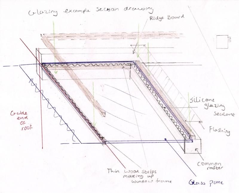

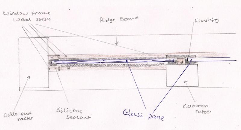

I've attached some hand drawn diagrams, I hope these are clearer.
In short what I have planned is to construct a set of thin window frames to sandwich each pane, which will be sealed in place with glazing sealant.
The exception is the intermediate common rafters which for the reasons stated before cannot be the same height as the end rafters, so in their case the glass will sit on top on either side, with each pane and its sealant seperated by a thin wood strip and the join covered by flashing tape (so to remain as flush as possible allowing drainage on the triangular panes flanking the valley rafters).
You may want to rethink the design of glazing to the rafters and covering with tape
There is going to be a lot of movement and temperature variation, so you need to be sure that this design will accomodate that. Also think about how its actually going to be applied - stretching up over glass panels to apply sealant and tape is inherently problamatic
A proper glazing bar fixed to the timber may be better?

There is no actual problem in using timber frame, but you have to be very careful in the actual detailing to ensure that it remains water proof. Your indication of sealing with flashing tape raised a few alarm bells as this is not really a long-term solution.
