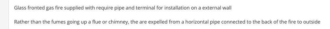

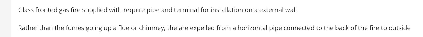

Don’t think you can have that Flavel as it doesn’t mention balanced flue option. Have a look at this or change your search criteria
Looks good but isnt that a hole in the wall balanced flue fire, i thought with them fires you cut a hole in the chimney to fit these but i dont have a chimney
Starting to make no sense now?

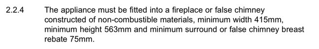

Did you read the description as attached?
Apologies, I must have been looking at the wrong Flavel, as this model is balanced flue and should suit your requirements

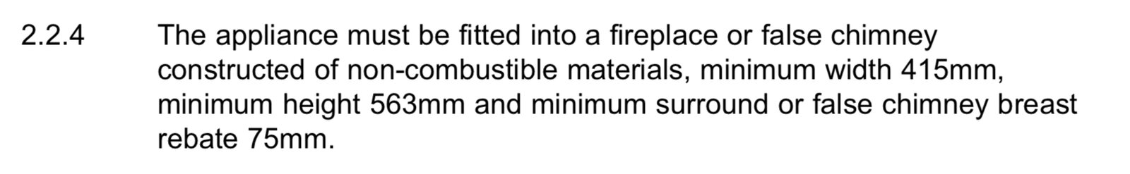

Yes thats what im after. So with the flavel calibre fire would i have to make a false chimney to recess the fire into or can I screw this fire directly to a flat brick wall without making a box around the fire?

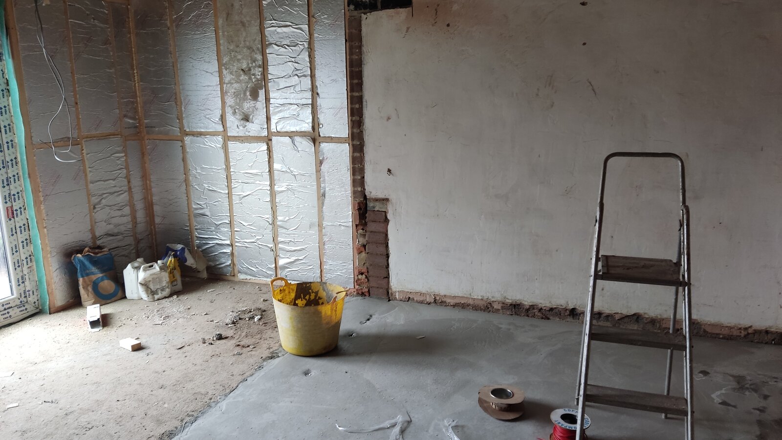

So if i get the flavel calibre inset gas fire will i need to board the timber frame with normal plasterboards before constructing a metal frame chimney or does that have to be cement backer boards? And does the chimney i make have to have cement boards or just normal plasterboards around it? See pics, the fire is going in the middle of the timber frame where the insulation is inside the frame and behind that is a single skin brick wall
Yes, or better phrased "can my gas installer?"
Why not get him involved now at the planning stage where he(she?) can advise on hearth requirements, feasibility of extending existing gas supply, size of builders opening required and suchlike essentials?
