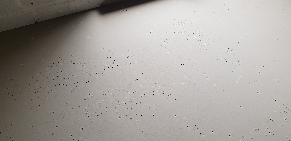

Hi everyone, I'm after some advice on some work I've recently had done in my garage by a local flooring company. Unfortunately I've been left with a large number of holes in my floor due to air bubbles coming through and the fitting company can't understand why ... I'll outline below the steps taken and the products used - if anyone has any ideas as right now I'm stuck between my house builder and the fitter with a holey floor and no one can give me an answer on what to do next.
The house was finished being built in April 2017 which is when we moved in. The screed was first laid on the 12th October this year.
  1. Stopgap 131 was rolled onto the bare concrete floor in the garage as the primer
  2. Stopgap 1200 was then placed on top for the first layer of screed - loads of air bubbles came through so called them back
  3. Another layer of 131 was rolled on top of the laid screed
  4. 1200 placed on top again - bubbles came through again. He rolled the floor with a spiky roller while I was stood there, the bubbles then came back through again showing that air was still being released from something into the mixture
  5. They came back a third time and laid Stopgap 400 on the top. It looked like a mortar type mix for filling cracks and repairing floor. As they laid this down you could audibly hear popping as it was even being forced out of the holes ...
  6. They went ahead and laid another layer of screed on top of this (not sure if they primed a third time or not) and although the floor looks better, there are still loads of holes
My builder has so far simply said that an adequate sealant should have been used as it's a concrete garage floor and that there would be nothing wrong with the original floor. The fitters have now made three visits and used a fair amount of product at mostly their expense by this point but now nothing is happening ... Any thoughts on what could be causing the holes given the points above or what I can say or try next?

Hi Mike
Did they dilute the P131 ? It should be 3-1 on concrete and not neat. You only put it on neat on ceramics , Ashpalt and a epoxy dpm.
Also I’d guess it’s on to soon as well as you should be waiting 28 days before screeding over the slab.
If the screed is dusty we do 2 coats of primer. Are you putt8mg a floor covering over the compound.

Used 1200 loads of times and have the odd pin holes now any then for reasons of -
Not primed enough.
Weather warm when mixing.
Concrete warm when screeding it.
Not spiked properly.
Screed out of date.
To be honest I water mix in a garage would of been better like Fball 300 , Ardex K39 or Uzin NC150.

So they did 3 coats of primer at 4-1 then the 1st coat of 1200pro ?
Hi Daz,

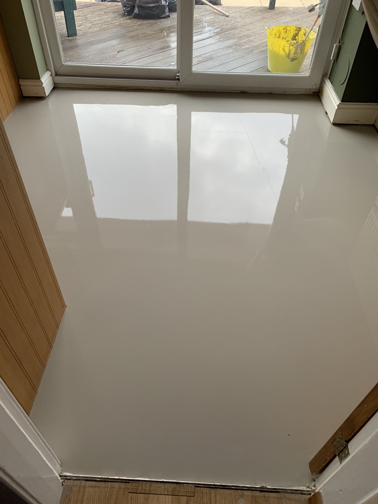

Thanks for your replies. To clarify, they did 1 coat of P131 primer at 4-1 followed by a coat of 1200 Pro in visit one. All told they were at my property for around 1hr including setting up and cleaning down. Loads of holes, I've attached some images to show you what I mean by "loads".
They then returned for visit 2 and put P131 at 4-1 down on the first layer of latex from the first visit, then another layer of 1200 on top of that. Again, loads of air bubbles came through and the fitter said he didn't know why it was happening. He got on to the FBall support team and they supplied him with some replacement bags of screed and I've been told they suggested that he use the 400.
They came back a few days later with the 400, put a layer of this down over the previous layer of 1200. I'm not sure if they used another layer of 131 at this point or whether they just went straight in with the 1200 again, but that's now what I'm left with, a final layer of the 1200 at the top, still full of holes.
I'm not in the trade and really know nothing about floor screeds apart from what I've been told by the fitter and what I've manged to Google since this all began, so I can't really comment on what they should have used ... they have otherwise told me that they have used this method of 131 and 1200 many times with no issue - certainly not to the extent we've seen on my garage floor.
Thanks,
Mike
Edit - These photos are taken after the first visit, though there are fewer holes towards the middle, it still looks much the same around the edges of the room.
Yeah seen it a lot mike. I’d take a guess at the concrete was very porous and maybe needed 2 of 3 coats of primer. We did one a while ago and sand and cement screed was dusty and loose.
Primed 8-1 , then a 4-1 coat then 2-1 then screed. When primer is t soaking right in then it’s ready.
Stopgap 400 is a rapid repair screed for big holes.
Stopgap 500 is for small holes, he should of rubbed floor down then used it
Have you had something like this happen to you as an installer? In that case what happened? Is the installer responsible for appropriate pre inspection and therefore makes good from their own pocket, or if it goes really wrong like this, does the customer receive a revised quote after the fact? I'll mention the Stopgap 500 when talking to the manufacturer and see if they can see whether they suggested the 400 or not ...
It has yes then we do the micro screed if needed. This is on floors we are putting a covering on so not a issue.
On a garage floor we would use a water mix screed not a latex as it’s always a better finish. If they told you it would be a mirror finish they are in the wrong.
