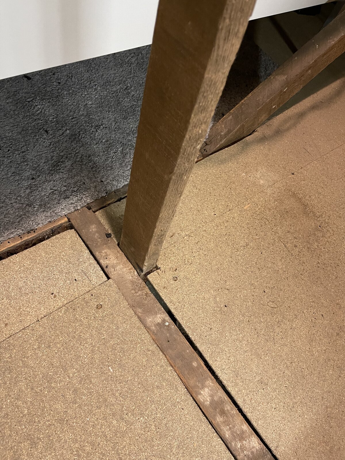

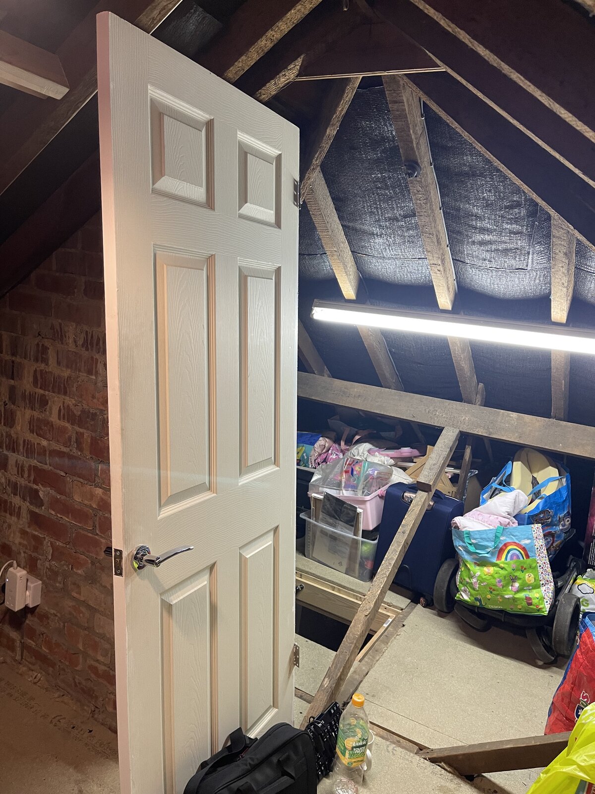

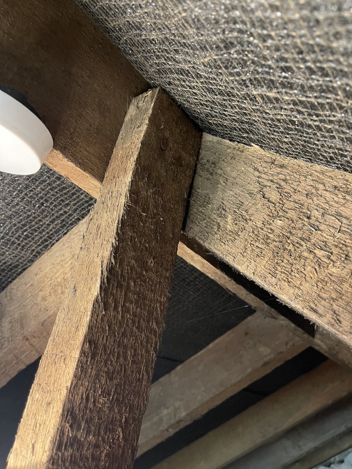

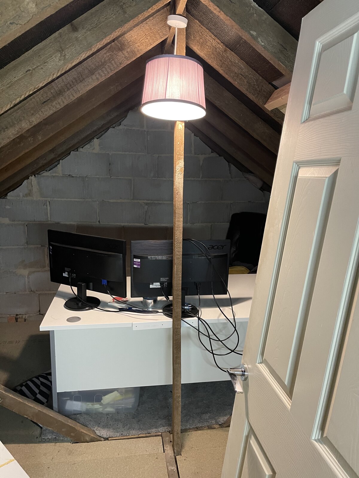

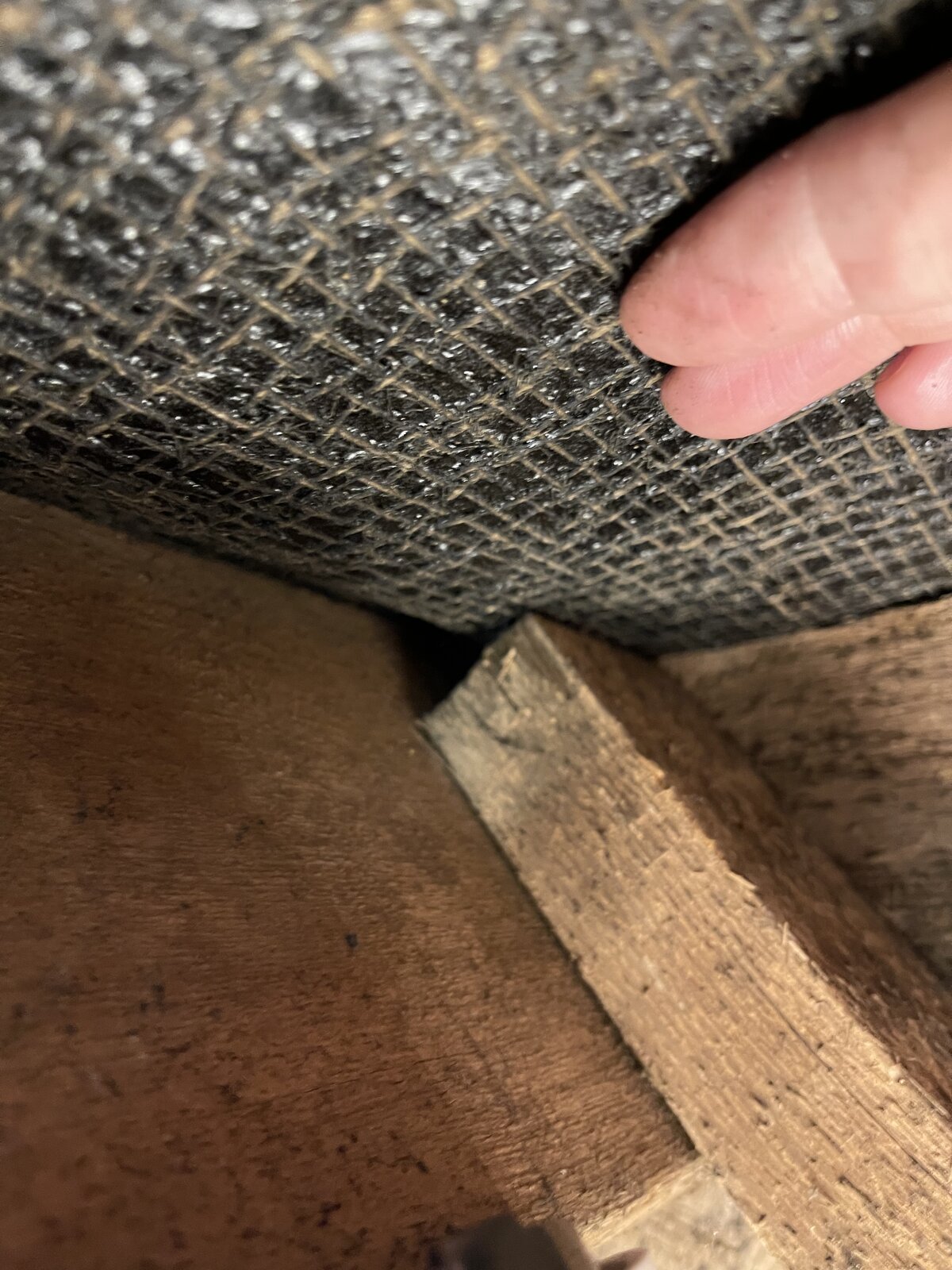

Hi all,
I work in my loft and over a year ago had some flooring put in, some beams removed, window put in etc, all is fine.
There was one beam I never removed, a vertical one, that’s only nailed in by 2 small nails. It’s quite annoying as my desk is near it and wondered if I could remove the loose beam?
I’ve attached photos to explain what I mean. If it can’t be removed, any advice on what could be done to replace it elsewhere to provide same support structure (not convinced it’s supporting beam). Last year a vertical beam opposite it got removed (in the last picture where the spare door is currently near).
Any advice much appreciated!
JB

Isn't that a strut or prop? I think they're used to transfer some of the load from the roof to the supporting walls below. I'm only a DIY'er though and only know bits having watched asked questions about roof structures when we were having our ridge tiles replaced.
My guess (if there's no supporting wall below) is that it's a king post, effectively a hanger holding up the two horizontal struts and should not be removed, and neither should the other one have been.
I don't think it's substantial enough to be a king post. They are usually larger and incorporated into a much larger truss, whereas this just sits somewhere near (but not quite in line with) the purlin props.
It could just be a temporary prop for the ridge board that was never removed after the roof was constructed.
I don't think it's doing anything but needs a review of the structure by an engineer to be sure.
It's to pick up ceiling binder don't just remove as you're probably over loaded up there as it is

It's hard to say, but if you consider some principles, it will help in the decision process. That appears to be a normal cut rafter roof, not one of any king/queen post/truss design - so those angled timbers are just raking struts for the purlins, not part of any truss.
In this case there would normally be a wall below those struts and the vertical timber, and as such that timber is not part of support for the ridge.
The closeness to the struts, and offset from any wall would mean that its not a hanger.
However it does appear to be connected to a binder, so could be a hanger holding that up.
So if there is a wall there, you could potentially remove the timber and fit a normal steel joist hanger in its place to support the binder.
If there is no wall there, the timber is a hanger and should only be removed if loads are assessed by a suitable person.
