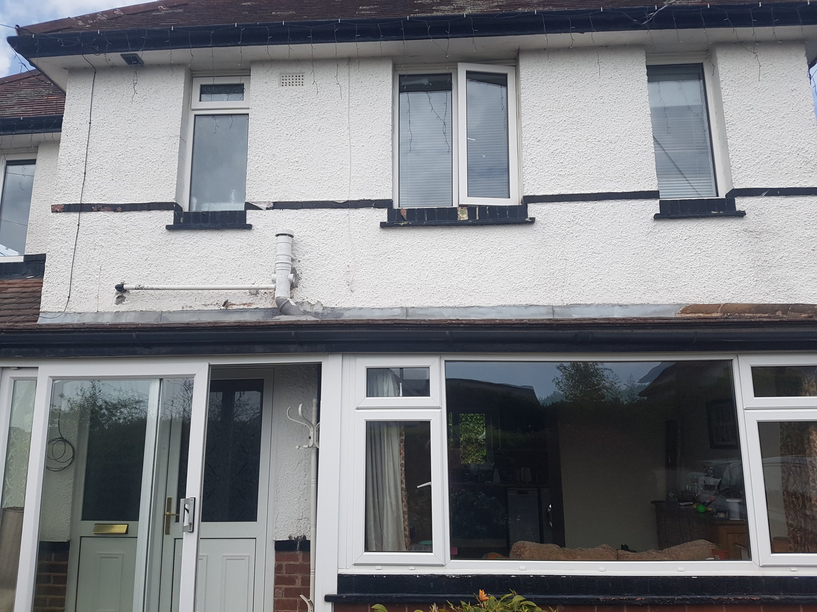

Hello
I need my roofs above my ground level bay windows to be replaced (see photos). I have got quotes and the materials costs seem quite high (but maybe not?). One of the pitches of the roof needs raising - the other-one doesn't. One of the quotes is quite detailed, naming products and and weights of breathable underlay, the other isn't so detailed.
The quotes state 'supply and fit 9mm White PVCu Hollow Soffit (TnG)' for side cheeks.
I have looked up what I think is the product at Toolstation and it says not recommended for cladding exterior of house. My house is on the top of a hill and its quite scary at times as the wind just howls around the building. If a window is slightly ajar, the force of the wind flings it wide open.
Should a different product be used?
Both roofers were supposedly quoting me for using clay tiles, but there quotes show concrete tiles which I assume are cheaper?
Does the roofer have to work with a carpenter? Or are there roofers who do the carpentry as well and then they just use either another roofer or a labourer?
Many thanks for advice/opinions please.

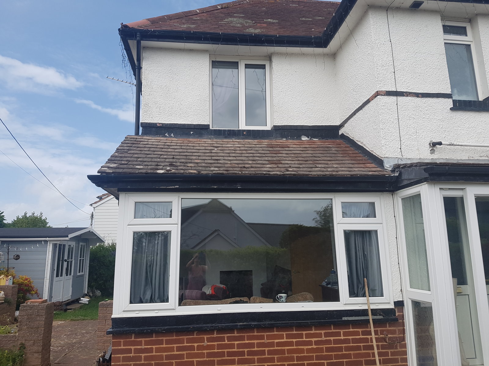

i see two rooves. One which I guess you are cladding the end. id use proper ship lap or similar. hollow might be a bit weak
concrete tiles are cheaper , you currently have concrete plain tiles over the left bay .
The longer roof from the door to the right hand side of the house is too flat roof pitch for plain tiles
it is leaking now but possibly onto the underlay.
Yes, two roofs.
The longer roof, the pitch has to be raised.
I had to look up shiplap and I see it is wood. That is what's there at the moment. I wanted to try and make it maintenance free. Is there another product that can be used instead of the Hollow PVCu or the Shiplap?

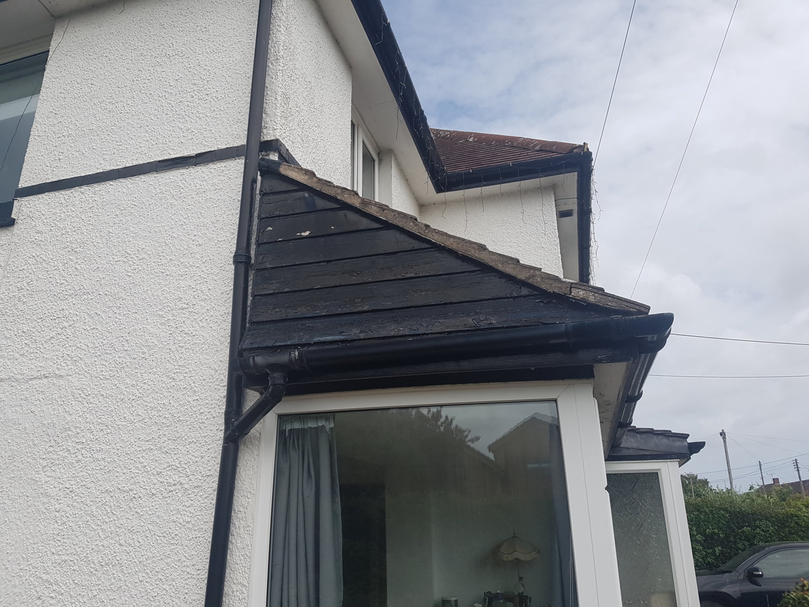

Well you can stop them right there.
Soffits are horizontal, and hollow board should not be used vertically due to the exposed nailing. So a hollow soffit board is for horizontal soffits that don't get wet.
But cowboys tend to use them because its cheaper than proper shiplap, and its quicker to do. And only idiots actually specify it on a quote.
