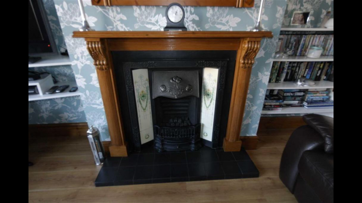

Hi all,
I am looking to paint a previously varnished fireplace surround -
Its removed from the wall so quite easy to work on. I think I need to sand it, prime it, sand it, undercoat it, sand it paint it, sand it, paint it.
Is that correct? I am unsure on what type of primer and which sandpaper to use at each stage? Any pointers appreciated. Cheers.
If you sand it well then any oil-based primer will do. But if you want to be absolutely bullet proof use Zinsser BIN (meths based, it dries within seconds so don't overwork it). Then undercoat until you have a nice opaque colour. Lightly sand, vacuum, then a couple of top coats.

Thanks Gerry, so can I used Zinsser BIN as a primer, then use it again as an undercoat? Should I sand inbetween this? Cheers
No, use a proper undercoat (might as well use water based, it's less effort). You can use a combined primer+undercoat too of course, on top of the BIN. You don't need to sand between every coat, unless you see any obvious nibs or drips you want to get rid of. Basically if it looks like it needs sanding, then you sand it. I just go over lightly with a foam block at each stage, but I only look carefully before the top coats. Always vacuum after any sanding. It is good practice to key the surface between top coats, although not essential when using the same paint type.

Or use Zinsser Bullseye 123 which is water based, so easier to wash out etc but will still adhere to the sanded varnish just as well.
