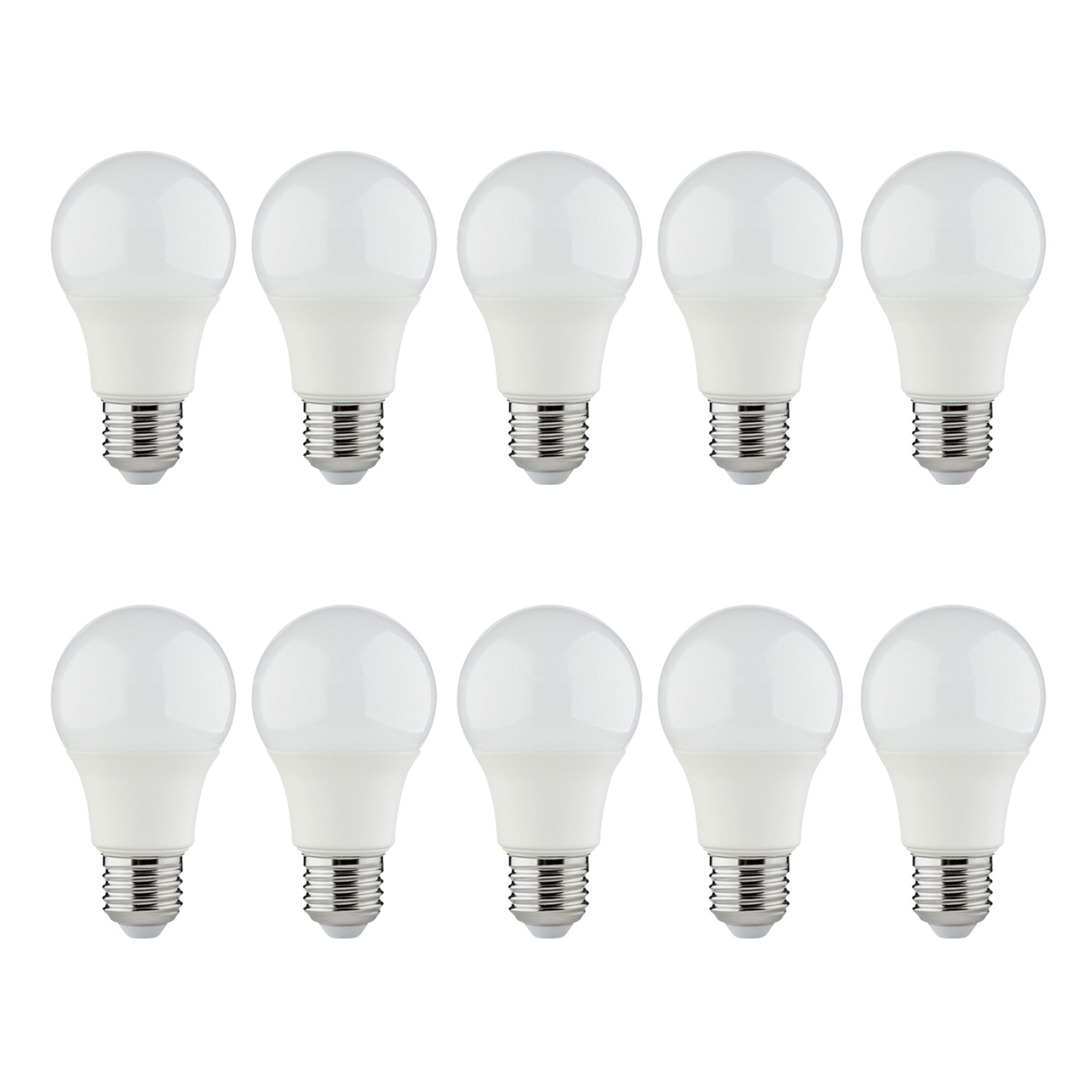

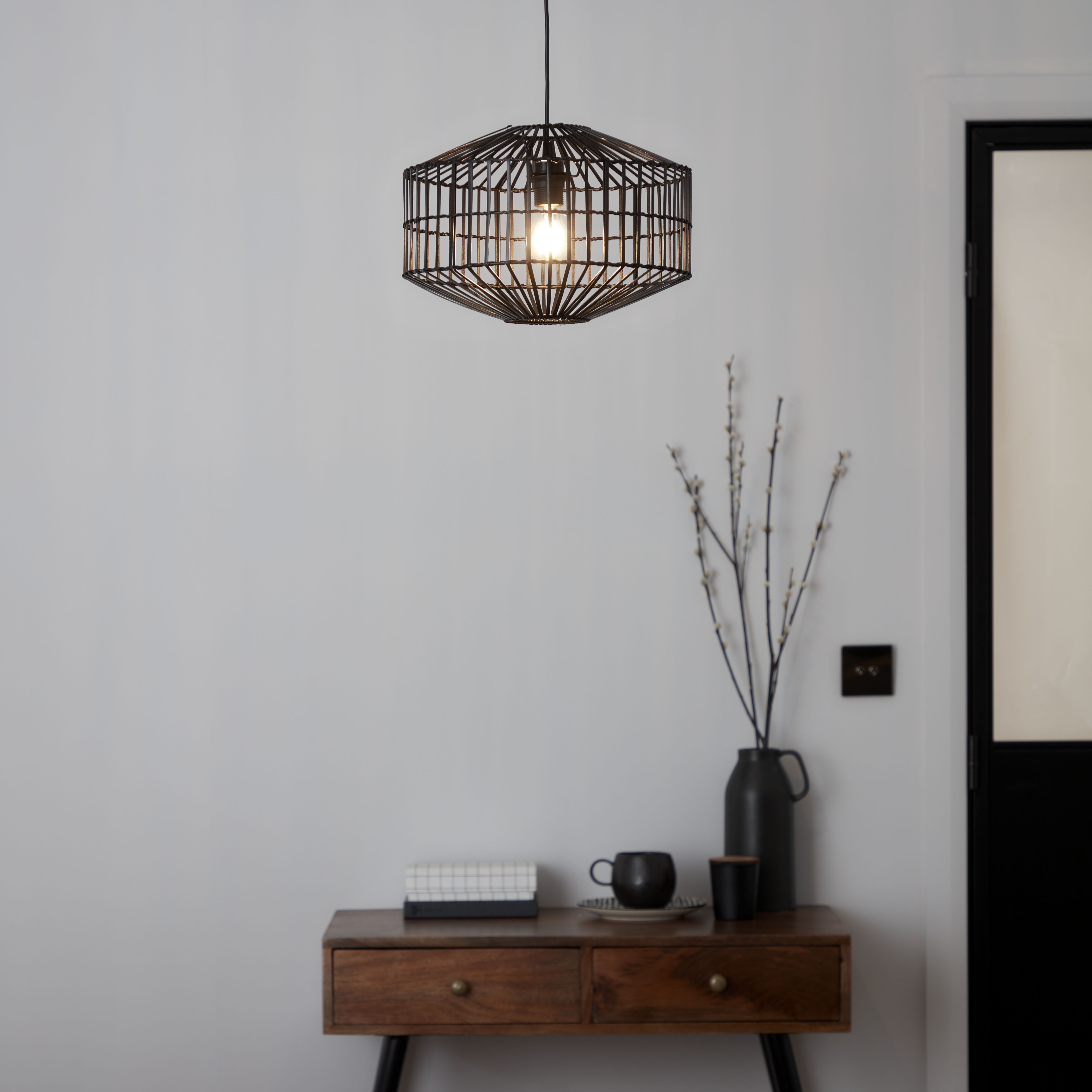

so we are going to replace the light fitting with these below
Maximum bulb wattage42W
and was going to use these bulb which are 7.2W but equivalent to 60W
Am I correct that I can use these? as I was told by B&Q that these might be too strong as being 60W
They will be fine, the lamps you are wanting to fit are 7.2W, ignore the equivelent to 60W bit, thats irrelevant and just means it has a similar light output to a 60W tungston lamp
Yes, you can use them, they are not 60W.
Just that the brightness is (said to be) equivalent to a 60W filament.
